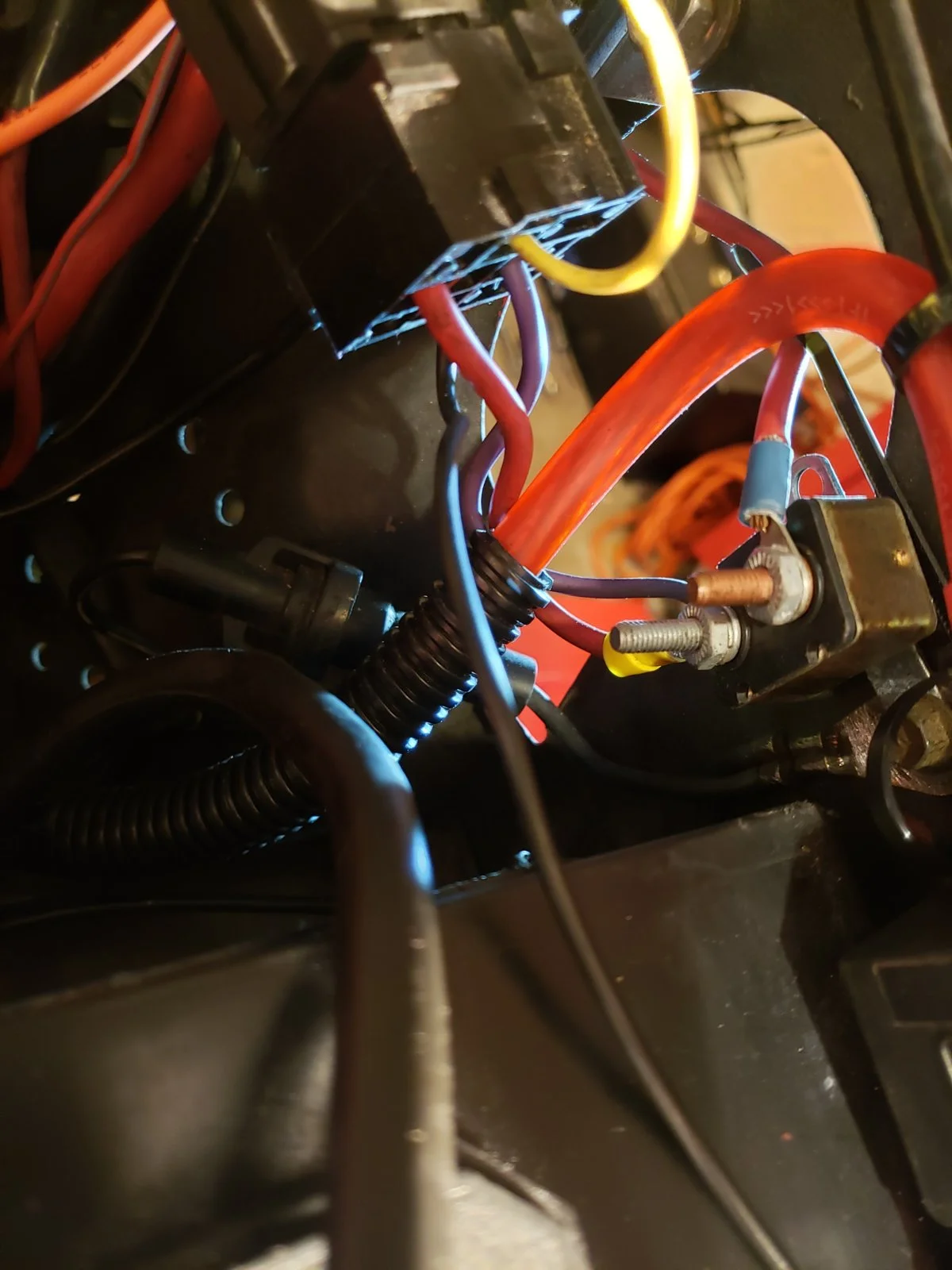

One other question. While taking the old relay (or what I thought was a relay) out. I just noticed where the red wire connects to. What is that for and can I get rid of that red wire? The red wire with the yellow connector.

Also have a question for you. I am removing what I thought was a relay for the previous fans I took out. And I noticed this red wire attached to another piece. What is the red wire for and what is it connected to, will I have to hook it up again?
Red wire with the yellow connector
You can get the solder sleeves on eBay direct from China.
See p12 (or pdf p.16)
It's a circuit breaker shown in the upper left.
Don't know what the red wire is for, you'll have to find what it feeds.
View: https://drive.google.com/open?id=1on5czXKmpETzxUggWTGtoUuVkJT2UUxN
That's a pretty handy instruction manual, now I just have to figure out how to read it lol. So the thing with the red wire and yellow connector and the red wire and blue connector hooked up to it is a circuit breaker? Can I remove it all?
The red wire was attached to the box that was attached to the fender. It had all the wires for the old fans on it. Dont know if I'm describing it well

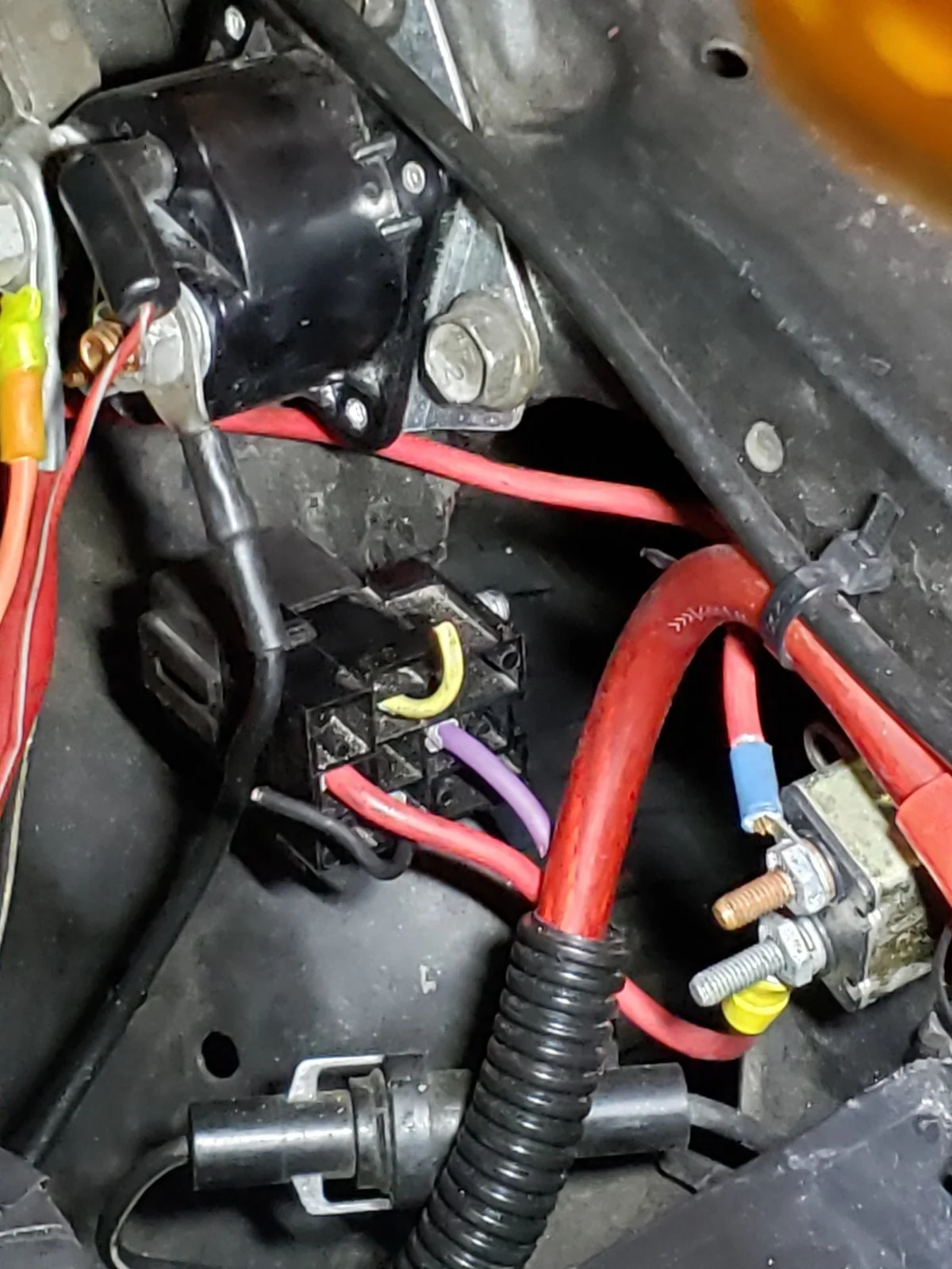

Blown88GT said:
If you can't read the schematic drawing, don't remove anything.
That's good advice lol
Heres a better pic if it helps. The black, purple, and yellow wire were all from the old electric fans I took out so I snipped them. The only one remaining is the red.
Remove the bottom red wire from post on the little relay

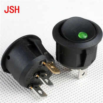

Run power to your toggle switch. Line out of toggle switch will go to trigger side of the relay(s). This will allow your automatic controller to do its thing and allow you to override and trigger manually.
I used this type of switch...
Third wire is for a ground to light when power engaged. Nice part of wiring this way is light on toggle will come on when auto controller triggers fans and you will know they have been turned on,
