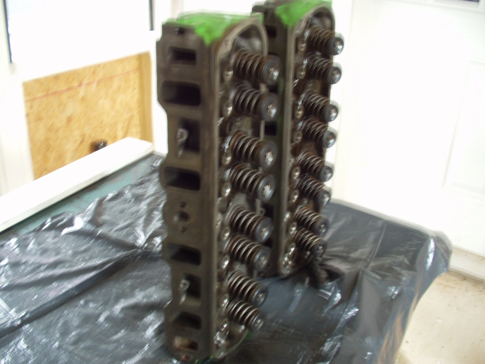

I have a freshly built 306 in my 1994 cobra with an E303 cam/non-catted exhaust..thats about it. I recently bought a vortech V1 T trim supercharger with a meth injection kit for a really good price(couldnt pass it up). Now my question.. I have a set of world sr heads sitting around with 1.6rr's, and 50lbs injectors with maf meter. If I put this on my 306 (it is girtled)..do you think it would run well? I personally think Id be better off with a 351W platform, but this 306 is almost straight out of the machine shop, and would be loosing $$ if I sold it outright. I currently have GT40's on it now and ran a 13.2 1/4 mile..thoughts?

With gt40 heads and boost you will make plenty of power depending on what kind of boost you wanna run. I would either sell the heads or just hold on to them for another project.. Sr's would prob be better on a 351 or bigger. Might be a little big for a 306.. Bigger isn't always better. With your combo without boost you should be at least 250 at the wheels.
Thanks for the reply! I figured they where too big for a 306, but I didnt know how boost would effect it. Ive heard that if you run boost, you can run a bigger head than a n/a motor. Dont know how true that statement really is..
To an extent, that's true. Forced induction makes up for what might otherwise be a "lazy" port by cramming the air through the engine. The velocity that might have been otherwise lost because of the larger port area, would be artificially regained by forcing the air through the heads.
That being said, you can't presurize the port all of the time and it'll still be as doggy as it would, were it N/A when you're running around under vaccuum.
Personally, I'd stick with the GT40's if this is going to remain predominantly a street driven car.
