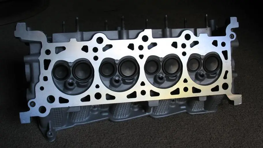

im saying ported heads make the swap worth it instead of just a gain of 15cfm, and ported heads cause less of a compression increase because they have material taken out of them - so less compression is better suited for perhaps future supercharging or turbo charging
are you saying ported heads change compression ratio? hmm. the only thing thats changing is the flow of the air. there will be less pressure in exhaust port due to more room for the air out but it wont change compression. the only time any kind of porting will change compression is if they ported out the combustion chamber
Lets get this straight. Swapping NPI heads for PI heads will increase your compression ratio. But if you port and polish the heads in the combustion chamber, your compression will be lowered but not by a large amount, less material means more volume. Most places that P&P modular heads will smooth out the combustion chamber, widen the chamber to enhance scavenging since the valve is close to the edge, and eliminate the "tongue" that is a chunk of metal. This increases flow(if done right) but decreases compression.
Right, there is a ledge that's for low rpm emissions - everyone takes it out for porting. that itself will low the compression slightly, and if you dont believe me that P&P'ing takes material out look at this: http://youtube.com/watch?v=l1SWFZ1rteI
This shows the tock ledges im talking about, mine are still on:
