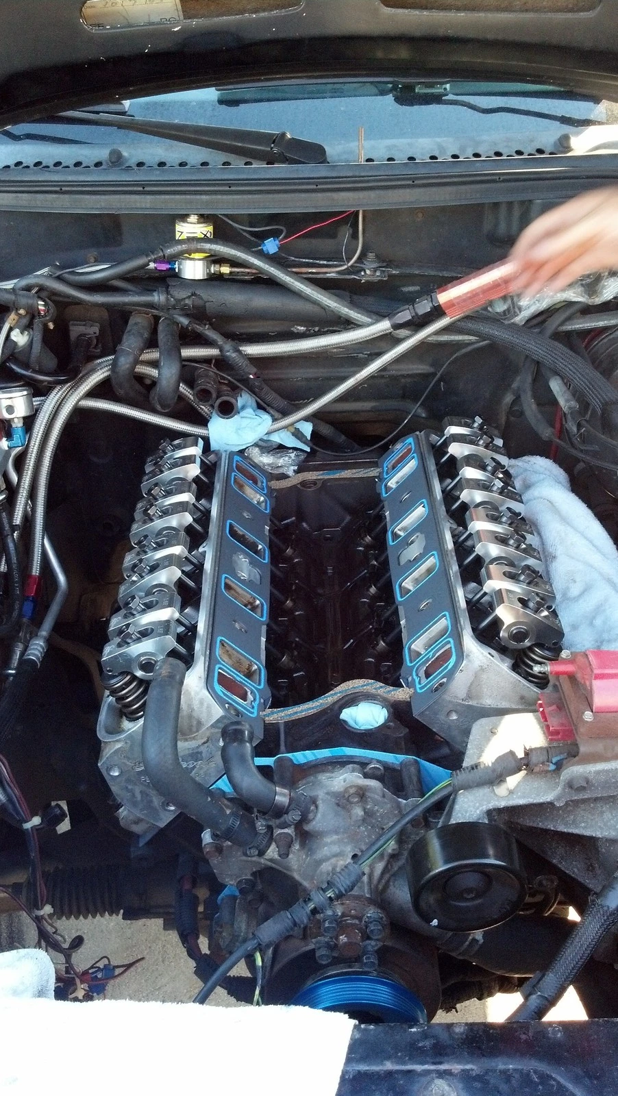

Yes buy them! Those are exactly like mine. I paid $800 for them slightly used last summer. You did better than me because the RR's and pushrods are included. I had to buy them afterwards.
I love them! Mated up to the TF stage 1 cam, Holley Systemax intake and 12psi, it can be quite a handful.;)
