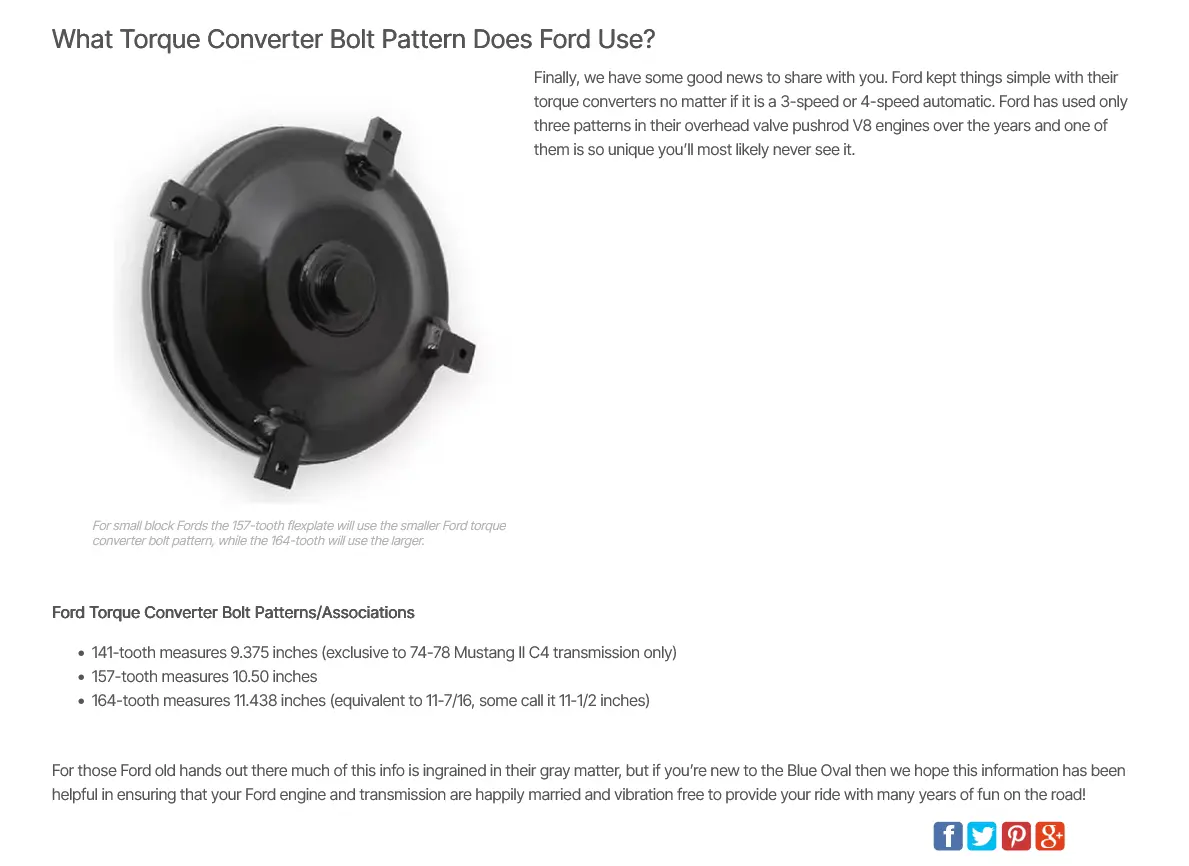

I remember seeing somewhere about the bolt circle being smaller than a standard Ford. It seems like standard Ford converters have a 10-1/2 bolt cirlce whereas the II has a 9-7/8 or 9-3/4 bolt circle. I'll have to search again and see if I can find it - seems like it would be pretty useful, especially right now.

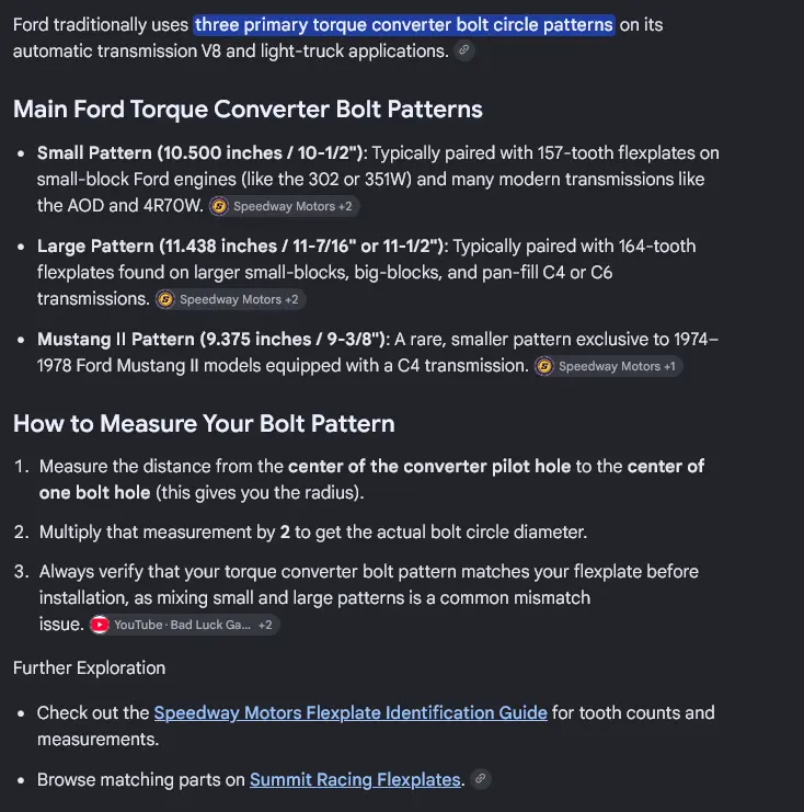

That didn't take as long as I thought, Google AI steps up and answers "Ford torque converter bolt pattern" with:
Won't fit bolt circle is 10.5 Amazon says it will but here are the specs
Torque Converter for Ford C4 [10 in. Dia. & 2600-2900 RPM Stall Speed]​
Fits Ford C4 Transmissions, 10 in. Diameter, 26-Spline Input, 10.500 in. Bolt Circle, 1.375 in. Crank Pilot
