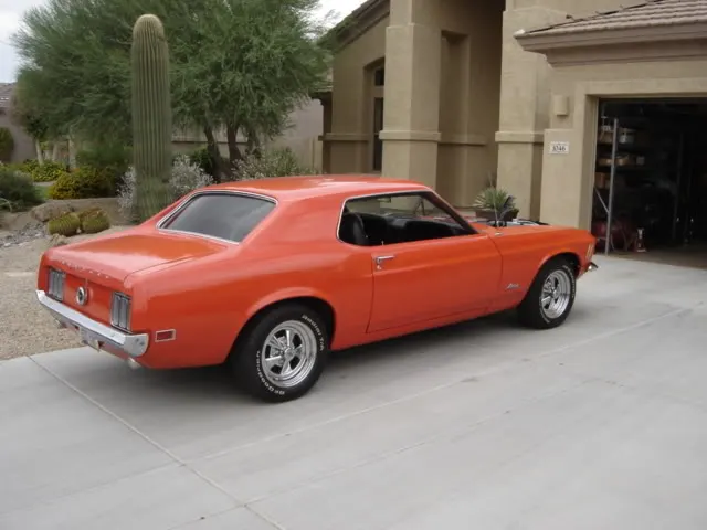

new stance!
stock upper and lower arms
moog OEM springs cut 1.5 coils
15x7" all around

fellas!!!! my new rims just got in!!!!
14x6 all around AM racing Torque thrust D's
205/60R14 front and 225/60R14 rears i think their herc. tires
a little more meaty than my current set up :) pics by mid to late next week.

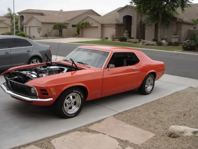

(2) Questions::::
One, did you have to roll your front fenders??
and Two, is that you in the second photo?
1. I rolled the fenders a little, could use some more. It doesn't rub at all unless I hit a pretty big bump. There's no rubbing on normal cornering on a decent road. Makes me nervous to try to roll them too much *after* the paint job.
2. Nope, that's my sister :D Her husband (my brother in law) has a 58 Chevy that he is restoring, so they like to go to the car shows with my wife and I and my parents (rsev216, 65 vert).
Lol, didn't think that was you but she sure looks possesive of that car!
You can use a heat gun to avoid damaging the paint when you finish rolling the fenders. Did you use one of those rolling tools or a bat?
Yeah, that Mustang has been in the family since '93 and has been driven by most of my sisters at one time or another. I bought it from my Dad in about '98 or so and started restoring it in 2002.
Unfortunately, I used a technique that the body shop guy told me to do and I didn't do it right and put a few ripples in the passenger side fender lip :bang:
He said to slowly pinch it with vice grips after protecting the paint with several layers of tape. I think I pinched too much at a time.
Thanks for the heat gun tip, if I get a rolling tool and save up my courage I might give it another try...but it doesn't rub enough for me to worry about it and when it does rub it doesn't hurt the tire at all, doesn't even leave a mark.

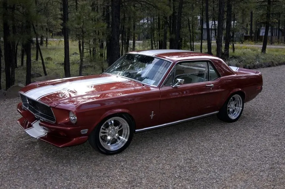

is it possible to fit 17x10.5 inch wheels in the back of a 67-68 fastback with no rubbing issues? Deep dish with a Cobra IRS.
my 67 turbo coupe with 17x7's and 17x11's in rear with stock wheel wells but with shorter rear end
