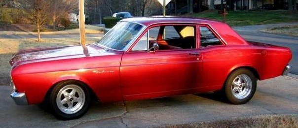

It isn't a mustang but its close enough
Stock wore-out 6 cylinder springs in the front with comp. engineering adjustables.
5-leafs in the back.
15x3.5 with 165r15s
15x8 with 4.5BS and 275/60/15s
