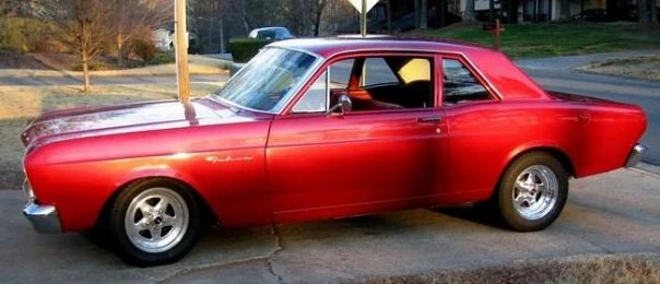

What year is that Falcon? I gotta get me one those!

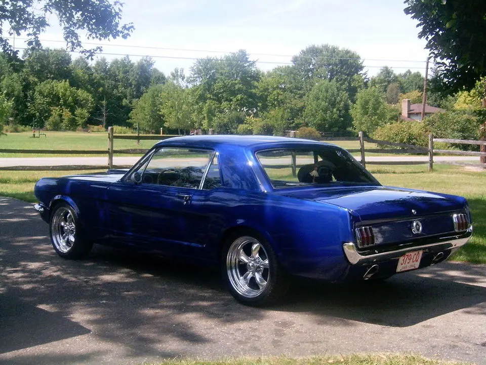

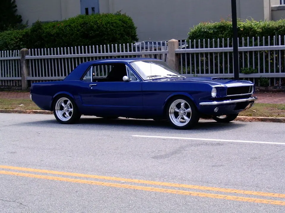

grab-a-trac 620's 1" lowered in front, eaton gt comp leaf springs, 17x7 torq-thrust with 215 45 17 front, 225's rear...

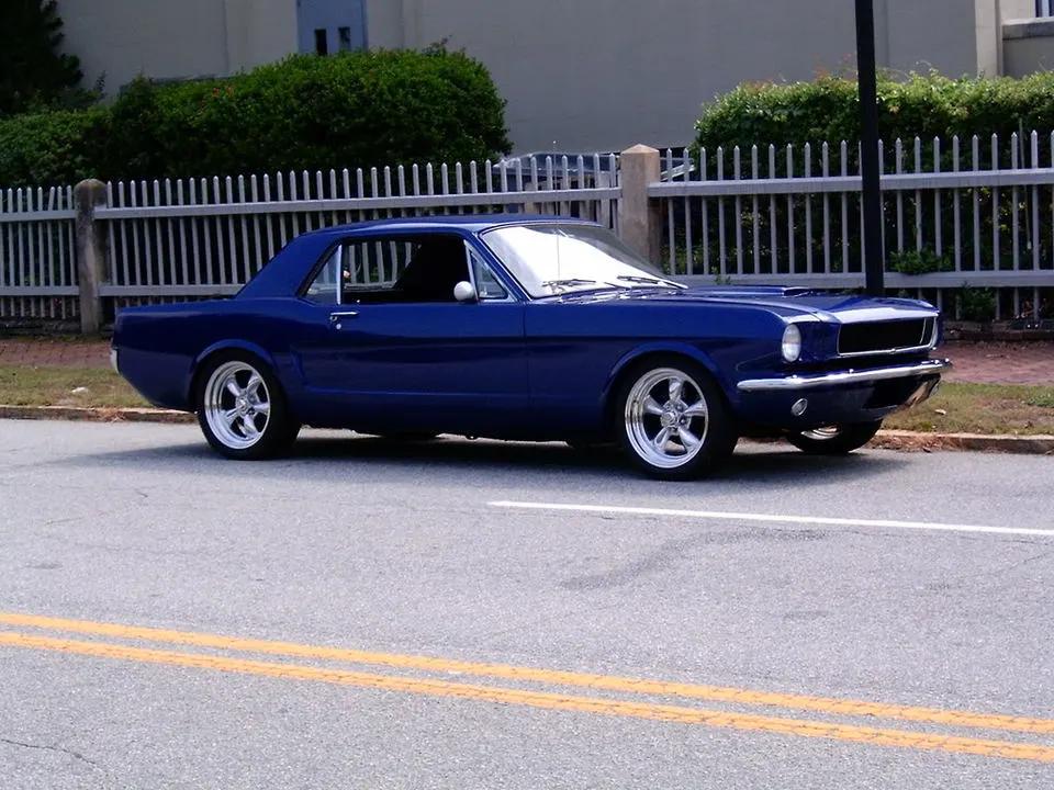

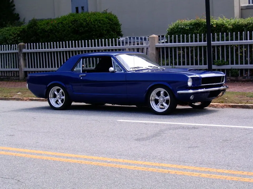

the rear fenders are rolled, and the front, i cut the lip off, and stiitch welded a piece of 1/8 inch rod around the lip to stiffen it up.it seems the body on my car sits about 1/2 inch further to the left than it should:shrug: i had good clearance on the left side, but the right was way tight. i did both sides, anyway. btw, those are 225's on the rear, and 215's in front. i dont think anything bigger would have fit with the backspacing ive got (4.5) not on the right side, anyway...

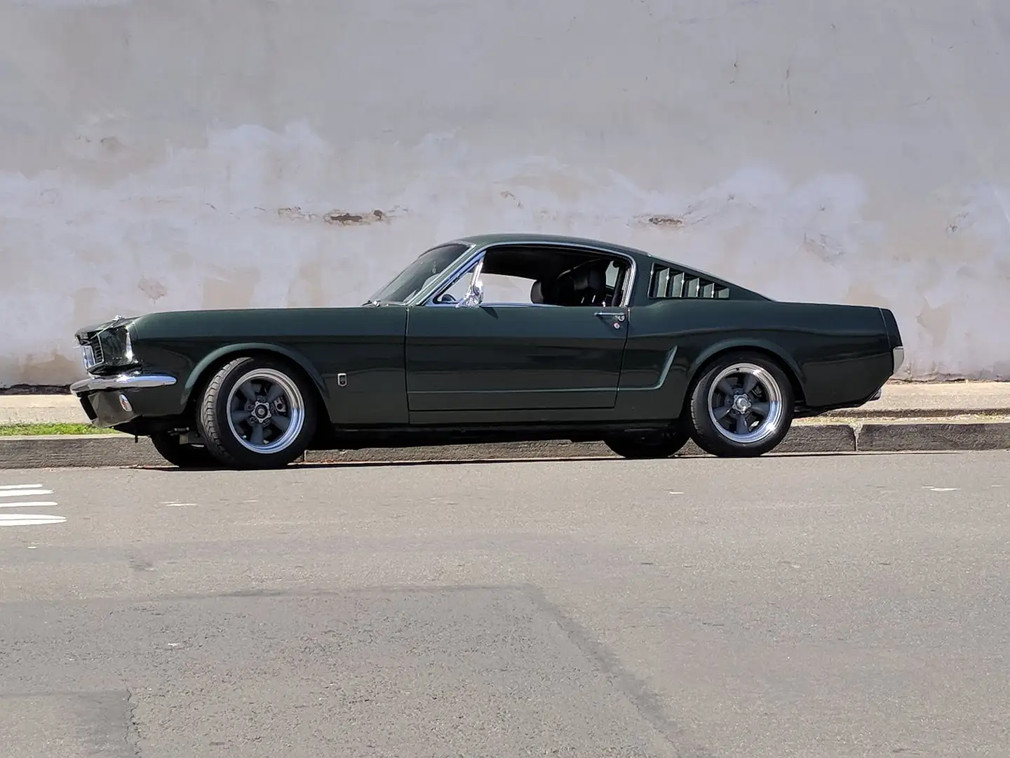

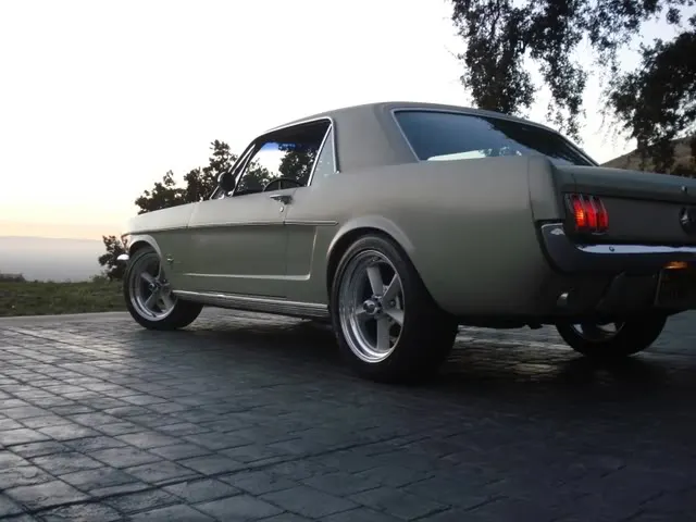

Old thread, I know... but I just put 2003 Bullitts on (with 1" adapter/spacers) and wanted to add to the thread. This is with 1" drop 480lb-in front springs and 1" drop 200 lb-in composite leaf springs in rear. Tires are 225/45R17 in front, 235/45R17 in rear with no rubbing. Alignment is at +3* caster, -0.5* camber and 1/8" toe:
