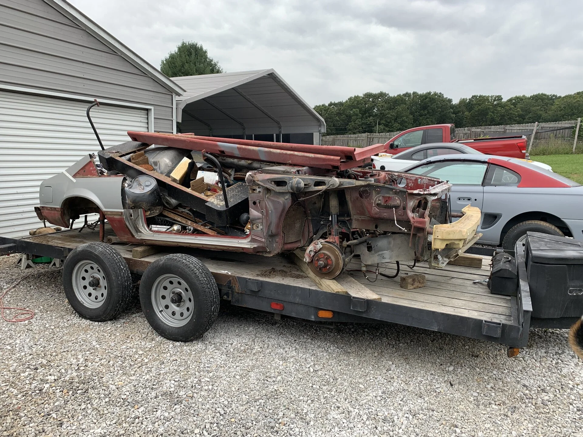

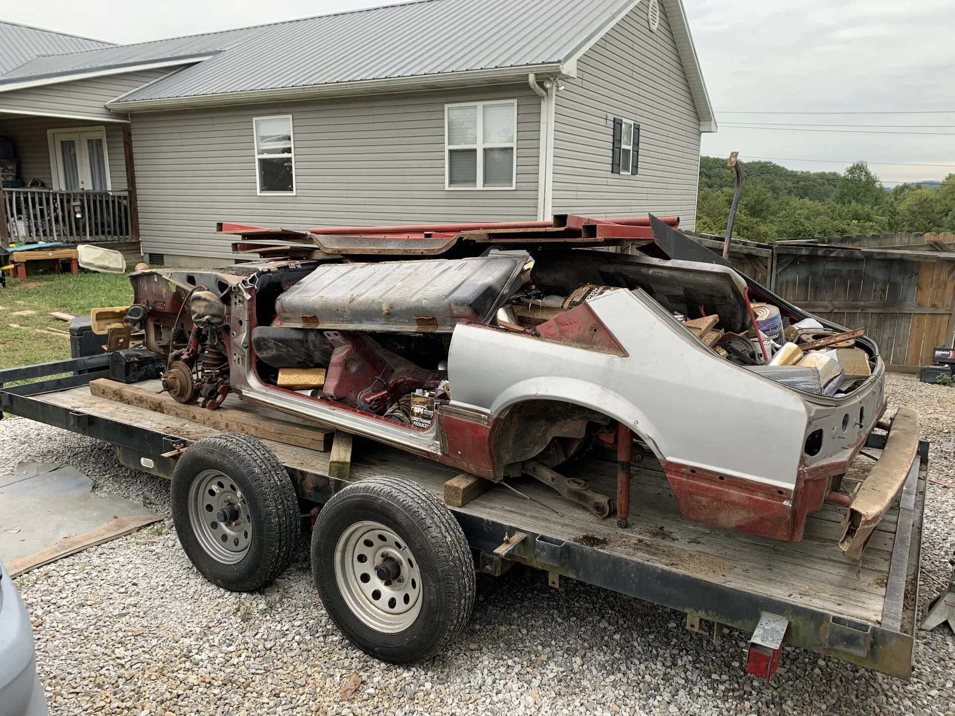

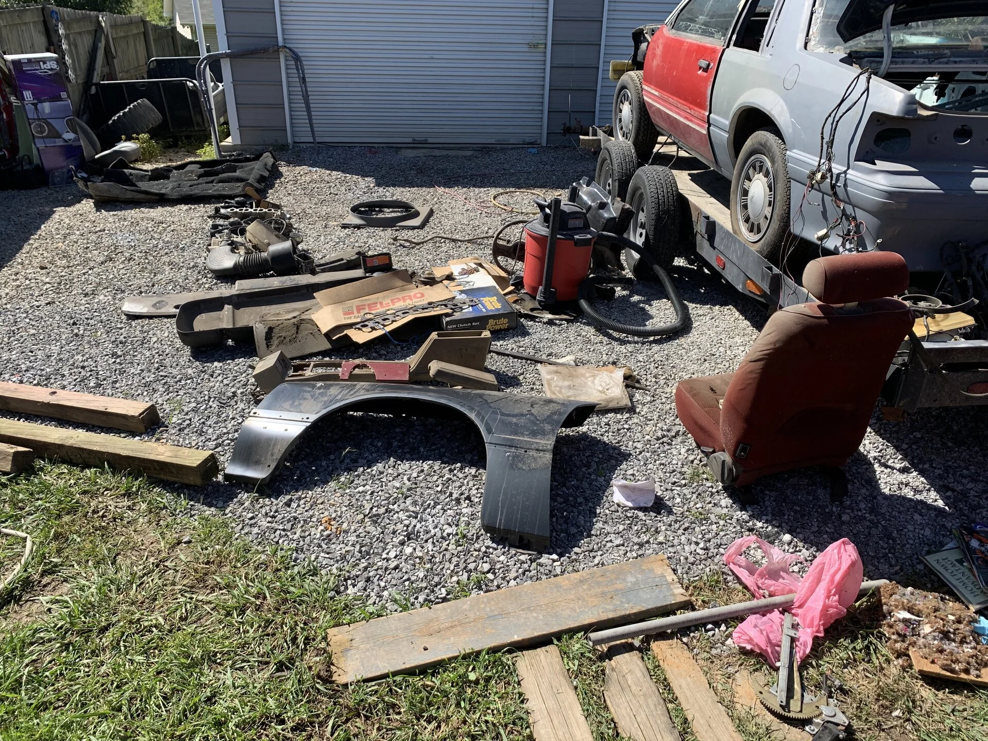

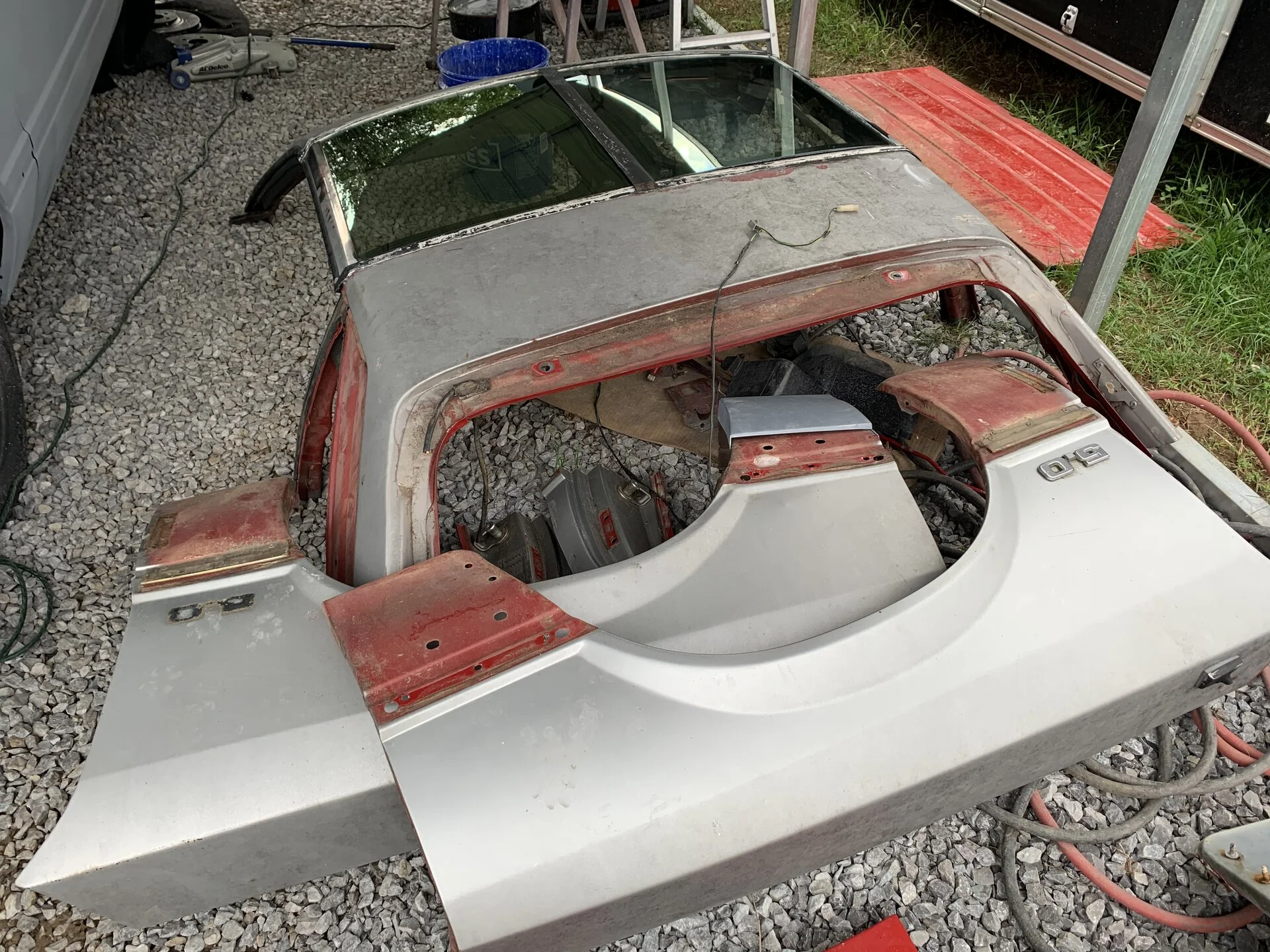

Got the donor car stripped on down and hailed

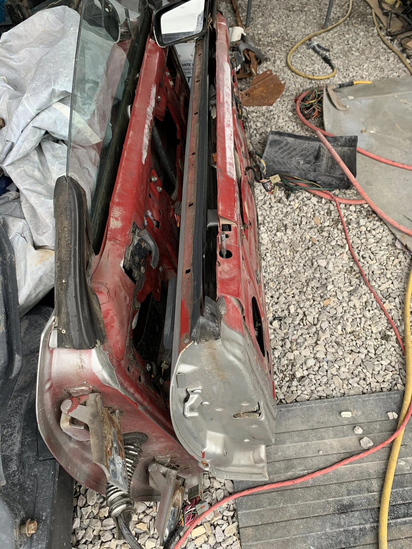

Off for scrap. Below is the bulk of what we were after. When doing a t-top conversion you will need the t-top frame, t-top glass, moldings and door glass. I also cut some other t-top specific items out so I have a pattern to duplicate. Just for FYI....regular doors can be used and just cut the frame but I want a 100% correct conversion. So..

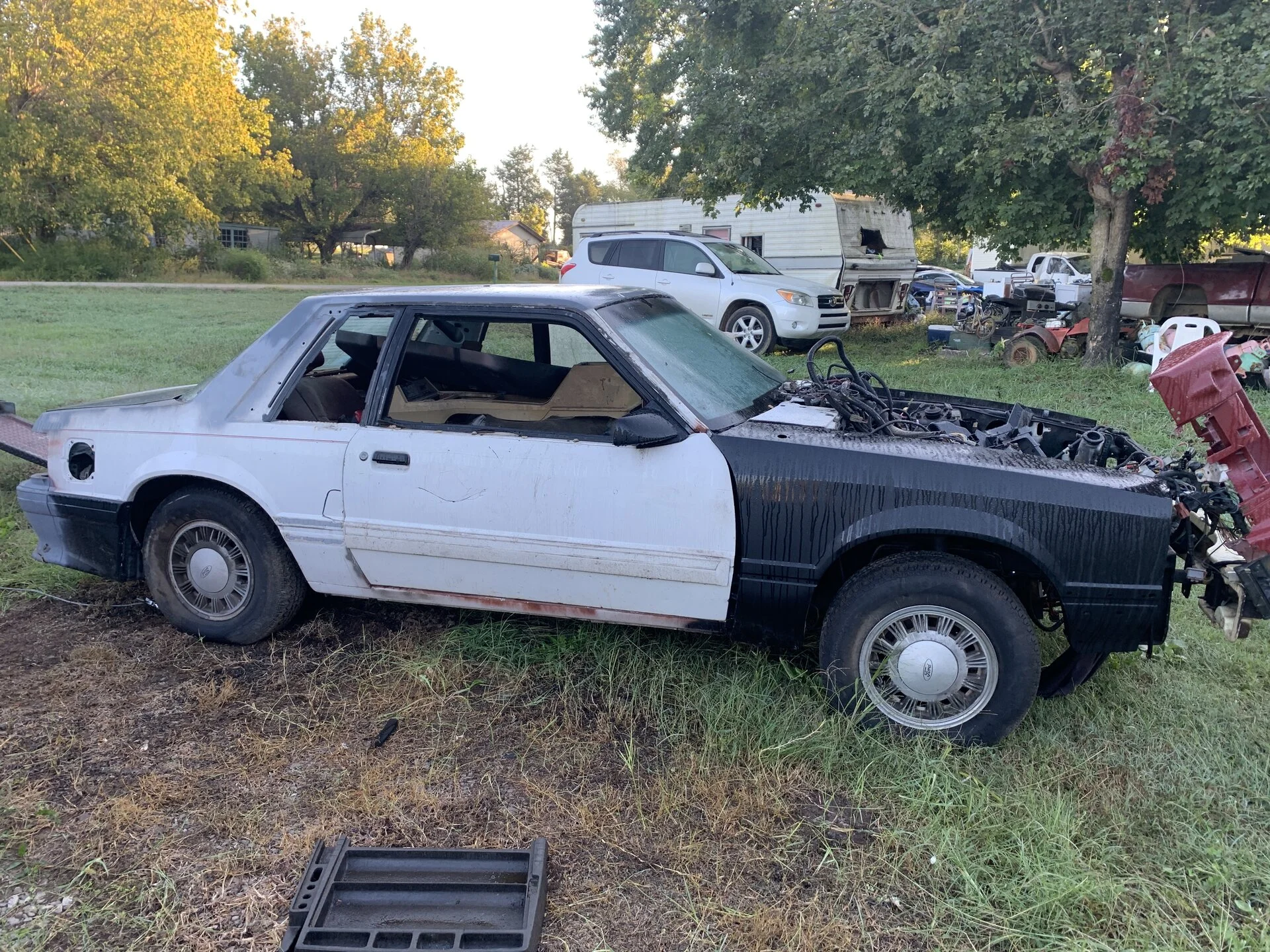

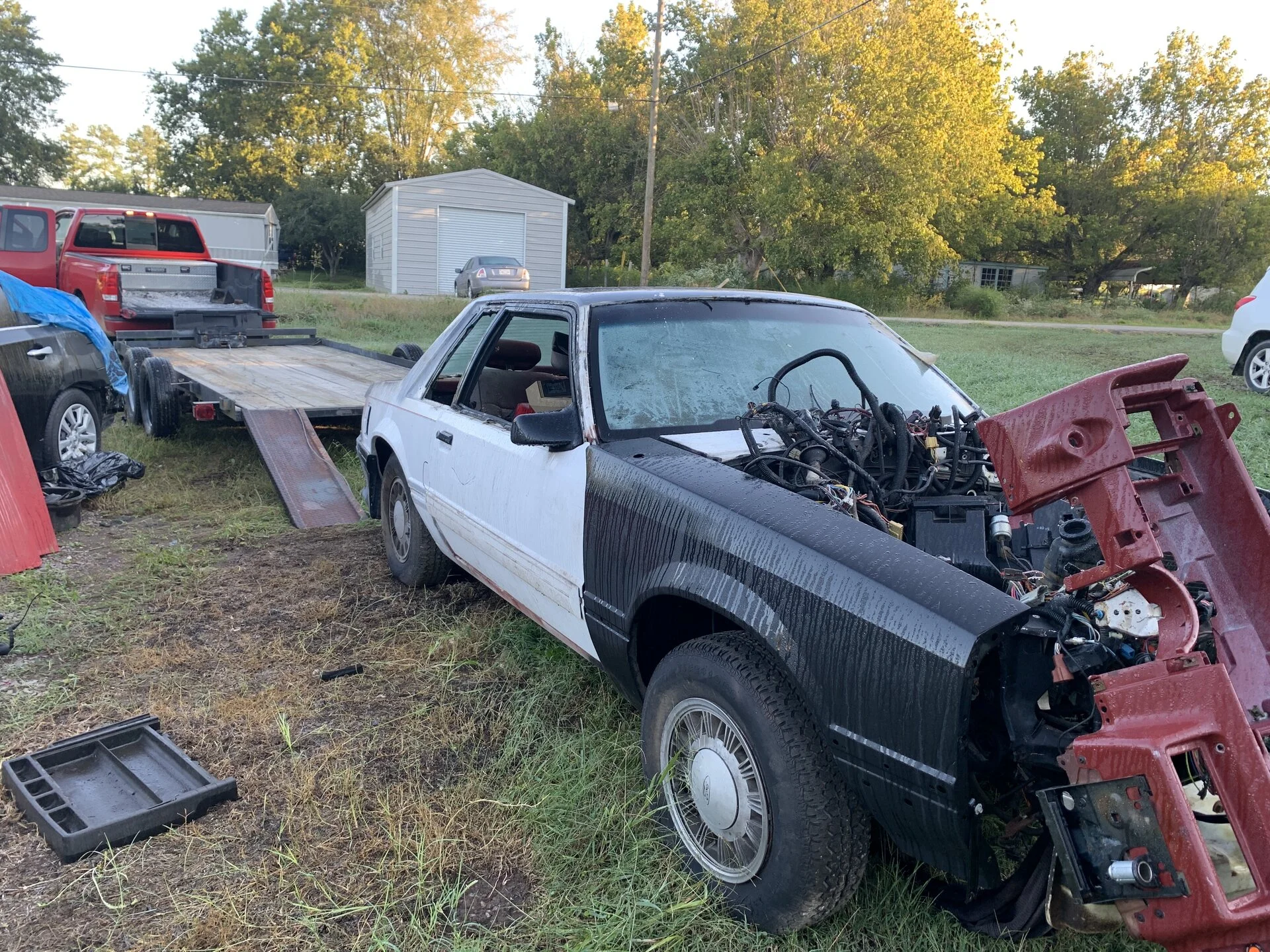

Well, we have our car for this build in hand. So this is Now an 86 Notch build thread now
Kevin we just had two of these 86 t-tops come up for sale cheap.
I was contemplating buying it just because it came with extra glass but the top frame and glass won’t work on 87 up correct?

Okay I figured. The local ole man here did this car, but used an 87 donor for the frame and top glass. He cut the coupe top and Drilled, sealed, and riveted the frame in.
He cut the doors and changed out the door glass with I believe it was convertible.

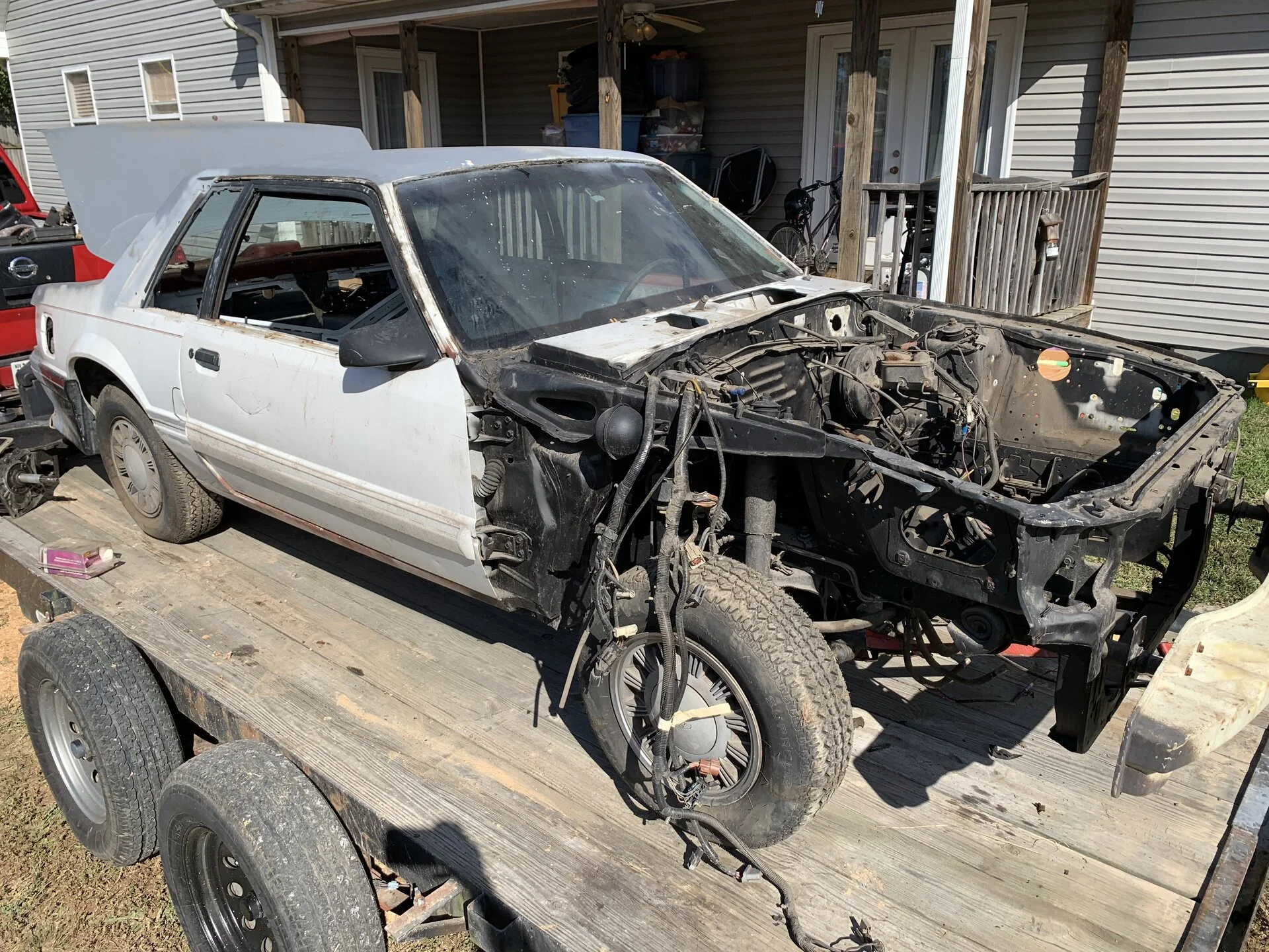

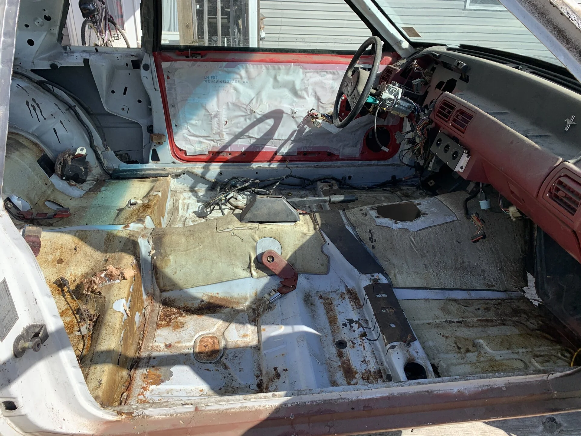

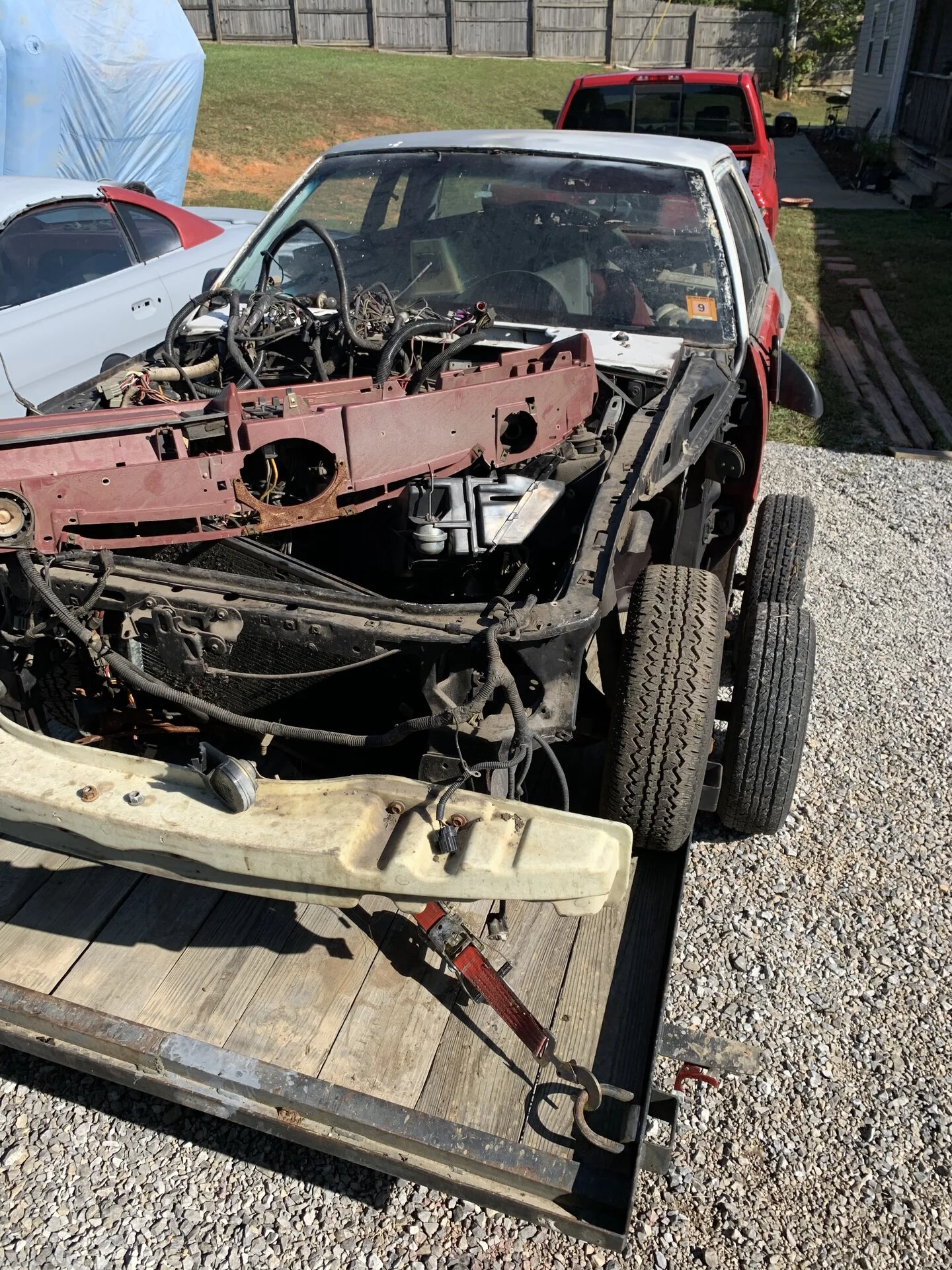

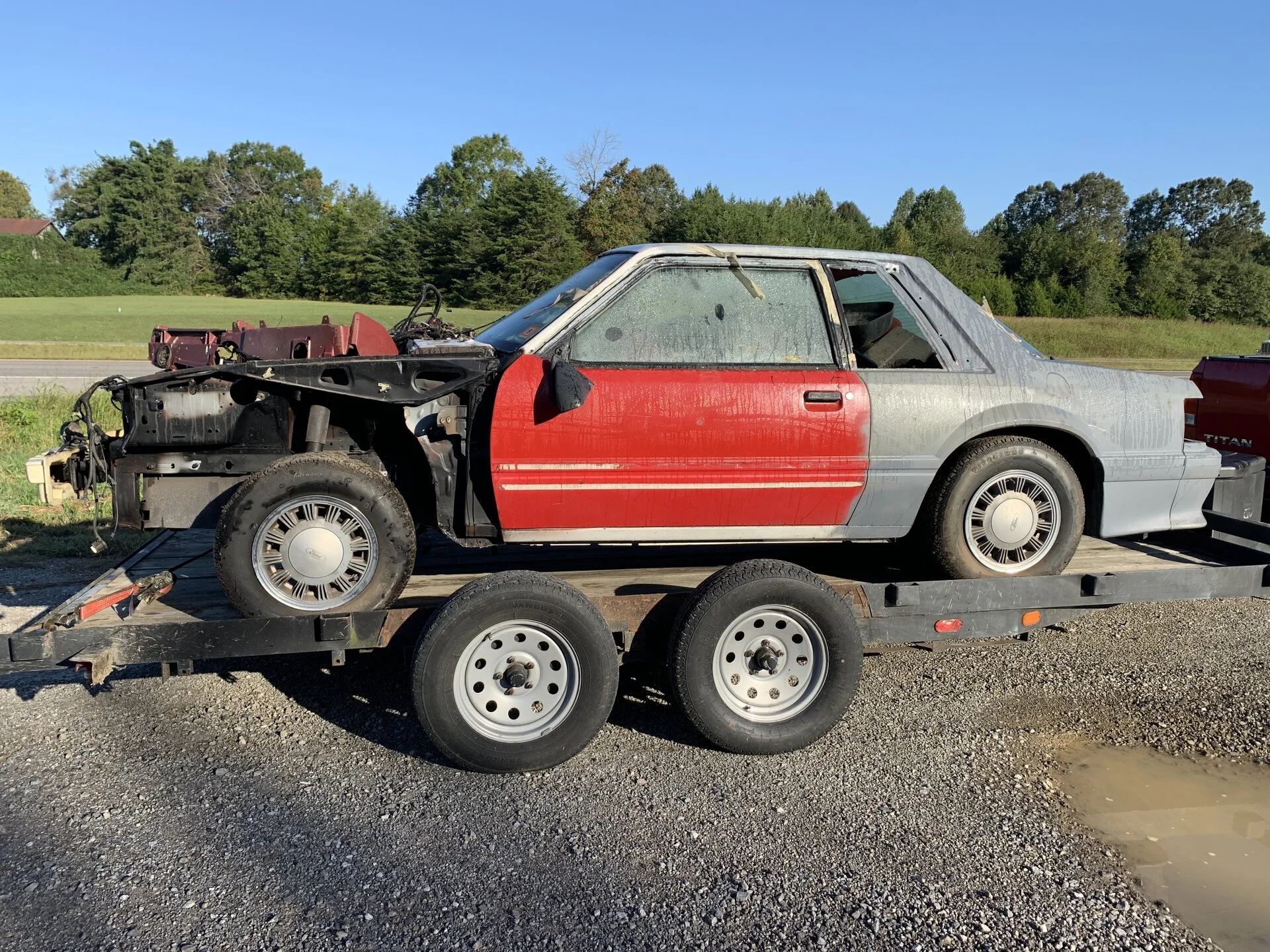

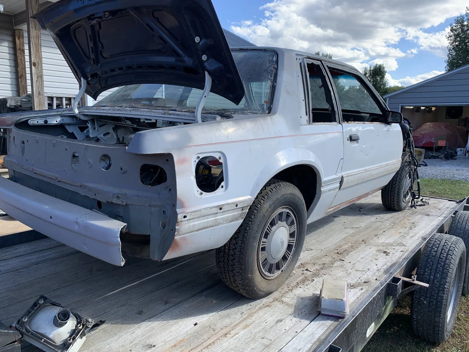

Picked the new project up this morning. I looked for the one I could save. $300 bucks later and we are on our way. So for those keeping up. I’m plus $800 From the donor and a t-top conversion. I have a ton of parts to sell from the notch project. A 302 motor and 5 speed setup..Among other stuff. So I’m going to try to document how much is in it
