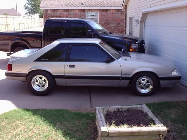

Itll work with the right backspacing. You may need to lose quadshock, beat in inner fender, and maybe a spacer. I have pacer draglites, 15x10, 5" spacing, and a 26x11.5x15 tire and I still have my quadshocks, no modifications at all.
