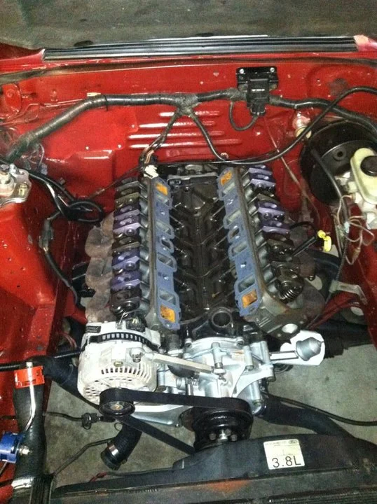

well its all apart new gaskets are here... im going to look for a way to put a breather on my PCV hole before i put it back together.

breather added to the lower intake where the PCV use to be...for now atleast.
had an issue with a leaking hose which was actually me just being a dumb ass and forgetting to tighten the clamp (whoops)
going to hit a junk yard soon to find an electric air pump for a V6 mustang LS1 or LT1 Fbody. and make a vac pump to plumb in a catch can and help with ring seal.
