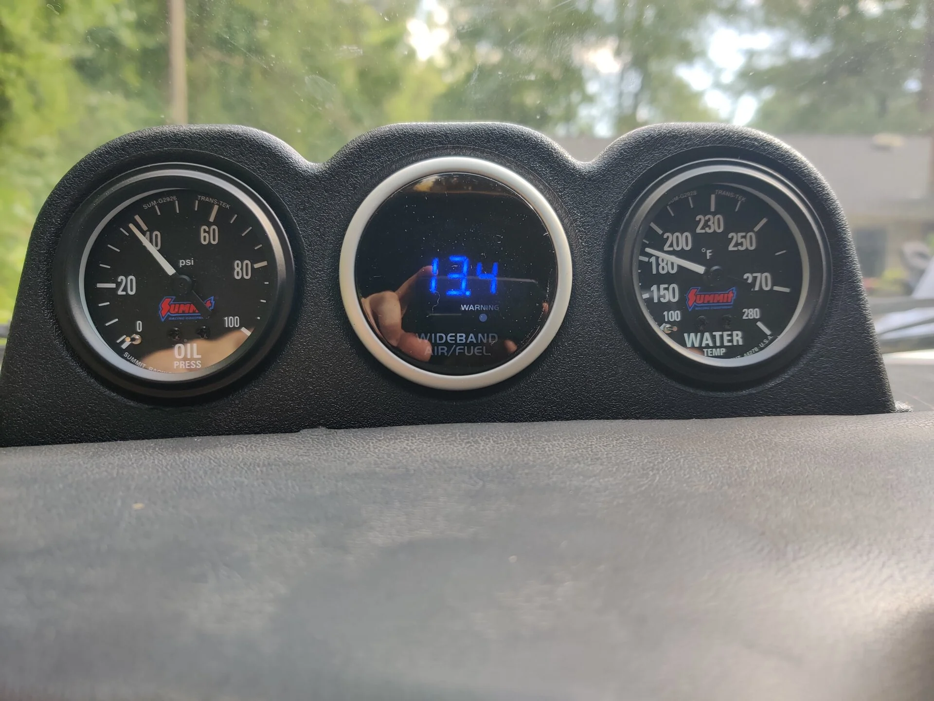

Oh, and a pic from just after I parked it and just before I shut it down. Notice the temp gauge is right around 180.... :D
