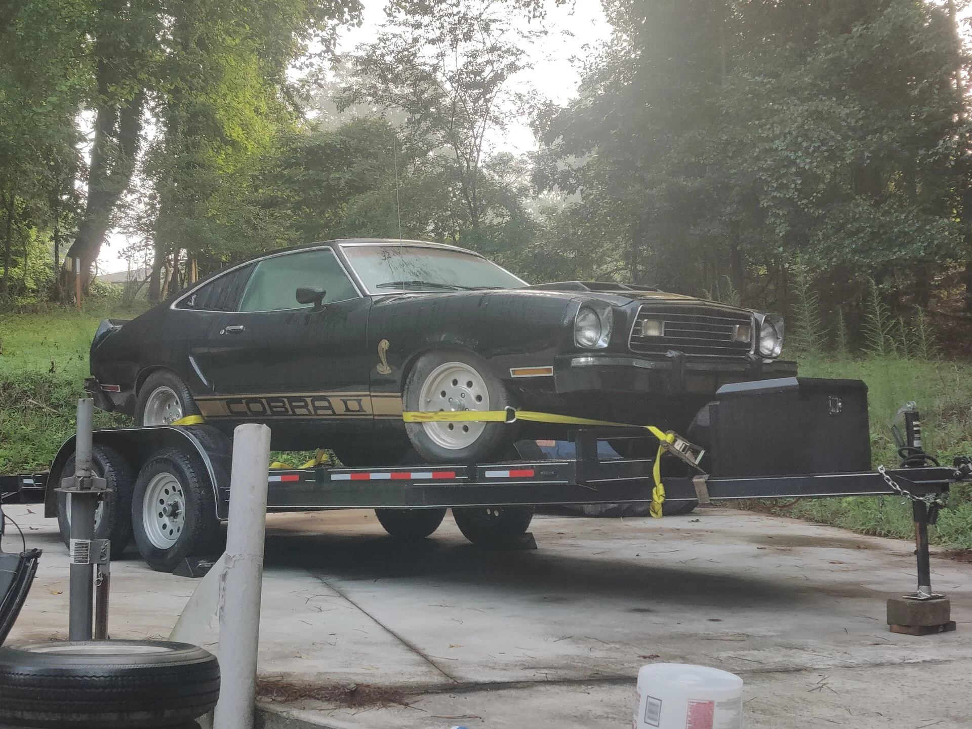

I decided on Friday night at about 7:00 that I was going to give it a try with no one on standby. It had almost no gas in the tank, so I dumped about a gallon in from the lawn mower can. I was just going to run up to the gas station about a mile or 2 away then decide what to do from there. When I get there their card readers are down and I have no cash. So I leave to come back home. Before I get to the next light it starts chugging and my AF gauge is reading really lean. Apparently the gallon I put in the tank wasn't quite enough to ensure the pick up would keep the pump fed. The funny thing is that it died in the exact same spot it did the last time I had it out. :cautious: So I start the walk home and the distant thunder I heard earlier finally reached my area. So now I'm walking in the rain..... :mad: I get home, hook my trailer and go pick it up. I run the opposite way to the nearest QT and give it about a half tank while it's on the trailer then take it home and unhook. Yesterday I went out just to see if it would start and it popped right off, but that's as far as I got as I had other plans yesterday. I might try to take it out again today, but I dunno..... We'll see what the day brings. But I'm fairly confident that I've gotten the prior issue solved, but I still would like to confirm it before I do much else with it.....
Btw - having that winch is AWESOME!!!!

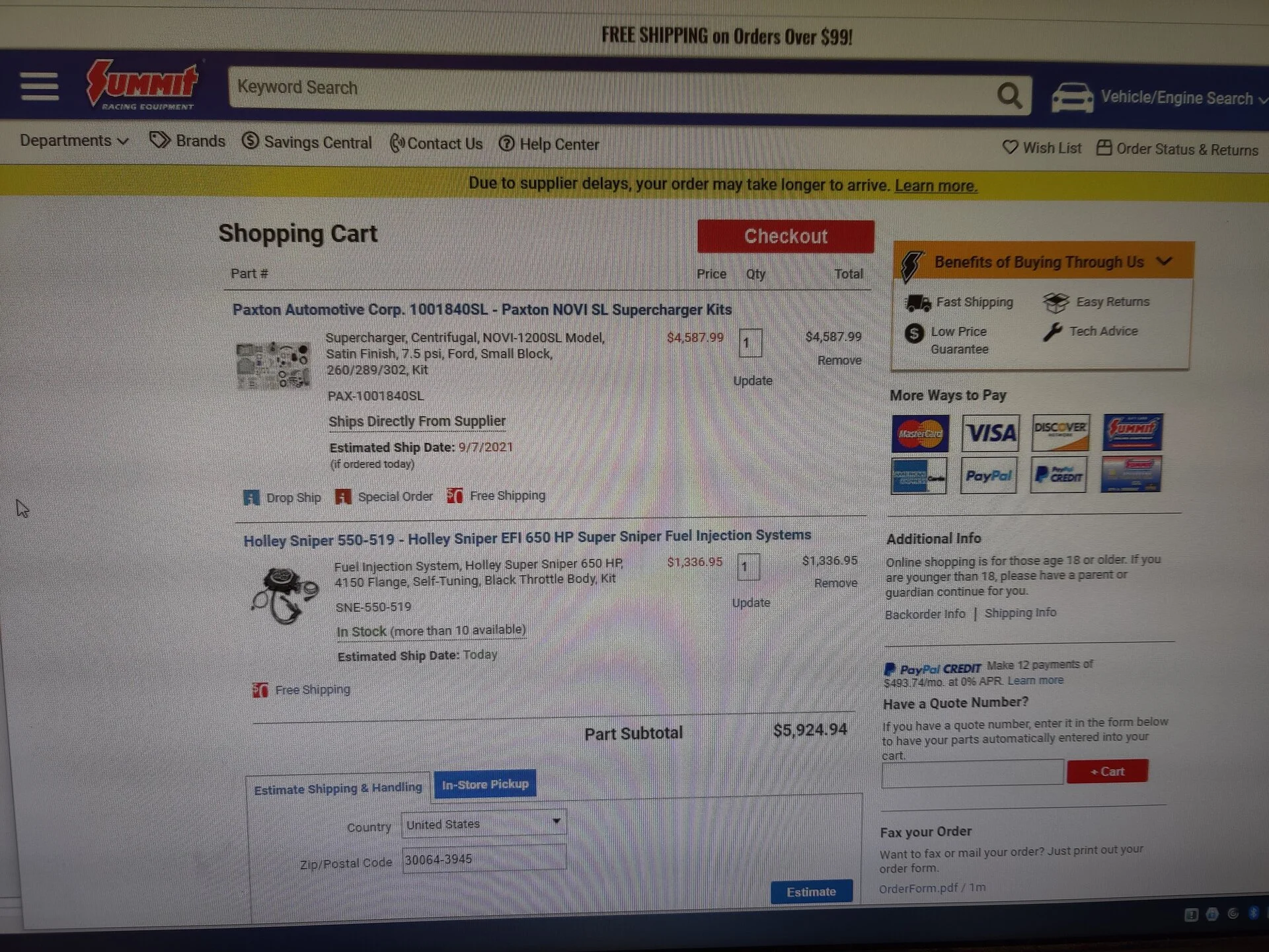

I had thought about that during my walk and will recheck them once I start working on it again. And you're right, it will most likely be a winter job. I'm too involved with other projects for me to start ripping into the car. I imagine it's going to take me some time to chase all of the wires in the harness to ensure that they are intact as well as re-loom the harness. I think that will be my number one priority when I decide to get into it. After I'm convinced that the wiring is up to snuff, I will get into my fuel system. I am thinking of doing exactly what I think you've done and install an electric pump near the tank to push fuel to the mechanical pump. I'm not sure if I believe it's vapor lock or if it's actually that the mechanical pump is starting to go bad or what the deal is, but I think I'd like to eliminate that variable. While I'm tearing into the fuel system I will most likely tear down the carburetor and give it a once over. I think it's very possible that I have a blocked passage somewhere that's not allowing fuel to pass as it should. I've also thought about eliminating the carburetor altogether and just going with a fuel injection system. I'd really like to go with multi port, but for ease of installation I'd probably go with the throttle body system. I have a lot to think about in any case..... :shrug:

My carb is a dual feed, so I'd have to locate and/or make the connecting pieces to be able to run a single line to flared fittings at the carb. Otherwise I think you're right, I really shouldn't have any problems supplying the carb with fuel as long as everything is good. I mean it used to be fine and I haven't changed anything in that regard, so I believe it's ok, that's why I'm going with the wiring issues first. I know there's an issue there and I have a fairly good idea where it's at, but if I'm going to dig into it I may as well do it all and make sure it's all correct, then beautify it. I think the fuel issue is more of a loose manifold or dirty carburetor issue than anything else. But that's not stopping me from shopping around for my pipe dream list! I mean IF I decide to go down that path, I may as well make the trip worth the effort.... :D
