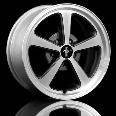

Here you go
New 5 spokes for 140$ each.www.summitracing.com part # FMS-M-1007-J178
They have a machined finish lip, and charcoal grey spokes.17 x 8 ,5x 4.5 bolt circle that we use, and 5.72" back spacing, so you will need spacers. I got mine a year ago and they are great.They also did free shipping (not sure if free shipping is still on though)They are on my 03 cobra,so they clear big brakes.

ultra wheels have a take off of the AR TT II's for about half the price of the AR's, check out discount tire, tire rack etc. to see what you can find. personally i would stay from the spacers if at all possible, unless you go with some of the new mach 1 wheels, i like those on the classics.
They do look good.
