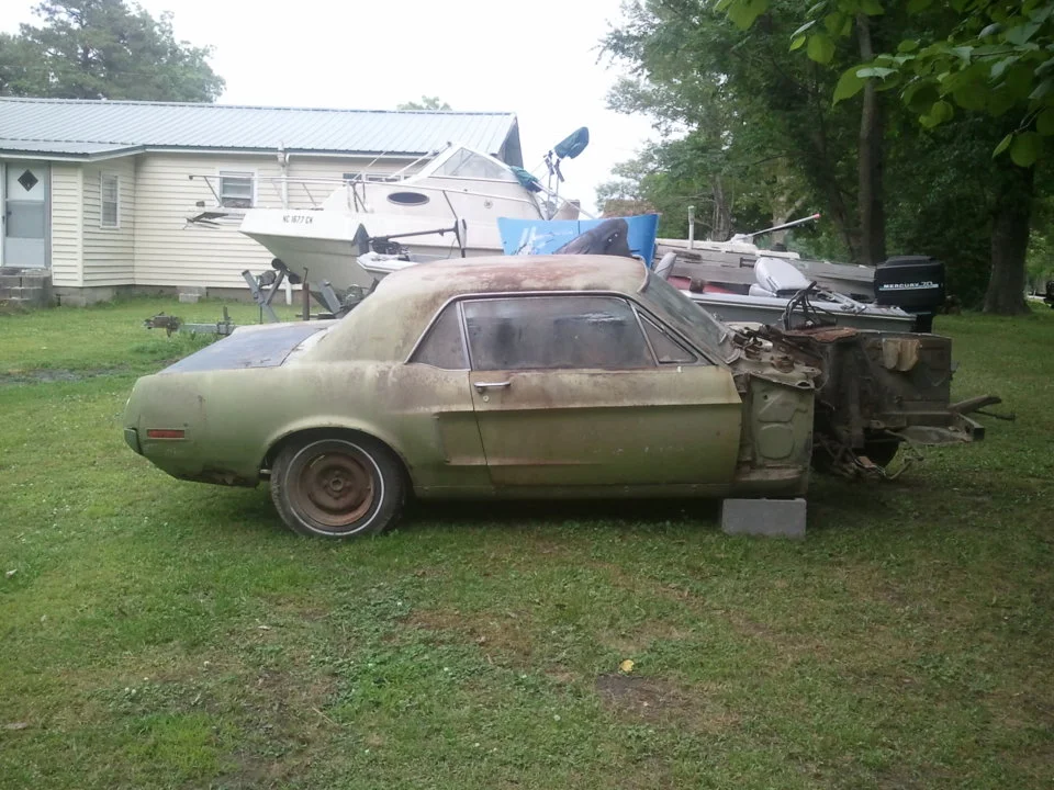

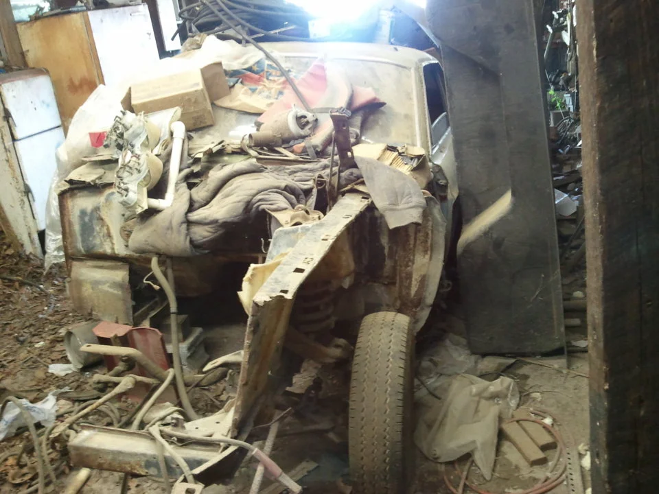

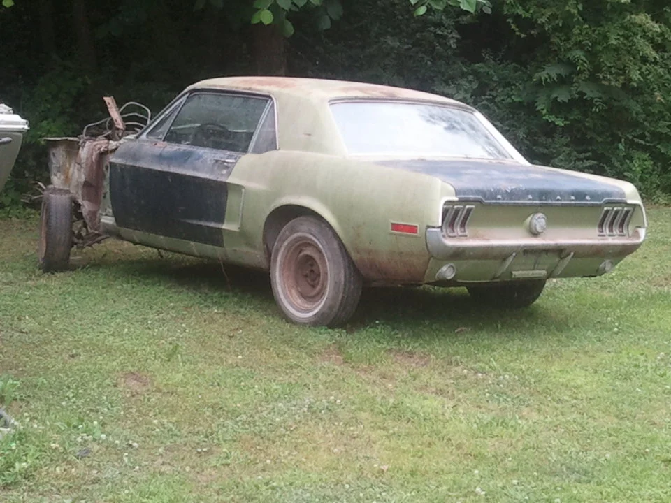

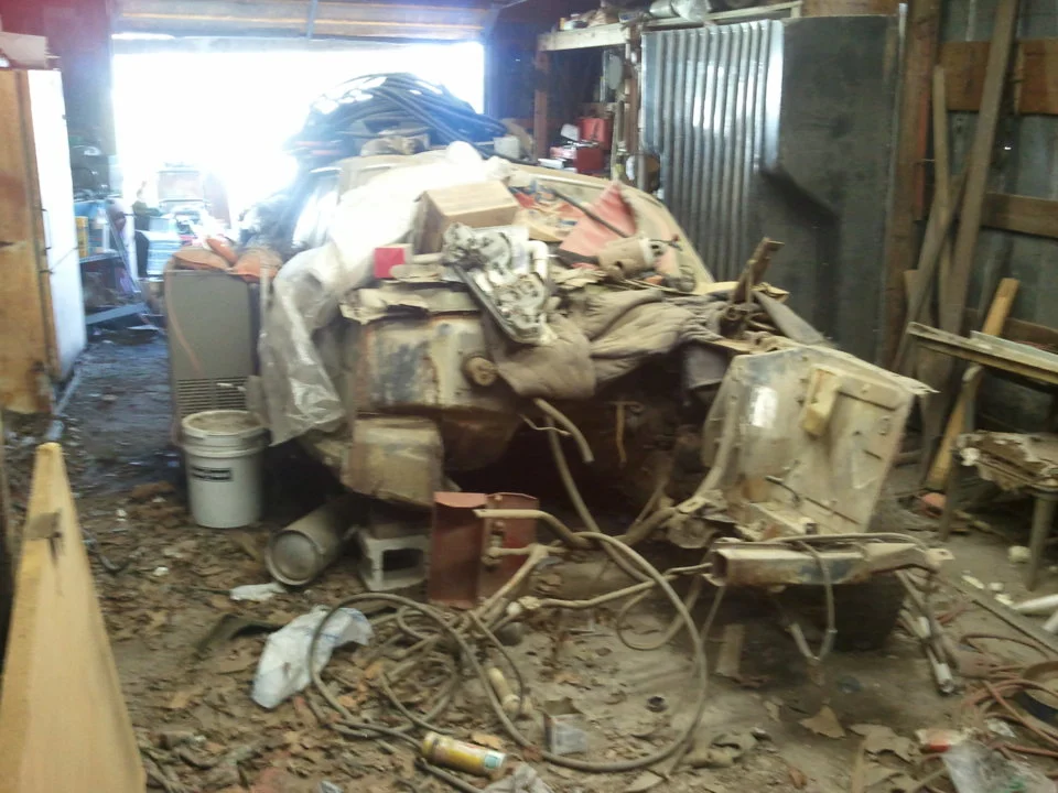

My stepson and I drug this mustang out of a barn. These are pics from the day we brought it home. The light green paint is original and it still had the warranty plate inside the glove box. We got it from the son of the lady who bought it new. Unfortunately, someone attempted to change the front frame rail but gave up after they cut the right side off. Then they lost the right side so what you see is all I have. I do have the fenders,grill, hood,valance pan, front bumper, and a new inner and outer framerail that was ordered by the previous owner.

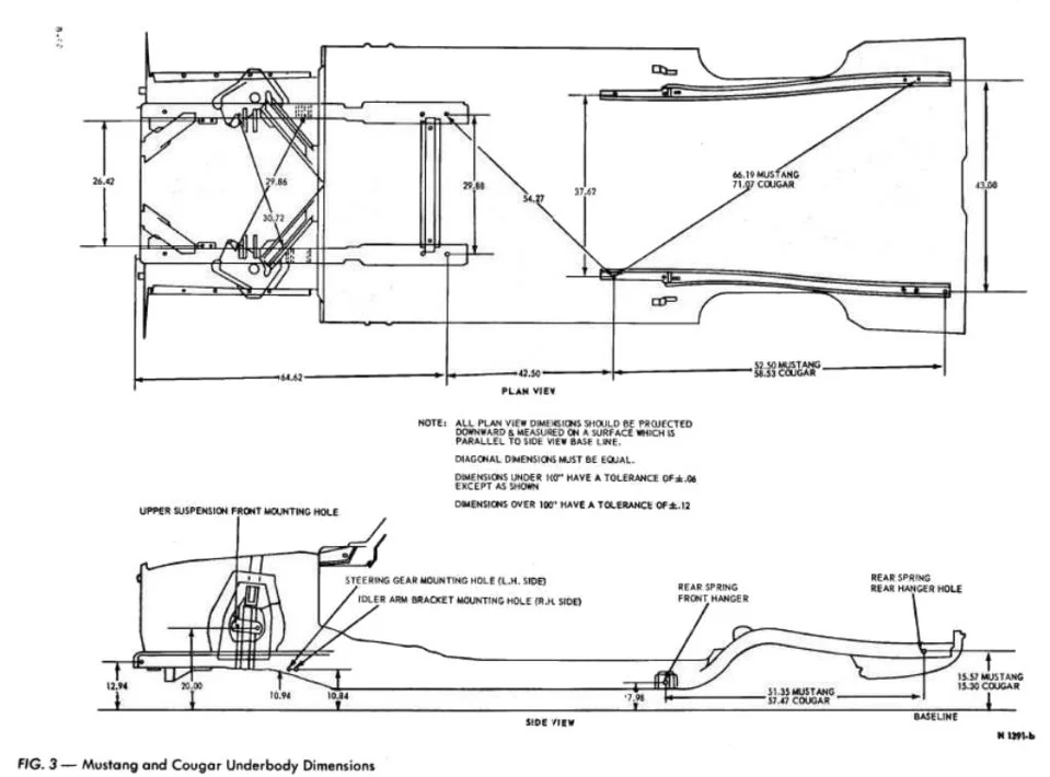

First thing you will need to do is find a good solid platform to level the car on /concrete slab ,or at least a good packed drive way . Level it side to side and front to back . You will want to use jack stands under the rear torque box area beside the front of the rear leafs ,and it would be best to use jack stands under the rockers in the front so they do not interfere with the new rail going back in place . When you get ready for measurements i can get them for you . Jim
