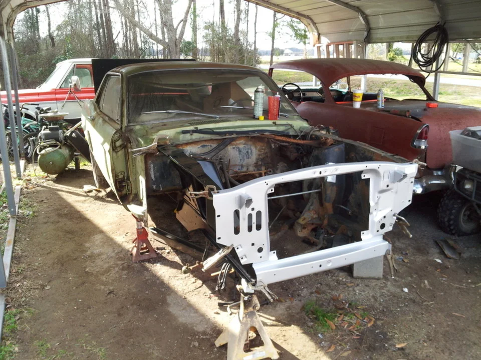

I am trying to trial fit my inner fender, new torque box, and floor support. I will also be installing a new toe pan to repair the bottom passenger side of the firewall. I believe the rear of the inner fender fits flush against the firewall and then the torque box welds to the firewall and goes over the top of the frame rail flange that welded to the firewall, is that correct? I'm guessing that I need to repair the firewall first, weld the frame rail and floor support in 2nd, and put the torque box in last, is that right ?

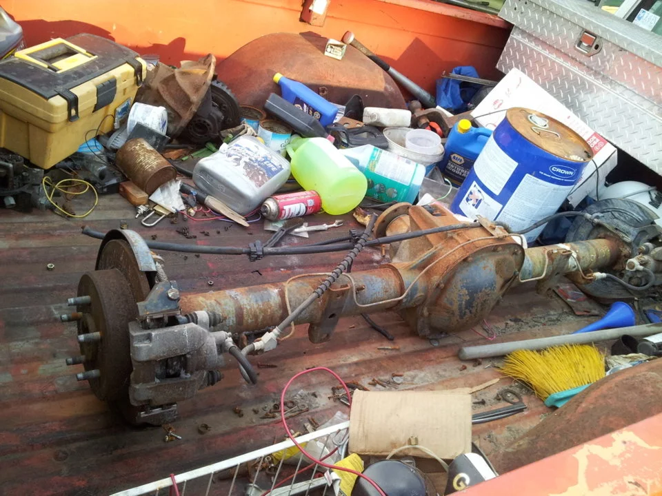

I bought this rear end yesterday to replace the 6 cyl. axle in the car now. It is an Explorer unit with 4.10 gears and limited slip. I gave $150 for it.
I stuck the radiator support in place and put a few clamps on it just to see a trial fit. I am going to go outside in a few minutes and take it back apart and start repairing the firewall. It will feel good to burn a little welding wire. Maybe I will feel like I am getting somewhere then.

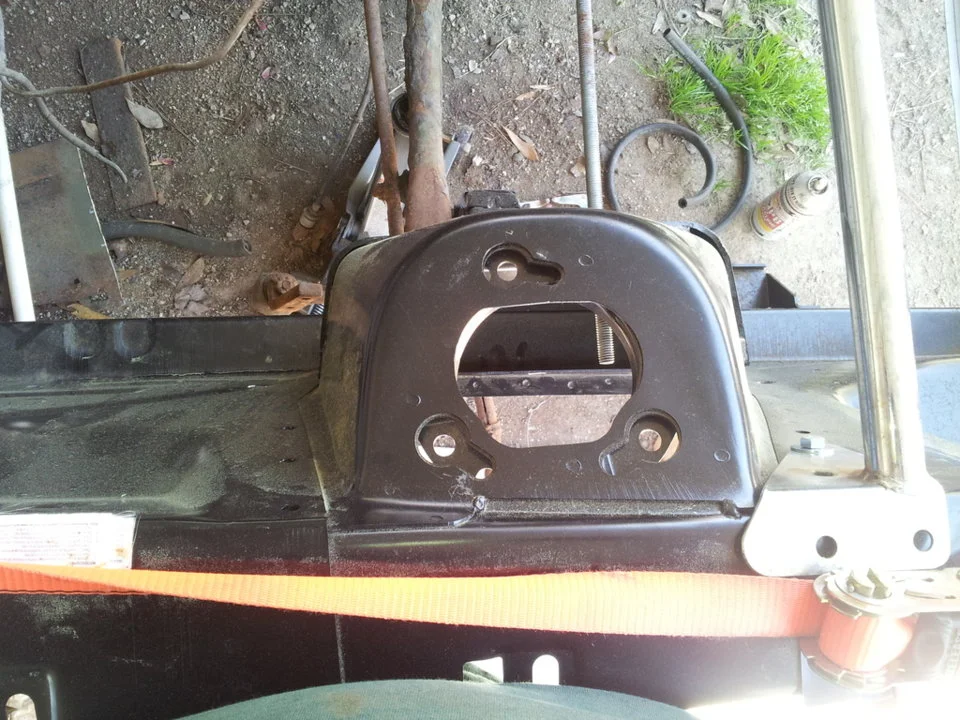

Do these holes look like they are in the right place? Neither the shock bracket or the support bar that goes to the firewall will line up.

Just from Googling Monte Carlo bars for 67s, it looks to be in the right place. We don't have one in ours to compare. Here's one owner's procedure for installing the export brace as well as basically the same question, posted on this forum: http://mustangforums.com/forum/clas...-monte-carlo-bar-won-t-clear-comprssor-2.html
Post #13:
Courtesy jdraper from mustangforums.com
"The best way to get the one piece export brace in is to support the car from the center (pan if you can) and let the body sag....it will pull the shock towers out away from the center slightly, allowing the brace to go in easier. It also helps if you can put a ratchet strap across the brace to pull it together slightly. Put it in without the shock tower tops on so you can access the center. Once it's in, release the strap. This will hold the bolts in place so you can put the shock towers back on."
