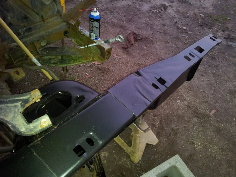

After all this time I have finally gotten around to ordering a new right frame rail/shock tower assembly, a radiator support and a floor brace. Hopefully I can post some repair pictures soon.

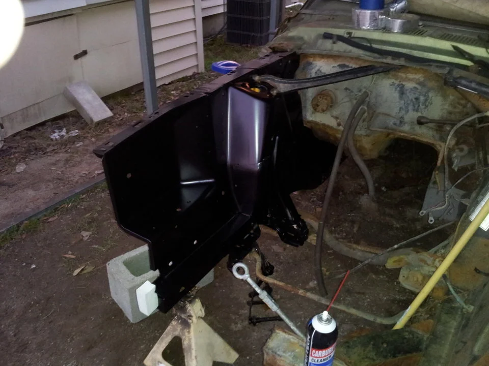

I loosely stuck the repro inner fender in place today just to get a look at it. This was the first time I have had it out of the box. I mainly just wanted to get it out of the box and verify that it is the correct part for now.
