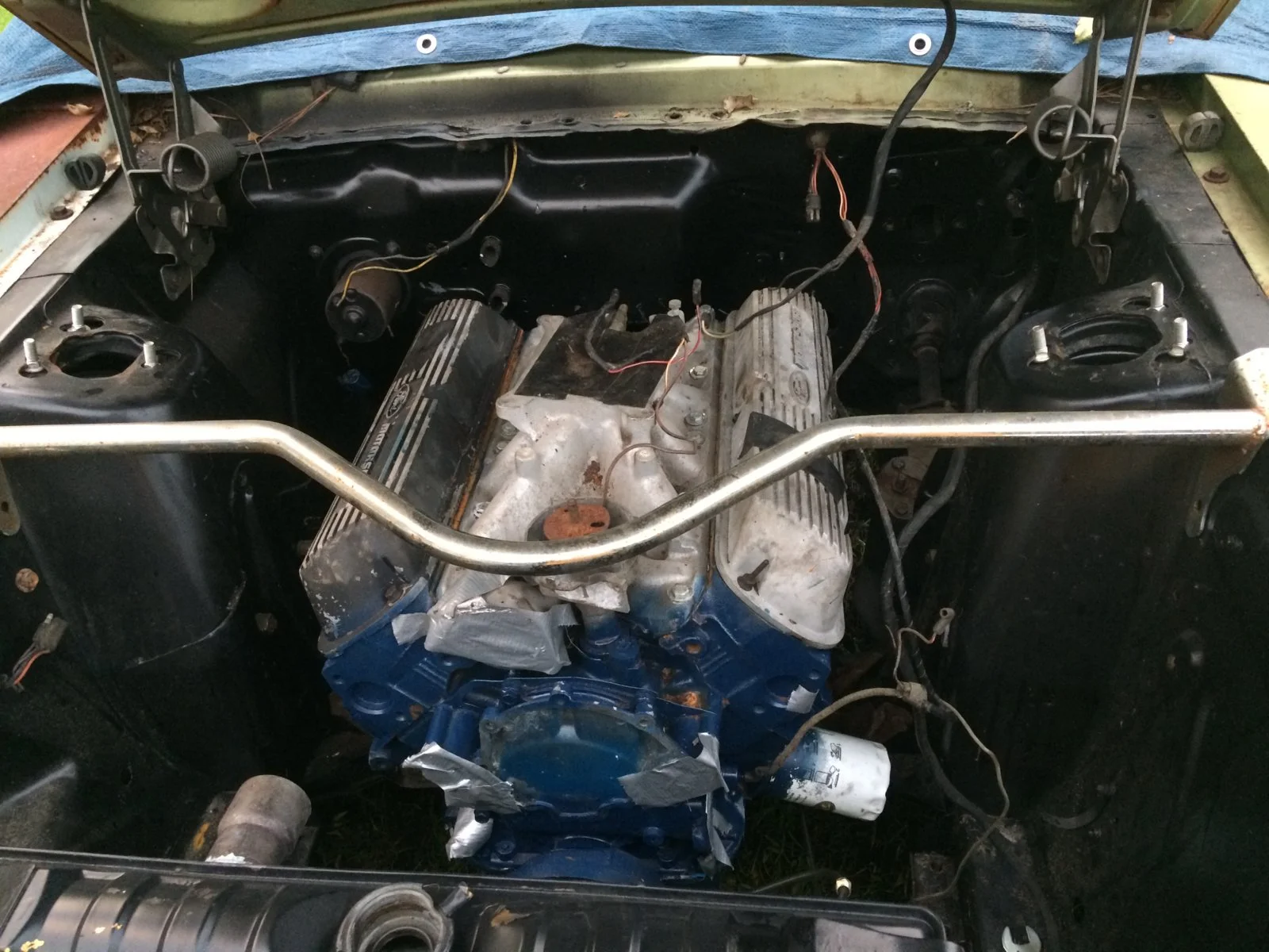

I finally got the engine and trans bolted in this thing. It only took two attempts. I had the frame brackets bolted in on the wrong side in the first attempt. All I’m missing now is everything around the engine. The rear springs are sagging bad. I probably need to replace them before I measure for a driveshaft.

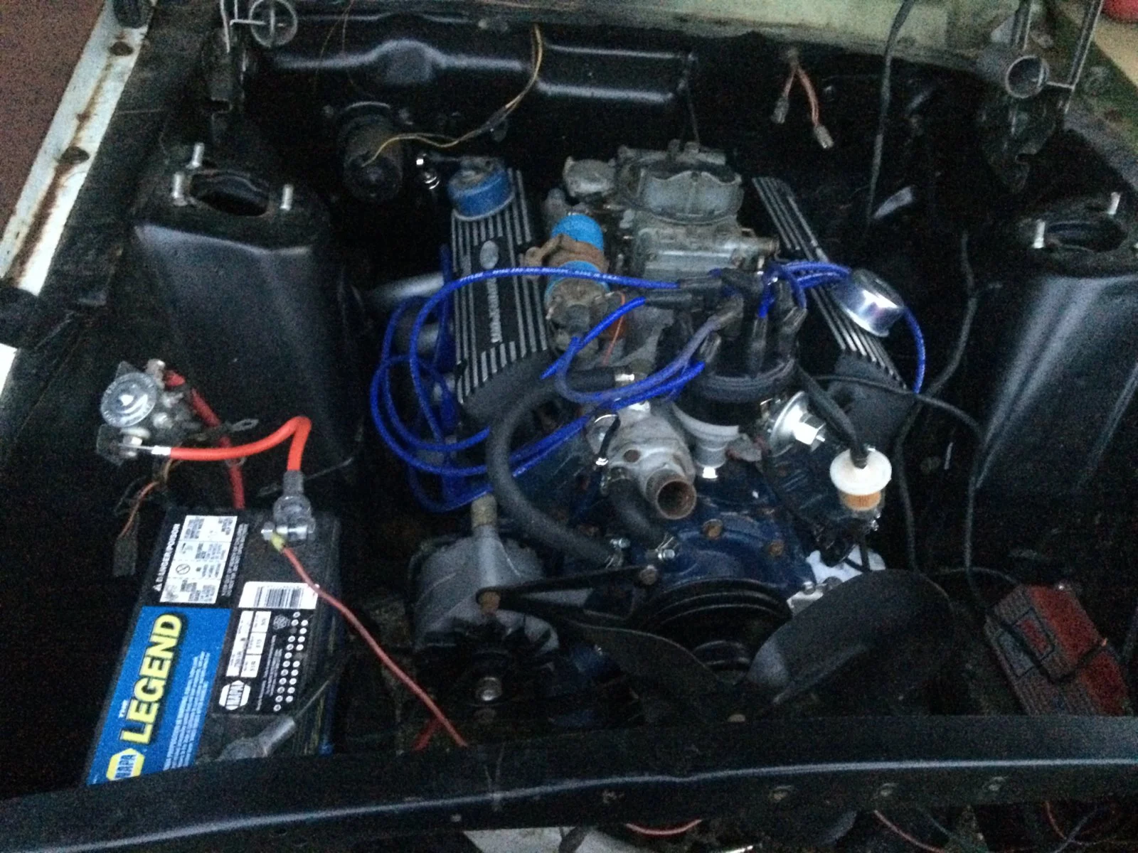

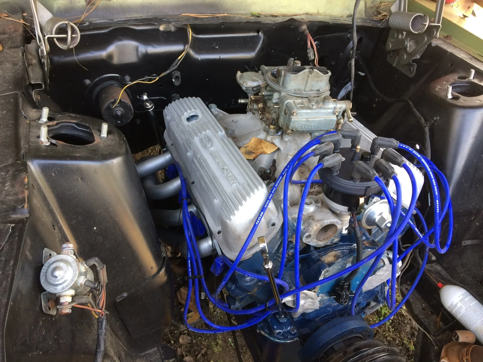

About ready to try to start this mess. It’s a simple car but hunting down missing bolts and parts has made progress slow. The radiator I sourced for it is wrong, so that’s my biggest hold up at the moment.
Thanks. I got the thing running today. It lit the second time I hit the switch and runs great. The carb does need a kit but I’ll get to that later. Time to work in getting some brakes on it now.

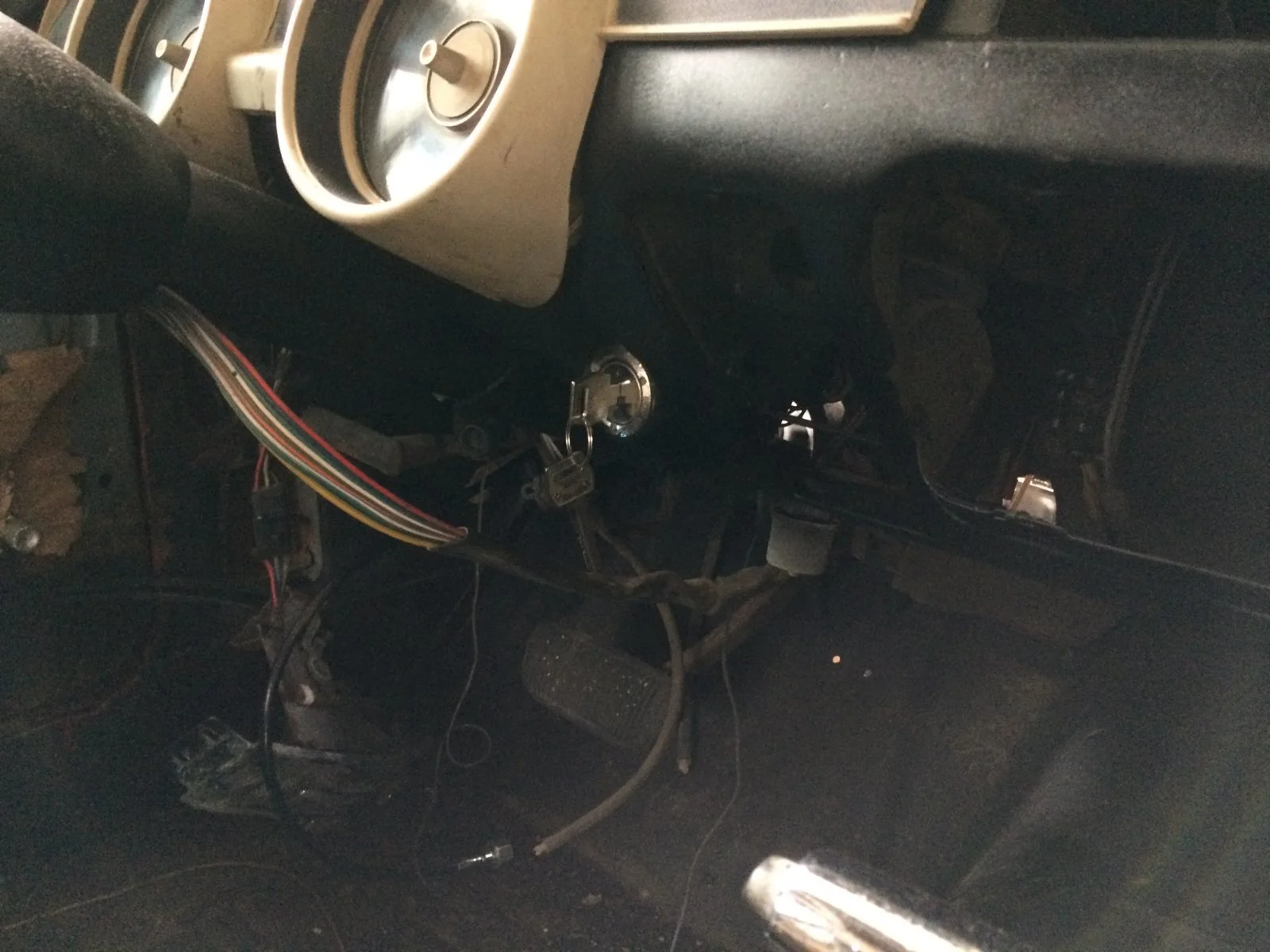

Been working on hooking all the wires back up. If I had an electrical manual things would have gone faster but Ive been sorting through the mess the old fashioned way. I cant believe the dome light still works.

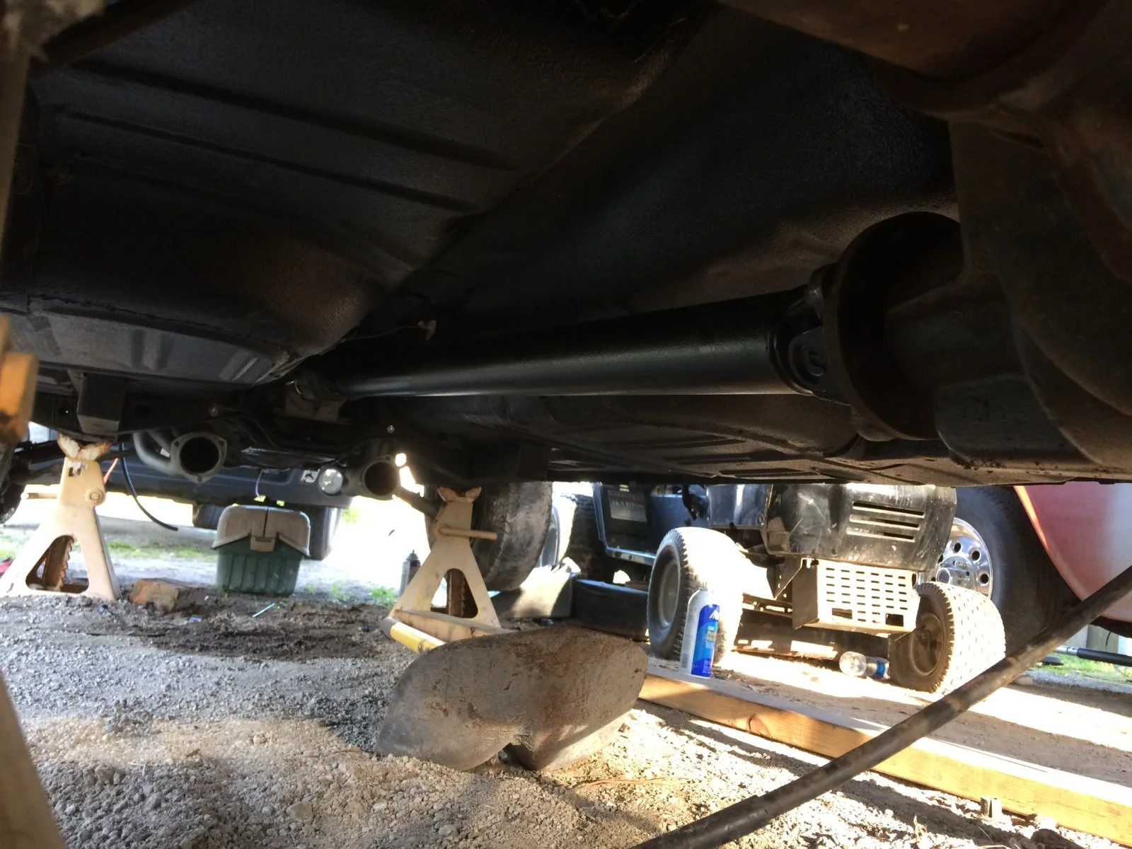

I don't have any pics, but over the weekend I replaced the rear springs with new ones from CJ pony parts. I'd love to get it off the jack stands and see how it sits with them but I'm trying to have enough patience to get the driveshaft in it and the rear brake lines run before I do that.

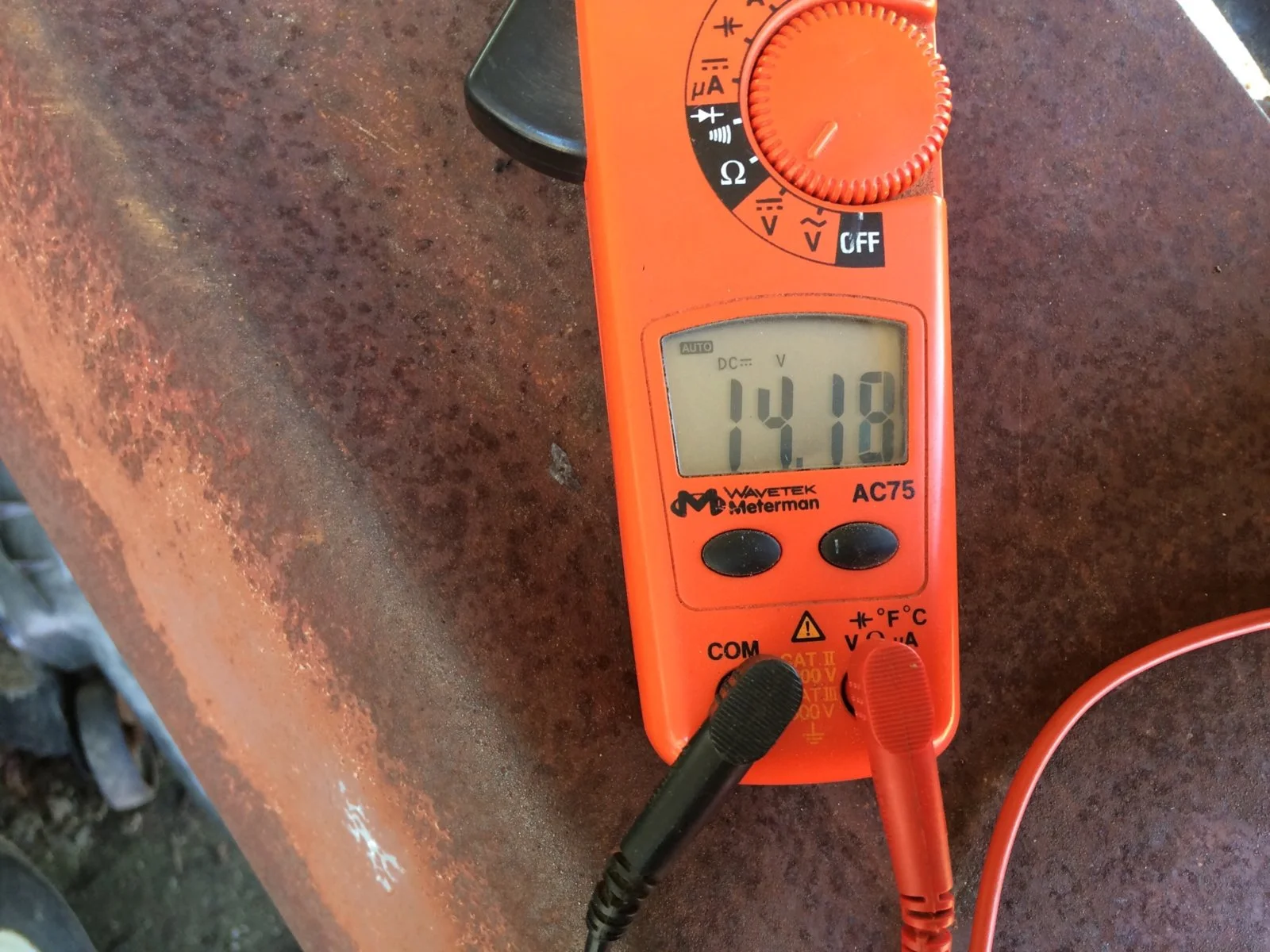

Mechanically I have built this whole car out of second hand parts and some of them came from some less than ideal places. Some of the things might get upgraded later but I was missing so many things that I’ve tried to save money everywhere I can. This car had probably been parked 25 years before I got it. I’m amazed at how many things have gone back to work like the wipers, the dome light, and even the high beam indicator light. The thing even charges lol.
