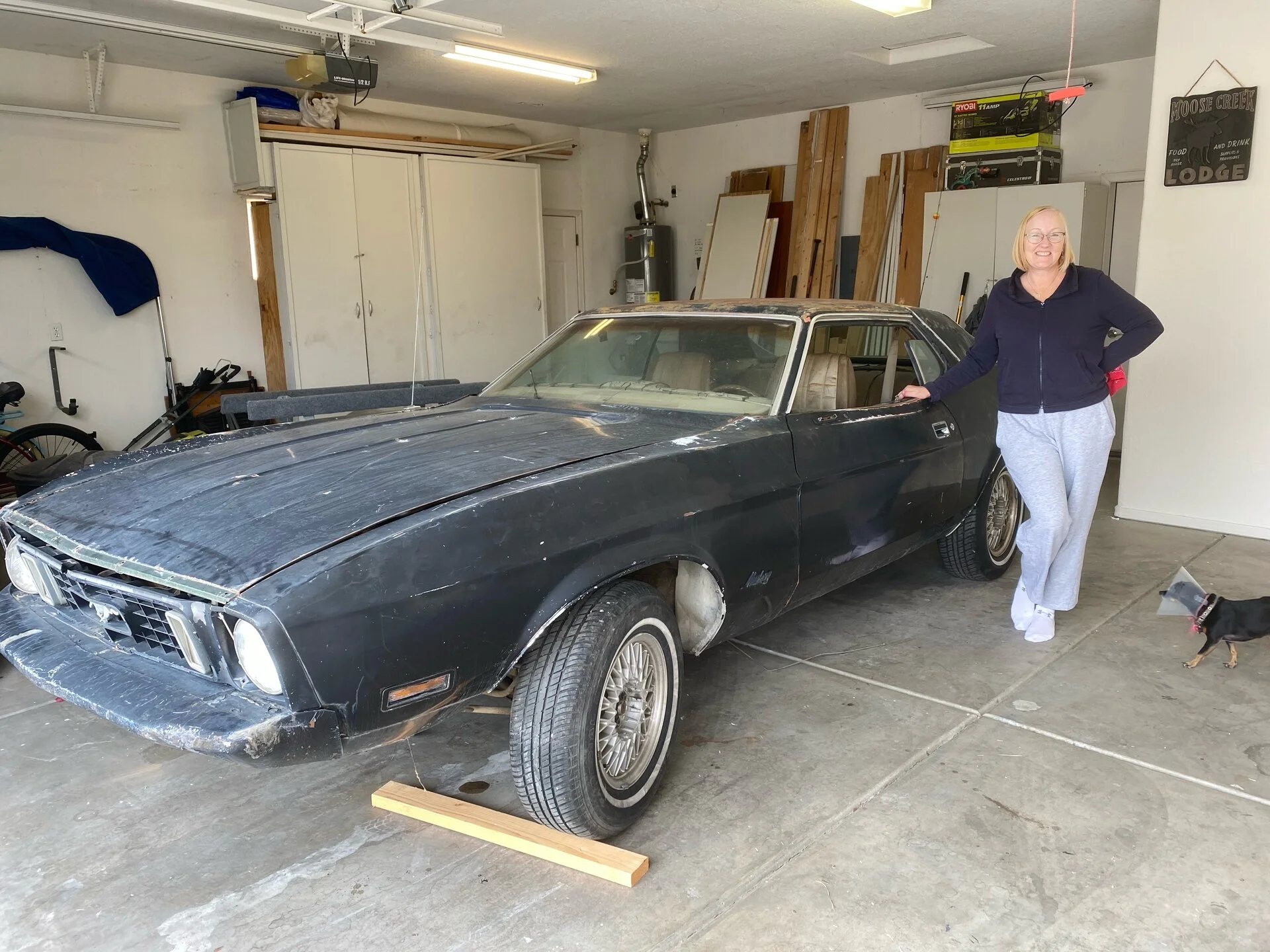

Hello:
I recently purchased a 73 Mustang Grande that has a better than average body, but the typical worn and torn interior and partial disassembled driveline. I’m not sure what I want to do, other than never more than a dependable driver, but I need to decide before I spend more and I thought I would pass the options by the community before starting. About me, not my first Ford “restoration” project car, did a 68 Ranchero and a 69 Torino Cobra, both were body work, stock engine/trans rebuilds.
1. Do I try and fix the 351w under the hood and reattach the FMX in the trunk, in other words, do I keep it stock? The front cover of the engine is missing, but many of the other big parts are in the trunk (has a very full trunk).
2. Do I purchase a used more “modern” engine/trans and if so, what makes for a “it fits under the hood and in the trans tunnel” swap while still has fuel injection and overdrive in the trans? I’m leaning this way because I want to improve the mpg and take it on localish trips.
3. Do I do the very modern swap (like 2015 or newer) package?
I also want to restore the interior, but not break the bank, so where to go; seems everyone sells mustang parts online; wasn’t the case for rancheros or torinos.
Thats my story; any advice will help and thank you in advance.
Steve

Full on Mary Tyler Moore car...Fun, looks to be good shape.
Half vinyl roof? Cool!

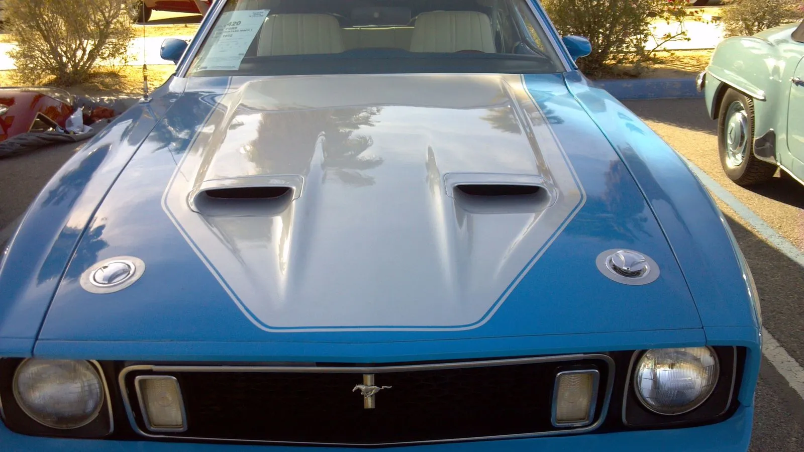

And lets get on to burn out pictures...Driving is funner than fixing'.
Might need a NACA Hood on it and more pre fixin' pictures.
Junk is likely a good word for it. From the missing timing cover forward, nothings there. I do have the water pump, hoses, and radiator in the trunk. The engine is sitting on the motor mounts and resting on the center link. There was a transmission, in the trunk, but it turns out to be a Chrysler 904, a prerunner of the 727. Lots of other stuff in the trunk, but no timing cover. I need to get the springs on the hood hinges so I can open it enough to get a better look at it.
I understand the 1994 and newer Ford 302 and 351 had roller cams, EFI, and AOD trans. While I’m not looking to build big power, I think this could be a good foundation for reliable but some fun driving. It would be great to hear from others who have done the same. BTW, whats a NADA hood? I intend to post pics once I start. So far, just cleaning the trunk and finding all the rust with my magne. So far, only two small spots in the front and rear of the passenger wheel opening.
