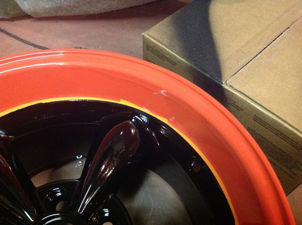

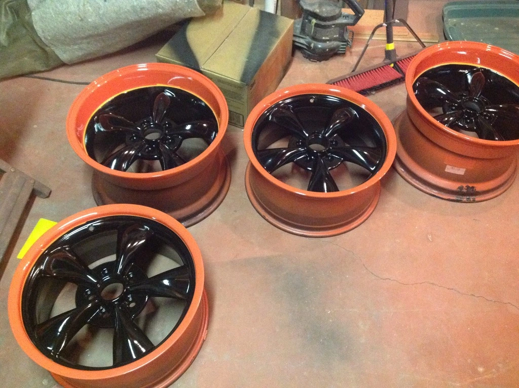

Once fixed, I cleaned the wheels, primed them with etching primer and spent a mind numbing 90 minutes masking them up.
So,...that said....this is what I did:
The black paint is still mega wet. ( Ask me how I know this) It's supposed to be satin black,...I'm confident that in a couple of hours they'll flatten. The fine line tape is still on there for that reason.
I did sag the pi ss outta the orange paint though,........ in several places. I'm kind of up in the air over how to fix that...they look like holy hell.

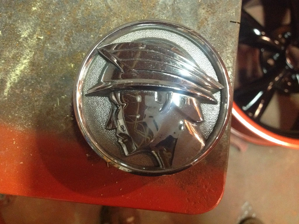

Lastly there's Melvin.... What to do about melvin...
If I leave him alone,..that might add the necessary bling to make the wheel's pop. Or conversely, I can paint him...
Black,....Orange,...Gold.

Rims are looking good .. Those wheels are reverse mount right? Should you wait to fix the orange until after the tires are back on?
I vote For a chrome Melvin.. Or gold lol
What did the center caps that came with your wheels look like?
Edit: paint inside rim hoop orange :-)

Ok,....business as usual for me I guess. The sags are too extreme to wet sand out. MOF, attempting to do that has broken through in other areas on the very first wheel I attempted .
But then you already knew that,....didn't you Dave? @Davedacarpainter
Fck me to tears.
You have to see the bright side Mike, when you cut the runs out of a single stage, the color where the run was will be a different color than the rest. What you have here is the opportunity to take the wheels back to the powder coater and have it done like you knew you should have before you got cheap and figured you could do it yourself.
Do you recall me saying that I HATE painting wheels. Do you kind of feel me now?
