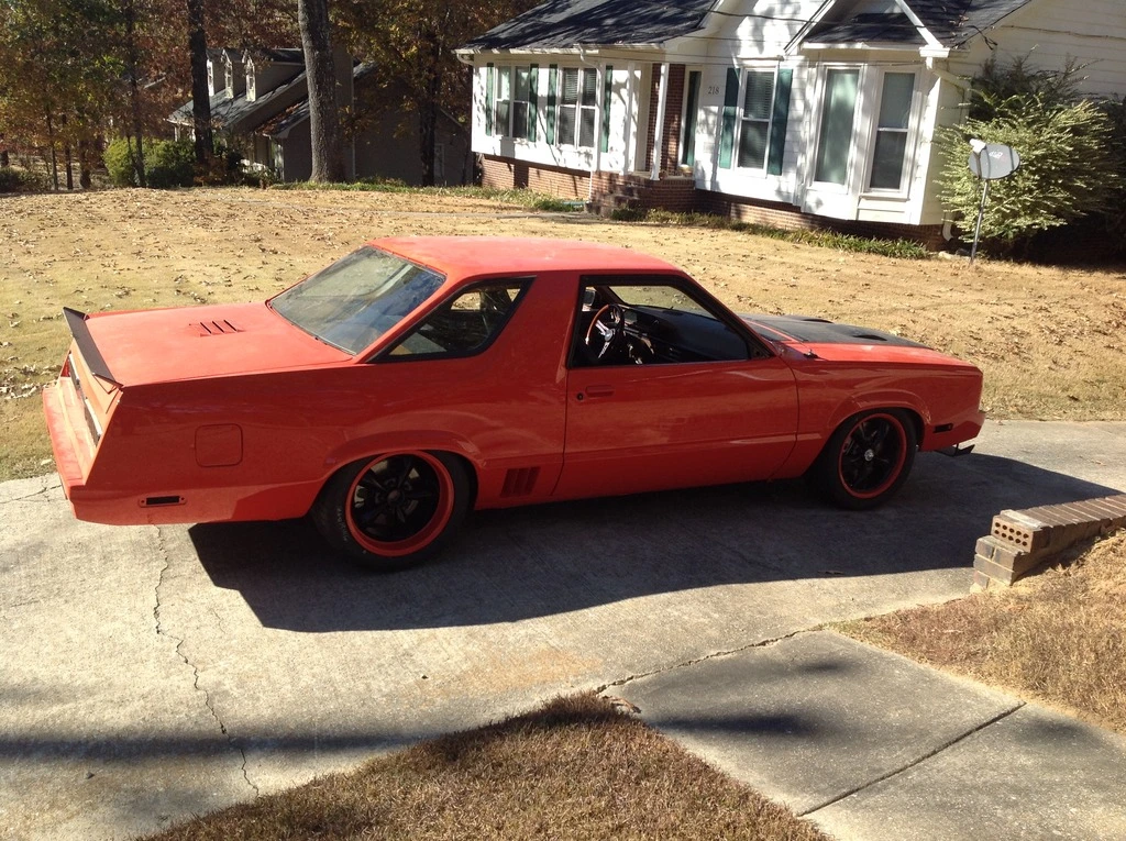

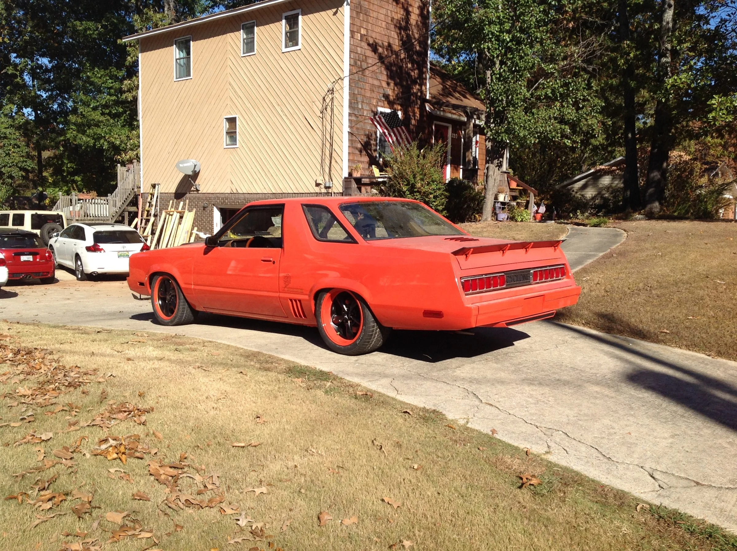

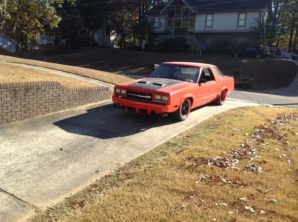

It runs! Took the thing around the block multiple times while letting it auto tune.
This is the first time I've been able to step away from the car and look at it. I thought I was gonna hate those orange lipped wheels, but they are right at home. The thing is visceral to drive. loud and clunky, from all of the solid mounted stuff, it sounds like you are sitting right on top of the engine. The front tires scrub on a hard turn, but I am not gonna change the rake...so I'll just have to treat it like a 18 wheeler, and be cognizant of my turn radius. I think it looks freakin great,...it's exactly as I've imagined it would be.
Still buttloads of detail work left to do, and some driving for sure. It runs 65 P.S.I. , stays at 187,..It appears that I've wired everything correctly as all of the rest of the gauges (including the speedo) register. But most importantly.....Inside, this thing sounds so freakin cool. The tail pipe is not fart pipe sounding at all,...kinda has a low almost diesel truck like growl when it's being lugged. The trans will take some getting used to because it's full manual, it lurches when you stuff it in second, and in 3rd, it's just beggin' me to put my foot in it. (Not gonna happen until the AFR targets are set for the impending boost) that's gonna require some more studying on how and where in the map I do that. All I know is that it almost idles now,...at about 800 RPM in gear. the surge is still there a little bit.
I'm a liitle rambely right now,......I'm about as freakin happy as anybody can get.

I've been looking at the pics,..It needs to come up in the rear I think. I can't go lower in front the tires are already up inside the fender as it is.
I hooked up the lights in the rear center Cyclone emblem,.....Not gonna work. Several Leds are out/not working on the ends, and I just dont like it. So,..I'll end up making a recessed tray that will sit under that cover and I'll use conventional red incandescent bulbs. as running lights. I'll probably relocate two back-up lights into the bumper (probably use early Mustang repro stuff) or I'll recess something flush into the bumper.
