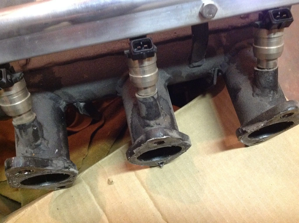

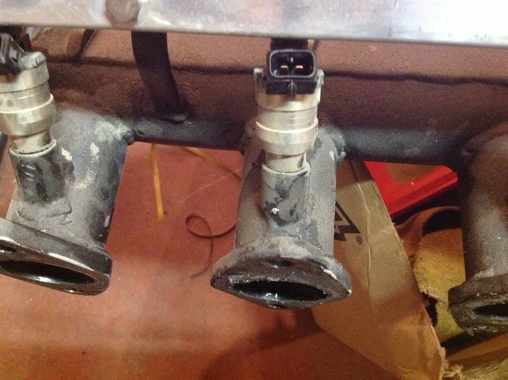

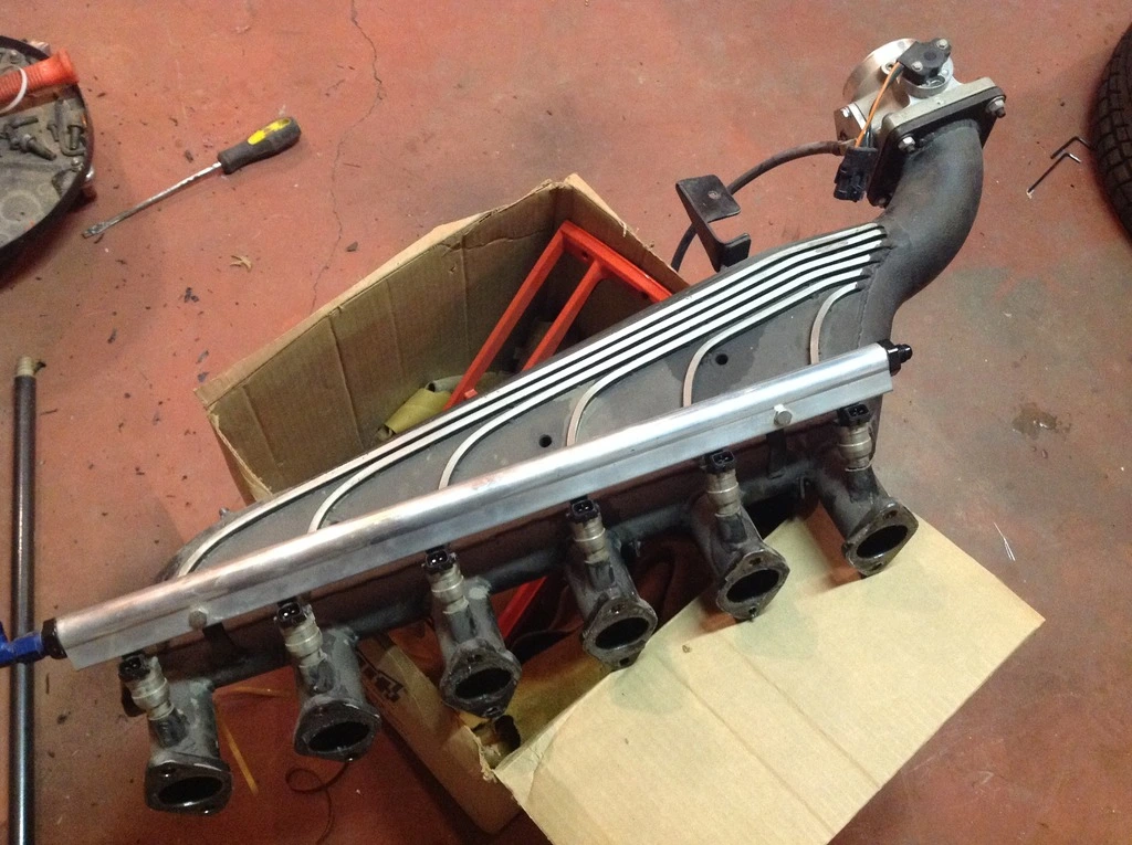

One thing I did notice was this:
Either gas is getting past the o rings, or the injector bosses. One way or the other, I gotta leak in two places.
There's also this wet spot on top of the intake,.....but I passed that off as having sat something oily there, but now I'm wondering about that too. Thing is,...how would gas get back there? It is coincidently where a weld is, so I'm thinkin' that it's a little suspect as well?
We're in a stage 4 drought. Water usage is restricted, so I cannot was this poor SOB off. If I'm to see if I gotta leak, and will have to do some additional welding, I gotta wash it off. Gasoline and welding don't pair very well. Maybe I'll have to use my buddy JB......

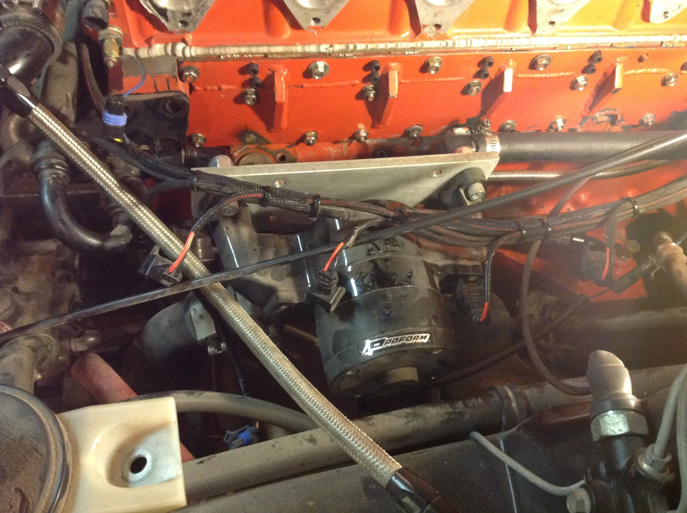

Since the intake is off you'll be able to see what hangs underneath, and why removing said intake is such a pain.
It gets very complicated under that intake manifold. And trying to get that plate off with this thing hanging and bolted to the bottom side of the intake is the reason I removed the damn thing after the fact. As hard as it was to get it off, getting it back on w/o messing it up,...............not gonna happen..

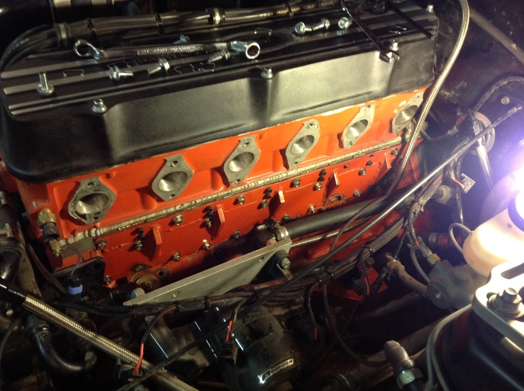

I made a gasket for the plate after all. I used some really thick (like .125) cork out of a felpro bulk gasket makers kit. I also skimmed the bottom of the sealing surface w/ the right stuff. Then I put that thing back on.
In hindsight, this plate is probably overkill. I don't think that I added back any integrity despite the fact that it's 3/8" thick, has 5 honkin' lugs welded on the side, and that bolted the thing on in every possible place, but it's done, so no choice but to use the heavy assed thing.

When I was drilling all those holes for those bolts/studs, I drilled two extra holes in the rear lower corner in the plate. Turned out that I could not drill the engine where the hole was (twice) so I plugged those holes with silicone (At least I thought I did) When I pull the plate,..I can see light through one of the "plugged" holes. Whether or not that was one of the sources of the leak, I can't be positive cause it seems like oil should been seeping from that hole. although it seems simple enough (and it probably was) Oil might have came out of the hole, and found a different place to get out like a roof leak. Those two holes are welded shut now. You can see the one up front that was welded, but the one in back is covered by stuff in the photo.

Finally got the Monster off of life support and back together. The oil sending unit for whatever reason decided to fck w/ me and the threaded stud that the connection goes on started to spin, so a nut would not tighten. When something "spins" I just consider that it's just twisting whatever it was connected to, and is no longer useable. So I reinstalled the plug for today so I could start the damn thing.
I decided to gasket the intake manifold, so I went down to AZ and bought some more stuff. This material looks like the stuff that a water neck gasket is made out of, so I hope that it will work with what I'm using it for. I wasn't able to get the damn bolt holes that hold the pump under the intake manifold to line up w/o major screaming, but I finally managed to get one to pass through. When I get the new sending unit, I'll work on getting a second one in there, and that will be all that I'm gonna attempt.
As for today,...the leak is gone.But before i break out the dancin bananas, I need to get the sending unit installed and run the engine up to temp to be truly sure of that. In hindsight, I'm thinkin that the bolt hole that I could see light passing through was my problem. That coulda been fixed w/ blob-u-lation, had I known that, but you couldn't see that from underneath.
So,..it's not as good as it was. Before there were 4 bolts holding that pump in place, and now I'll be lucky if I can get two installed. The cover plate was probably good to go (save for the leaking hole), and now there is a thick assed piece of cork that'll probably saturate and start leaking one of these days,....
