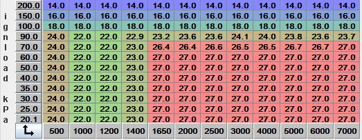

And I'm thinking I'm just gonna go ahead w/ the 27 degree table and extend that dude right on over to 500 RPM and be done with that until we get more time to seriously look at this.

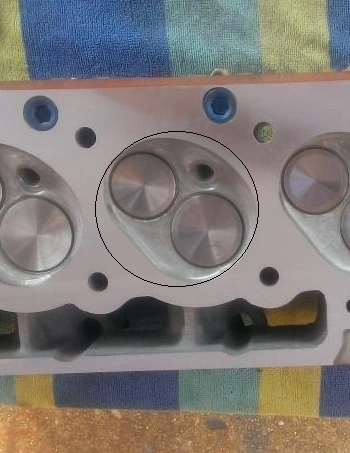

And one of the guys over at the ford six forum pointed out the obvious....I don't have an open chamber.
What I do have are tiny valves.....that is a 1.8, and a 1.5 respectively looking all big and sht.

That's the new revelation Joe,....I just discovered today that I DONT have open chambers,....See the pic above. All you need is some are between the top of the piston and the deck of the head to help promote a better squish. I got two small areas....I'm ok as far as that goes.

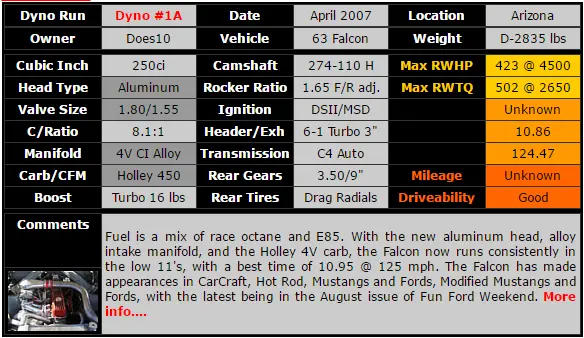

I've been told that this is a 450 WHP/550 WTQ project all along. There are other examples out there to corroborate that. but they all come up short when compared to mine, because for one reason or another,......they aren't close enough to pull a working example from.
Take this guy:
Now granted,....This guy is pounding more boost into this engine than I intend to, but that isn't really relevant.
Look at his dyno numbers. But most importantly, Look at where the torque is at.
This guy has an aftermarket aluminum head modeled after the stock piece, a flat tappet hydraulic cam, a small garret turbocharger (I think 57mm) and a carburetor.
I have an injected engine w/ a 66 mm turbo. With a solid roller cam. All things that I think are better than what dude is using.
(Not bragging here,..just making the point) Most importantly I have that head.

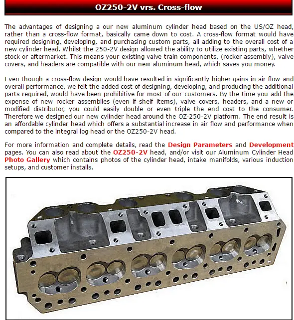

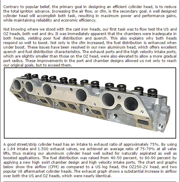

And there's this about that:
So....This guy is using a different head, a lesser cam and induction system..and he's still making stupid power.
Is it safe to assume that I'm gonna make stupid power too?:banana:

Now you just need to refine the timing table.... what I mean is figure out where peak torque is and pull a little timing, then increase it slightly after that. Ect ect.
