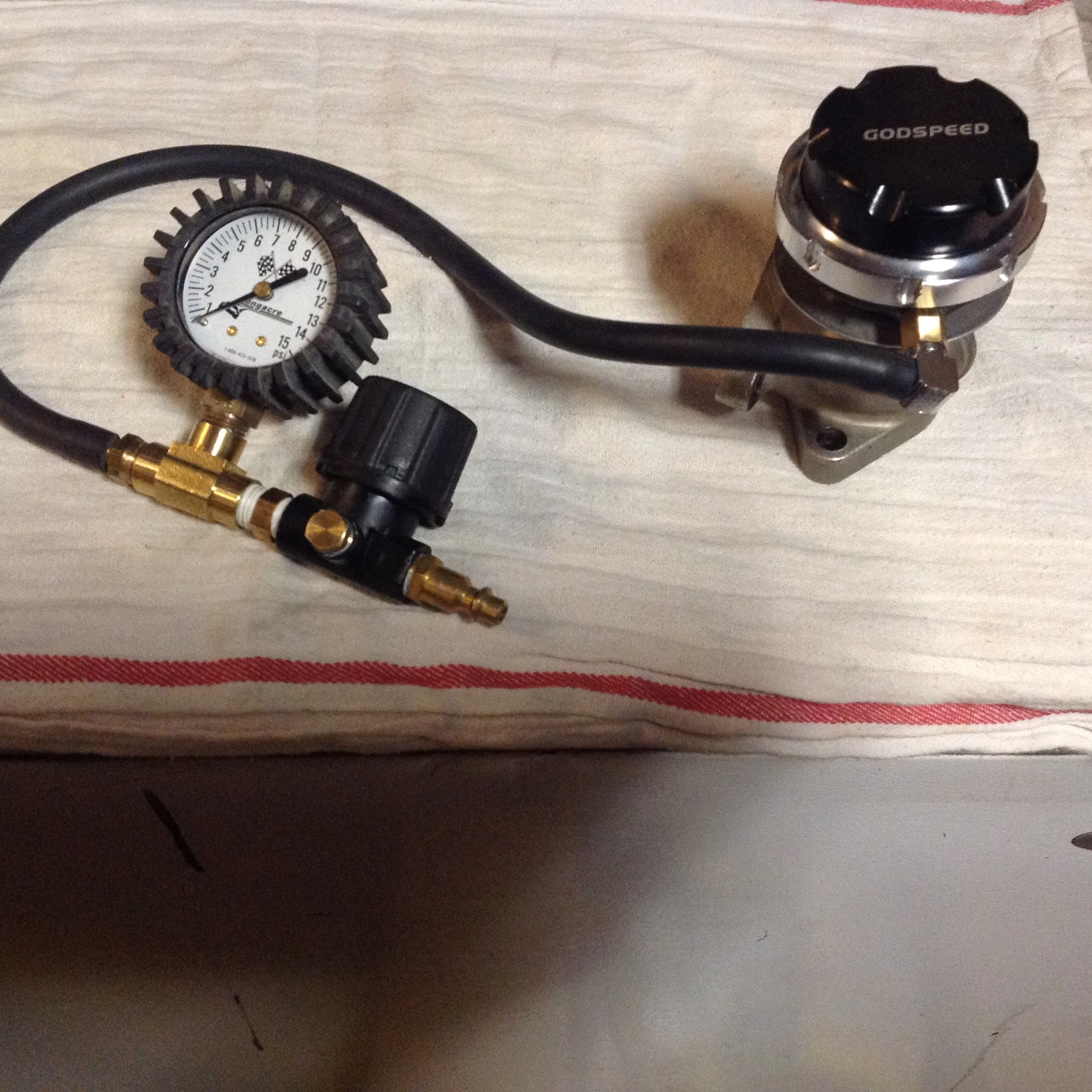

I google how to test an external wastegate spring using air compressor, watch the You tube video, and go downstairs to go about the pain-in-the-ass ritual of removing my Chinee Turbosmart copy wastegates.
Once done with that I go about cobbling together the necessary junk to make a regulator w/ a very accurate low pressure gauge to be able to see where these things start to crack open, and what pressure is required to get them to full open.
Now I have two tire pressure gauges from back in my drag racing days fro measuring drag slick pressure. These things are incremented in like 1/4 pound increments so I figure that this has to be the most accurate gauge I can put into this contraption.
So,..more scrounging around, and I find a piece of vacuum tubing and a hose barby dude, and I'm all set to check this thing.
I apply pressure and start to roll up the regulator...4 pounds, 5, 6,7,8,9,10, 11,12, (I'm hearing escaping air pressure) 13, and finally at between 13, and 14 p.s.i., these things start to move. It takes beyond the gauge reading to fully open them, all the while air pressure is bleeding past the valve and it's guide.
I know these pieces of crap are working at less than that pressure, so I'm now concerned that my testing procedure is somehow suspect. I switch the gauge from the longacre piece that I've pictured above to a Moroso unit that I also had laying around in a drawer. (Effectively killing off two barely used drag slick testing air pressure gauges,....but that's OK,.....I guarantee you that I'll never have a drag car again)
The test is the same.
I open the thing, and get the other springs on the off chance that I have installed the higher pressure spring....I haven't. Now the gate wont open at all based on the 15p.s.i that the gauge reads, and finally opens at some point well north of that.
So I decide that some of the leakage must go away with heat. As this piece of crap gets hot, some of that slop must tighten up, but it still sucks,....there's no way in hell that I'm gonna use a wastegate that is leaking boost pressure past it's guide.
This effectively kills the Monster for a long time. I haven't the freakin foggiest idea where I'm gonna turn over a rock and find the 600.00 that a new set of turbosmart 38mm gates are gonna cost me. I have to use them though,...the exhaust is built specifically for that style.
Here,....let me use this little dude.:doh:
The VS racing gates I have are Tial knock-offs. Which seems to be the most popular gate to copy. Viren is a real good dude and has had a lot of good luck with them.
I'll say I've got less in both BOVs and gates than the price you quoted for new turbosmart gates. Let me know if you want more info
Edit: I realize mine are vband flange and yours are not but I know for the money saved you could make that change work.
I'm just gonna bite the bullet and buy some precision turbo gates through amazon. They are two bolt flange just like turbosmart, and can get them for around 220 ea.
I know personally of a few guys having good luck with the Emusa eBay gates as well. They have 38s for well under $100 each. I won't knock going name brand though, especially on something critical like a gate. I just remember how expensive my PW46s and turbosmart BOV were for the cobra
