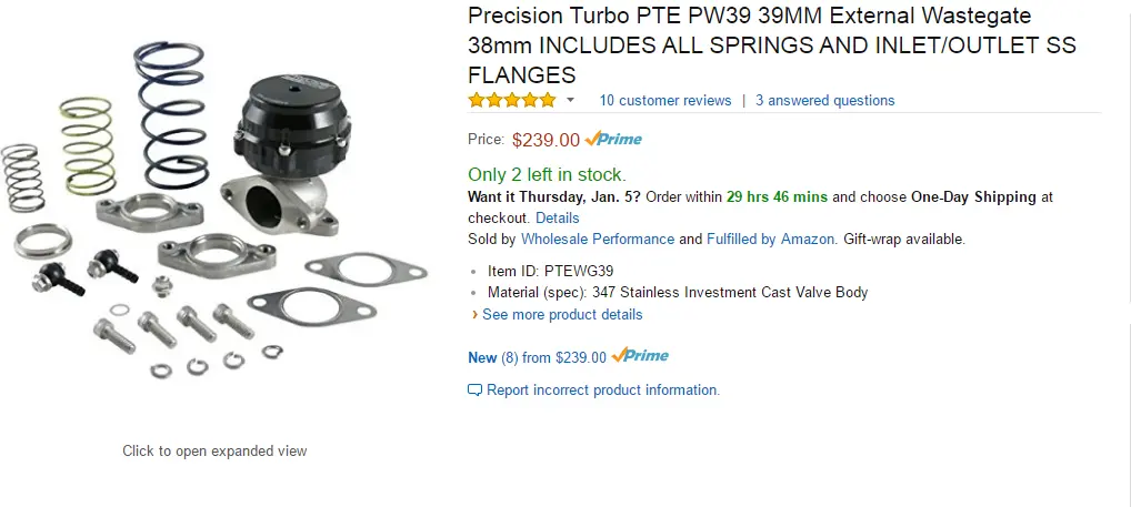

The Precision gates come w/ three springs, and real turbosmart units only come w/one. The precision unit is less money as well which makes it less painful, but it's still 440.00.
The only reason I may end up getting T-smart gates, and a single spring is the fact that I have my cool hard lines plumbed for that style of top dome. If they are tapped in the same orientation as the P.O.S. Chinee pieces, then they would probably be a straight conversion,....the precision pieces,......IDK.
I tell ya, now that I know that the car will live at 10 p.s.i. I should just do away w/ that stupid electronic boost controller, throw in the 10 pound springs, and tune it to that. What ever it makes at ten, it makes. Then I'll only have to line up one set of hard lines.

While tearing up the internet the last day looking at my different wastegate solutions, I come across Amazon. They are offering every single mfg's product at basically the most aggressive price. (trust me,....I looked)
The precision gates will force a re-do of my lines, but they are the best deal.
So,....American gates instead of the Chinee version that cost fully 1/4 the price. You have to wonder how they can cast, assemble, pkg, and ship a version of this for 59 bucks?
I'll have them in 2 days,....I'll install the 5 pound spring, and re-perform my little pressure test.
In the interim, be thinking about why I shouldn't put the 10 pound springs in and install them and be done.

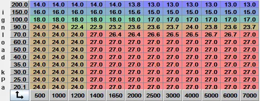

I want to try another timing table. Your timing curve seems to be like that of a early ....... Wait for it........
HONDA......... seriously.
I just got done tuning one, they need very conservative timing in boost even with low compression. By 15psi I only had 10* in the motor..... by 25psi I had 5*.
No joke.
:leghump:ing Japanese engine was an animal.

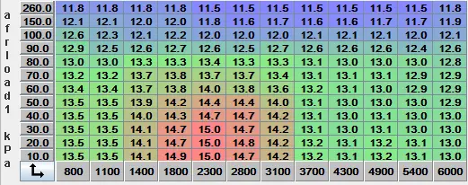

is there a way to add another kpa row between 160 and 200? In other words,...boost at 10 psi is 168.2 kpa on my tuning tables.
If we could set the AFR table into rows of 10 from maybe 130 up.....is that do able? Is it even necessary?
I was just looking at the datalog I had to compare against Collin's and because the rows are so far apart, once everything starts to transition through the table timing falls dramatically almost straight through the floor, and then the slope decreases to a more gradual retard when it's making boost.
You can't add rows, per se, but you can edit the values in the rows to add more resolution in the higher RPMs. You can just click on the kPa value and change it to what you want.
