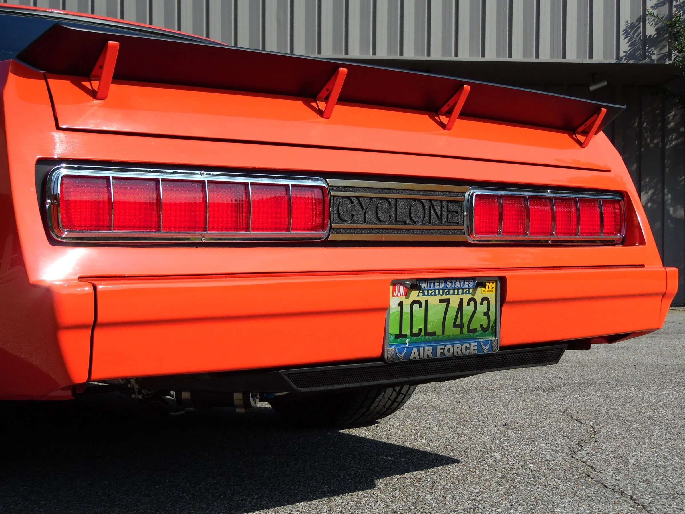

Im about done with all of the residue that collects on the tail of the car as a result of the duck tail creating that vortex back there.....the exhaust tip never gets noticed as it is,...it's on a short list to be replaced w/ a simple turn down.It's too early for all these questions. It's like I went back 30 years to high school. My only coherent thought is using an exhaust evac system is you're going to get more oil residue on the back of the car because the mist come out and will blow all over. Now, that might be good to discourage tailgating. From the description of your floor, I doubt that's a big consideration at the momento.
Im sure that the shape of the exhaust tip lends significantly to the megaphone exhaust note that comes out of this car....a simple 3" turn down will probably quiet the car down significantly...lets put it to a vote:Well, face it, your engine compartment is like fake boobs. Who even knew the chick had eyes!!

It's gone,...single, boring elbow now...waiting on the welds to cool, then gotta go get some high heat black paint, then,....washy, waxy shiny,...piktures..I like the exhaust tip
