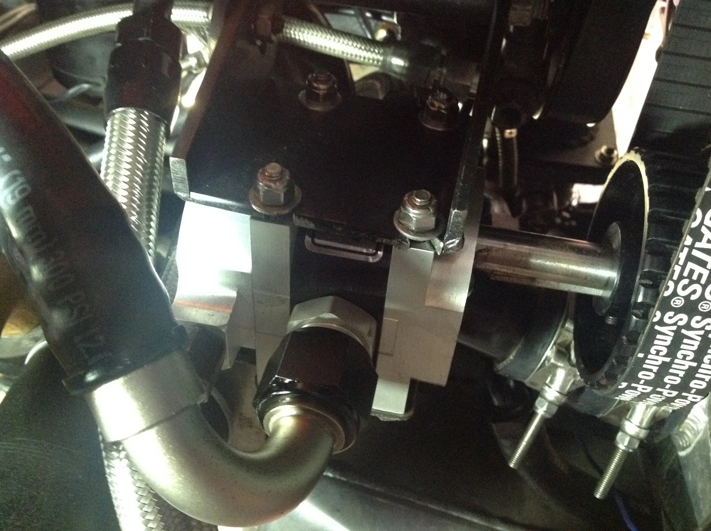

But first things first......I fixed my dangling oil pump.
Now secured by lock nuts, as opposed to regular pieces,..hopefully that'll never come loose again.

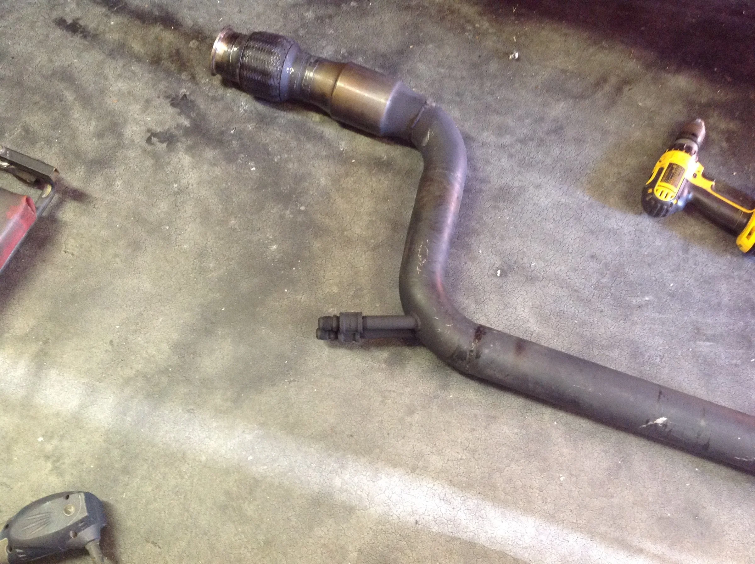

Then, I went about making the pipe nipples that I'll have to attach -10 hoses to. That required two big assed holes in my exhaust,..and then weld these dorky steel penise lookin pieces of pipe in at an angle that will hopefully be conducive to creating a siphon ( What's the law of physics here?......the Venturi effect?)

Ok mike, I’ve got to relate this to a paint gun.
Pretend your exhaust flow (pressure outlet that your trying to achieve vacuum from) is the air holes in the cap when you pull the trigger. If your fluid tip isn’t actually in that stream of moving air, when you pull the trigger the best it will do is to fill up your cap with paint. The fluid nozzle tip is actually sticking bairly out of the cap into the air stream where the vacuum of the moving air draws more paint out to atomize.
It might be better to think of the older style siphon feed gun for this example.
I don’t know for sure here, but maybe the tip needs to extend into the exhaust stream slightly like a paint gun.

Obviously,..I didn't extend my tip deep enough.
