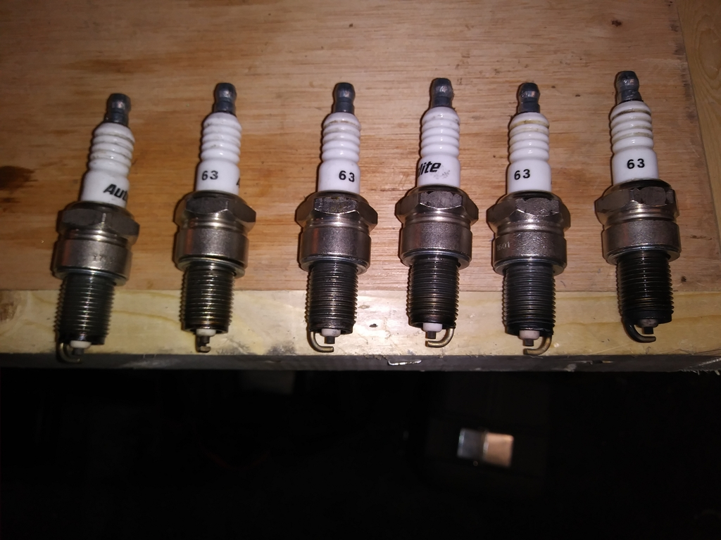

Examine, if you will Exhibit A.
These plugs are 2 steps colder than stock...This is the way they came out of the engine. Excepting #1, No oil,..no crusty fungoo,.....MOF barely any color at all....but then again,..they only have about 100 miles on them..The only thing going on w/ ol #1 is he's sooty,...it should be expected on a cold plug...
When I talked to the Autolite rep, it was his guess that I'm probably still one heat range too hot,...and I'll look into that just as soon as I can start ramping up the timing again....And all of this blah-blah should go to that point.

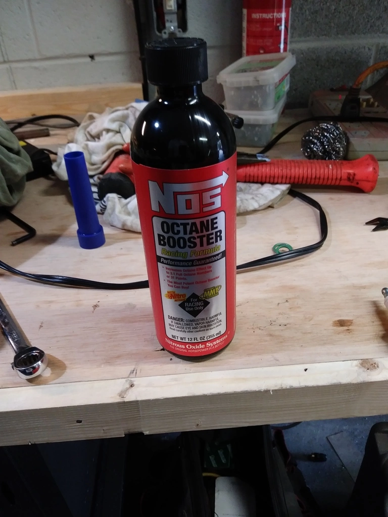

So,...I decide that inevitably water meth is gonna be my salvation....but I still had to try one,.....more,...thing.
Yeah,...it's in there....Says it is blended w/ NITRO-METHANE!!
Vroom, vroom, vroom,...!!
I'll beat the gassers and the rail jobs......I'll bet Little Ronnie and the Daytonas would've sang a song about me...
If they weren't dead.

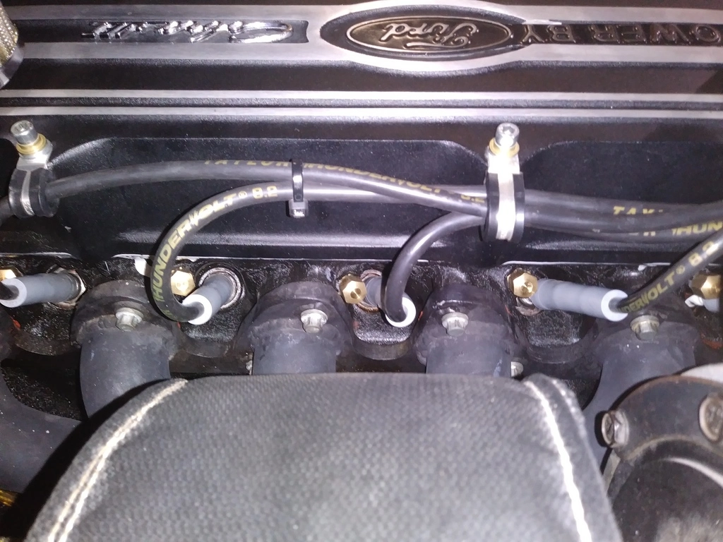

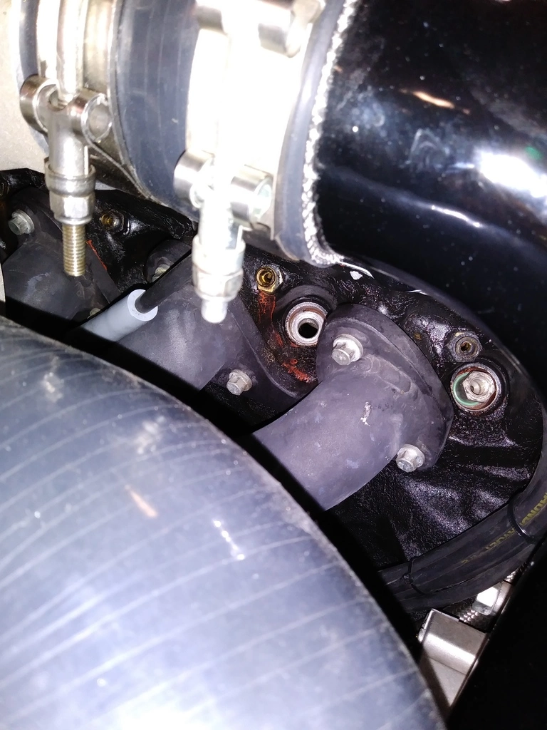

I had a leak. (Duurrrrr, that's an understatement)

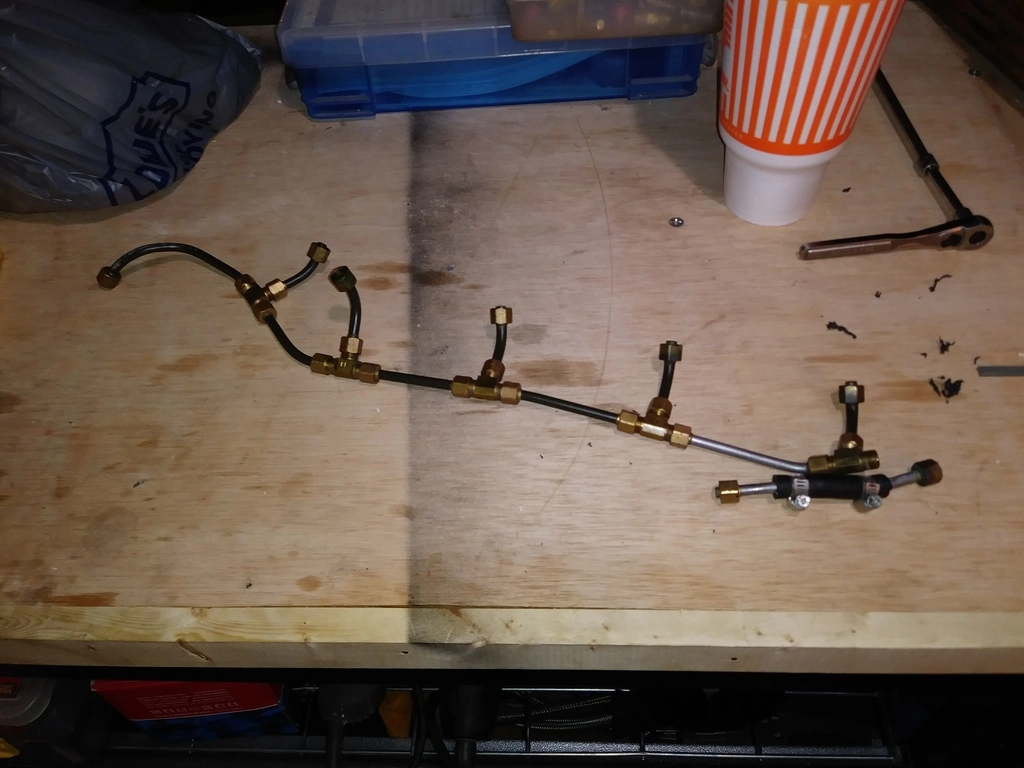

It was my brilliant decision to add coolant bypass lines to the top of the exhaust ports so that any air pockets that might form there would circulate back into my cooling system..All that managed to do was make it a pain in the ass to change the plugs.
So I removed the snag-u-lated mess.
That left me with those little brass compression fittings screwed into the water jackets on top of each one of the exhaust ports...Correction,...screwed, and glued into the water jackets....JB welded the piss outta em.....they aint never coming out.
So,...JB calls for more JB....I kneaded me up some two part JB steel stick, filled each one of those compression fittings, and screwed a cap on top of everyone of them..I've been waiting for that to dry before I pour the antifreeze back in..
Now it looks like this:

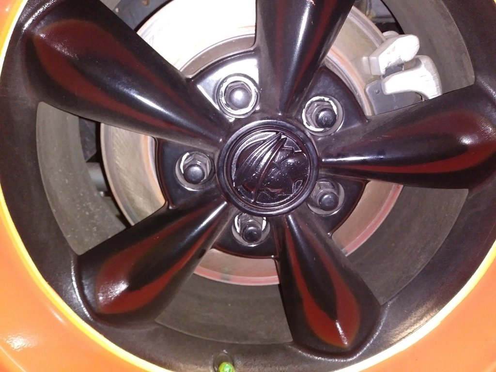

Lastly,..I installed my "Wrinkly Melvin Mercury" God head center caps....
Some day, when I give more than a rats red bunion hole that he's all wrinkly,..I may repaint him....for now, I'm gonna leave him.
