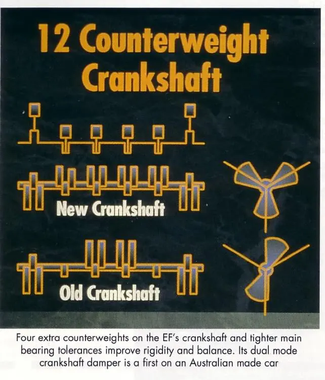

All alloy head sixes with side plates feed rather uncomfortable vibes up through the big in line blocks.
Don't forget, all six cylinder guys were supposed to be cardigan and knee high sock luvin' Ned Falanders types who worry about how to tune the 1-bbl. They question things like if putting a 2-bbl Pinto carb on their 250 might upset some vast eternal plan.
It’s very uncomfortable for V8 owners to then to have dropped back to tremoring Essex V6's and 250 in lines.
The reason for the 100% alloy case AOD and Mazdawg 5 speed gearboxes was because these ended up behind 3.8's, and they vibrated, and chatter and zizzed under load in a very un Windsor v8 manner. It upsets people right being the inner ear lobe, and I can take you to 200 posts on one forum that have six cylinder cars with non-standard ramp cams and stud mounted rocker conversions, and all the owner is worried about is how effing noisy the rocker gear is. It’s not because Mike is becoming an old fuddy duddy, it’s that the noise is real, and it upset 90% of all I6 owners that are stupid enough to Sex up a Six.
Ford Australia from 1978 to 1991 spent so much time with Keller's Swiss division on NVH. To others here, sorry about the language, but all that kHz power spectral density shEE+ is based on finding sound signatures which pi%% off computers, ECM, electric currents, knock sensors, and Soon to be 60'S.
The later Aussie OHC's (1988 to 1992) were especially Rowdy Cartwrights, and Ford Australia hired Tickford/Prodrive in England. Before that time, Ford Australia dicked around with iron webbing in the block, and they redcued the bore size to rasied the frequency of the six cylinder engines combustion process.
That's what the old Knock Sensor formula on sound frequency to bore size relationship does. And why all Honda passenger car in line fours have tiny narrow bore, long stroke engines...to remove unpleasant Pinto, Ranger and Mustang 2.3 bore size related engine roughness.
The Consultant Engineers Ford Australia used had years of I6 XJ40 Jaguar and AJ6 and earlier alloy DBS 4 liter Aston Martin engineering work to draw on, and in due course, decided to pull the 250 in line six based engine apart in sonic labs to fix the noisy and unpleasant "Eye Six" Vibes.
Result for 1993 was they ripped apart the 250 crank, and welded it up with a 12 counterweight crank. And the sump got made of either plastic or coated to pull out the noise.
The alloy heads, much rougher than iron heads, becasue of the drop in aluminums material density verses good old cast iron.
Probably, the Melling cylinder sleeves are vibrating more than a pure cast iron cylinder wall would, as well as the rocker gear, rocker studs, and tie bar lifters.
Fords USA solution was the Ford 240/300 camashfts ramp angle. Instating that spec on a your roller cam, with whatever cam operation you can manage, will probably help a lot.

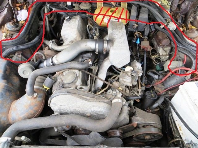

Of course, the finger came:nono: out when I suggested a Lincoln LSC or VII BMW diesel engine top firewall "NVH Ramp".
