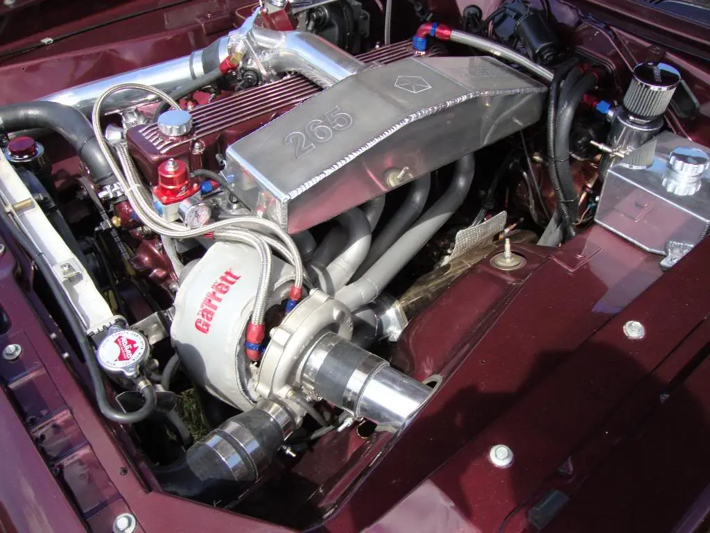

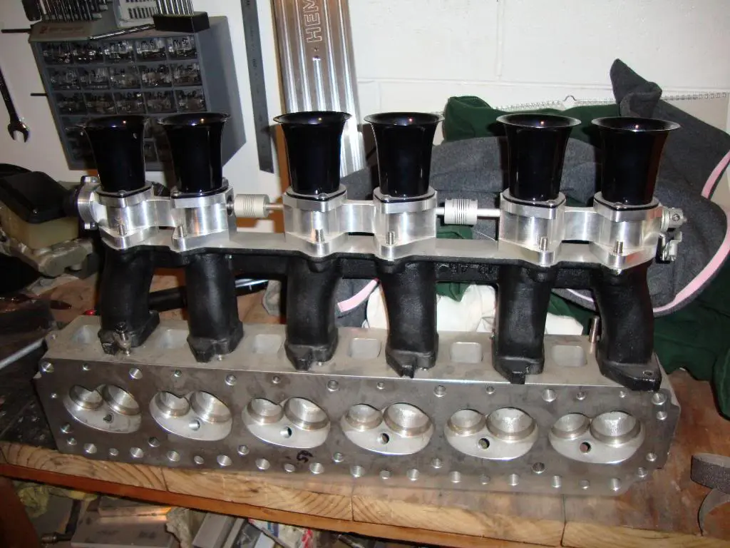

The best option is Independent runner without the common plenumb.
The Hemi 6 guys have an alloy head and Weber to ITB throttle body adaptor for the 2.2 sq in intake runner head, and none of it lines up.

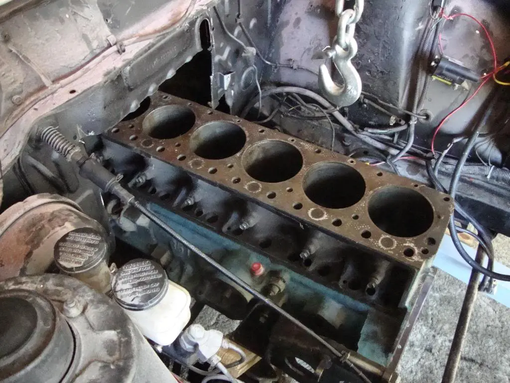

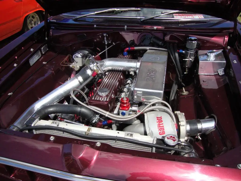

The D-series Hemi block designed in the US has a strange look of your modified 250 block. Here is a 6 cylinder Hemi 265 block in a Toyota Corolla KE30. Oh whata feeling!

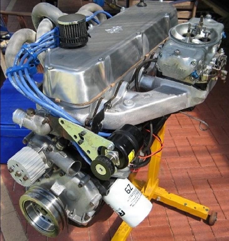

Most of the Mopar 6 Pack Hemi 265 guys down here copy the Ford Cross flow and BMW Fuel Injection intakes anyway.
The horsepower will be well, well over 300 hp net with that Tighe cam and the compression you have. Ivan Tighe cut his teeth on Jag XJ-6 cams, so Dean Tighes cam details are about as good as you'll get anywhere.

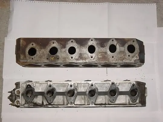

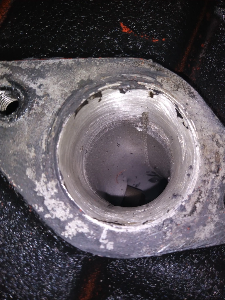

Uncorked, the stock head flow figures go way up. The factory paltry 145 cfm at 425 thou lift flow rate goes right up over 215 cfm with 525 thou valve lift and just a little port cleaning up. Most of the power gains are due to the stock 264 and 435 thou lift cam taking so much peak cfm off the head flow,
the rest is due to the already great port angles just loving some extra port area. So that de-dagging and grinding of the ports you had done will yield a huge increase in CFM with the 525 thou lift cam.

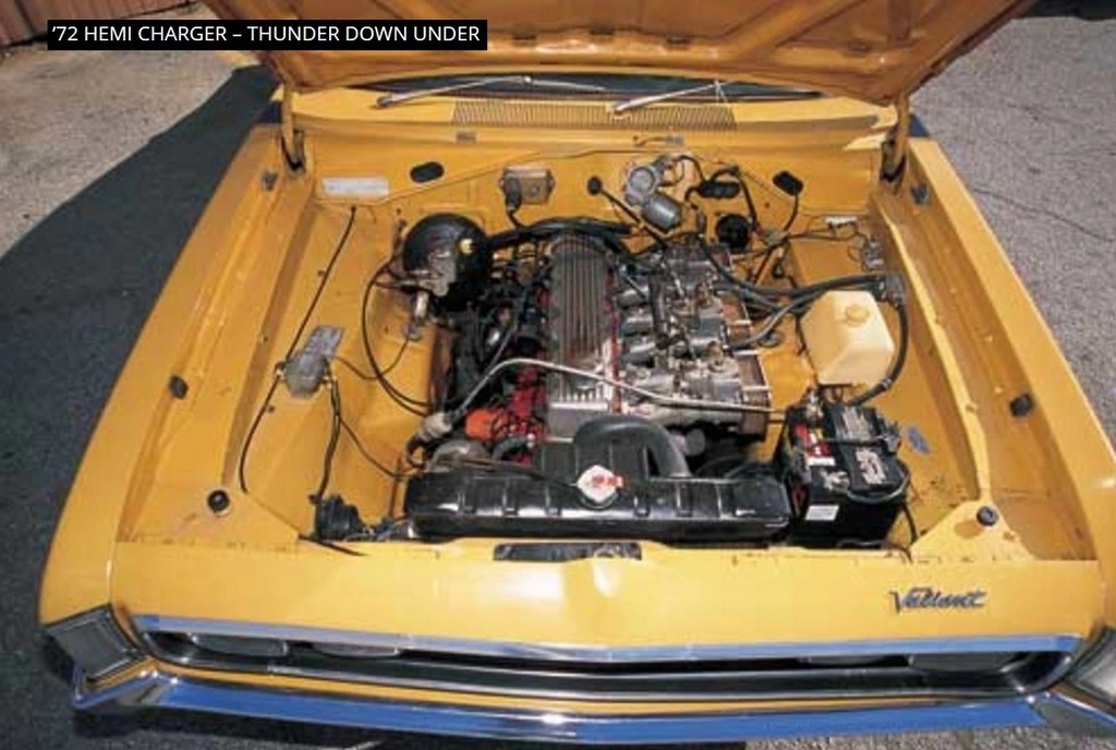

the stock factory E37/38/48/49 Charger and Pacer 265 Hemi Six Packs, 248-295 hp net proven.

Factory, a 0-100 mph time of 14.1 seconds! It was only above 120 mph that the deficincies of a 3.5:1 axle ratio, 86 cubic inches and two less cylinders showed up. As stated, Leo Leonards 265 made 295 hp net at 5300 rpm , no modifications allowed, (302 gross claimed), and according to Mick Webb in 1988, the best 1971 351 4V HO engine with 505 thou lift cam and 300 degrees duration made 350 hp net on Fords dyno.
Modified, maybee 293.7 hp at the bags, with perhaps 370 hp at 6200 rpm on this 9" axled 4 speed BW Single Rail specimen. Despite the claimes, the 9" and 7-7/8" axles show the same drive train losses.
