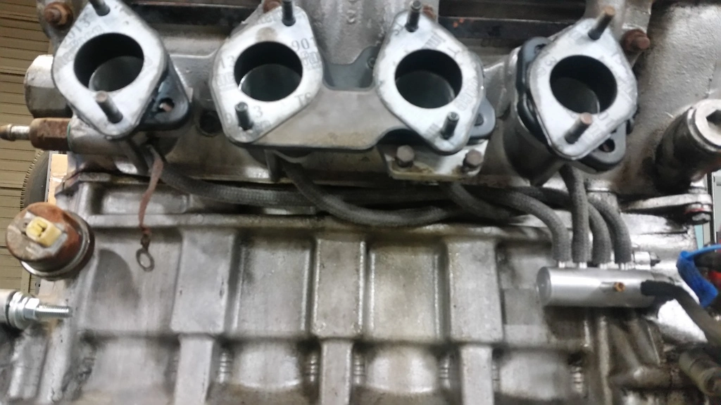

Mike I think individual runners for each TB would perform the best and give some runner length, no common plenum. You can then tap each runner as stated above and hard line them to a vacuum resorvoir, this will act as a damper for the the map signal so to smooth the pulses.
A common plenum will give you 0 zilch nada for runner length and hugely effect the low speed torque output methinks
