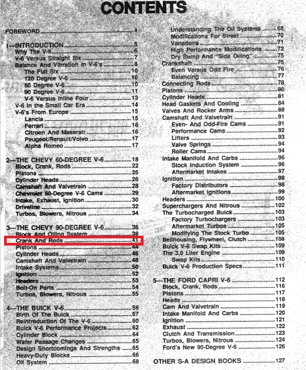

IIRC, Page 41-43, Chapter 3 on the 90 degree Small Block Chevy V6.
Grumpy Jenkins said that the flange was just a positive location and casting part that could be removed altogether, the way I read it he implied the two V8 rods but together in some cases. What he didn't say was this.

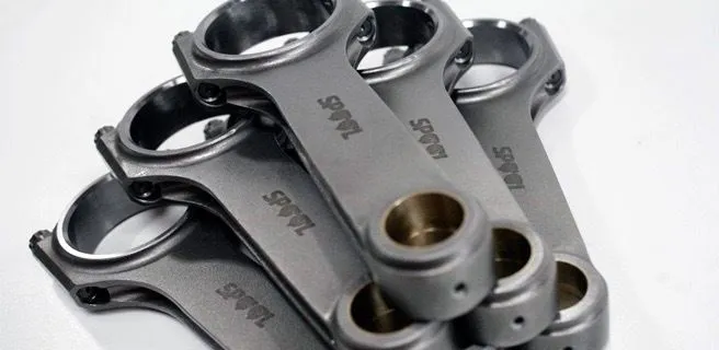

Or,.....I buy those Aussie H beams that look like they'll fit directly from Mace in Australia (allow 4 weeks for delivery)
Why would I need a rod rated to 1200 hp on an engine that won't make a quarter of that power ?

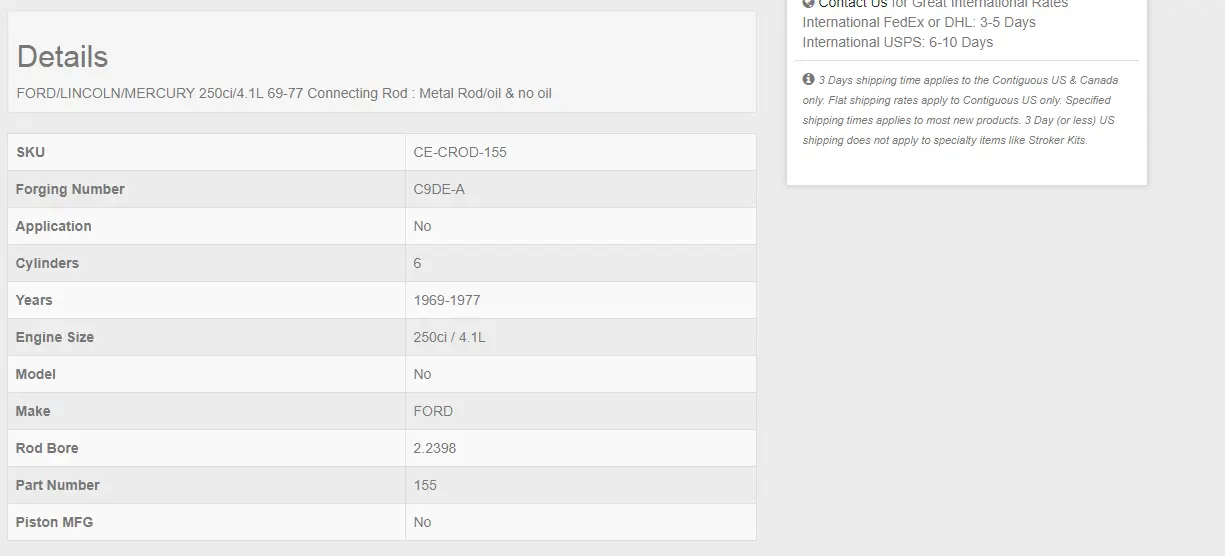

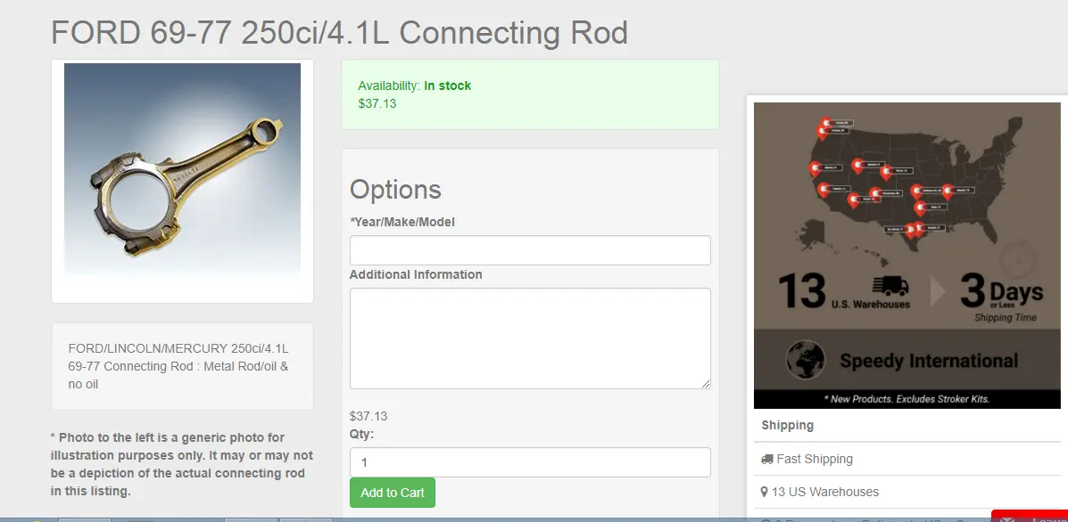

Or,....I can actually buy the stock rod that is forged for 37.00 ea.
And I'll have to transfer my bolts out of the cast rods to the new, reconditioned ones,
