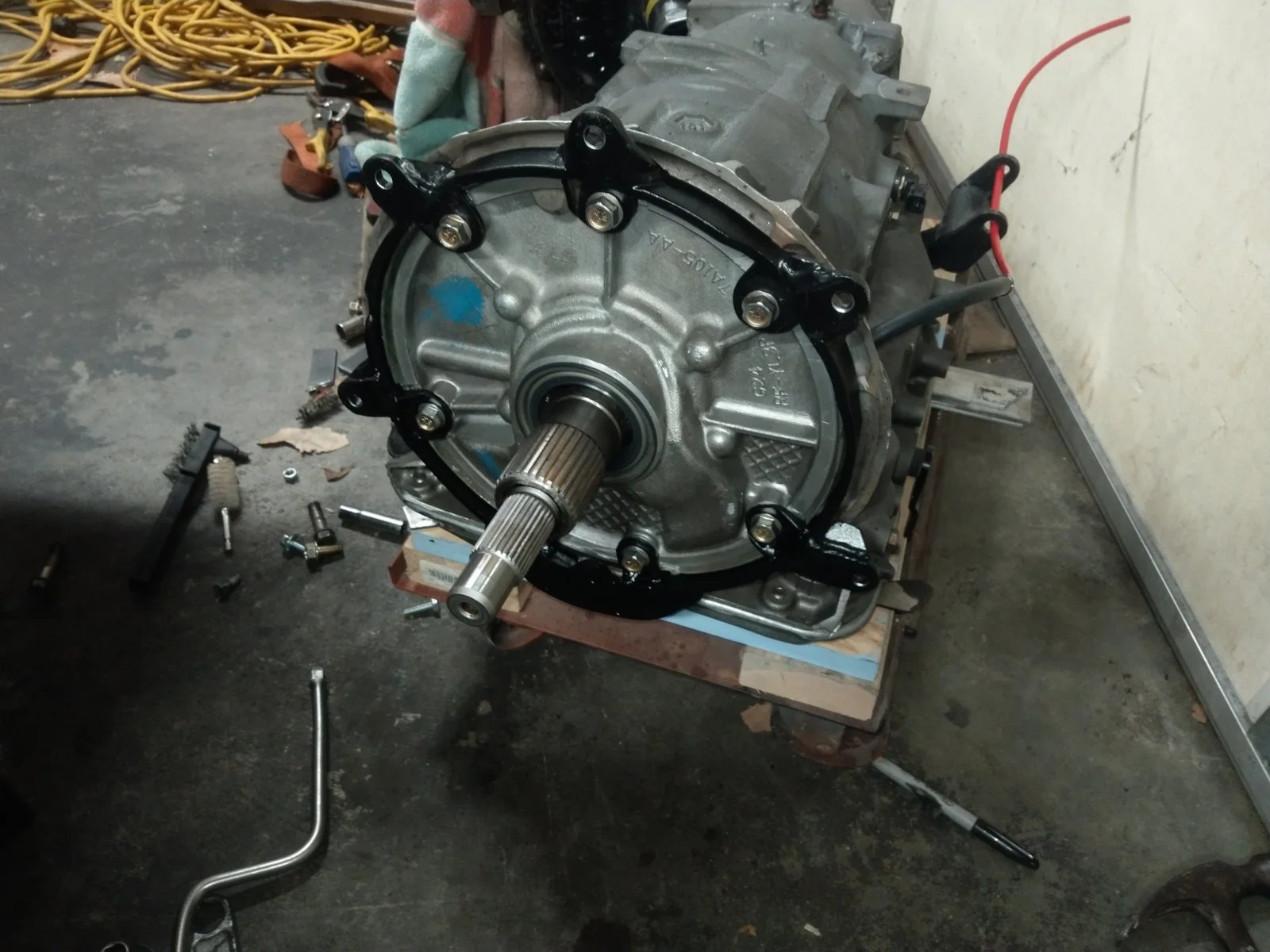

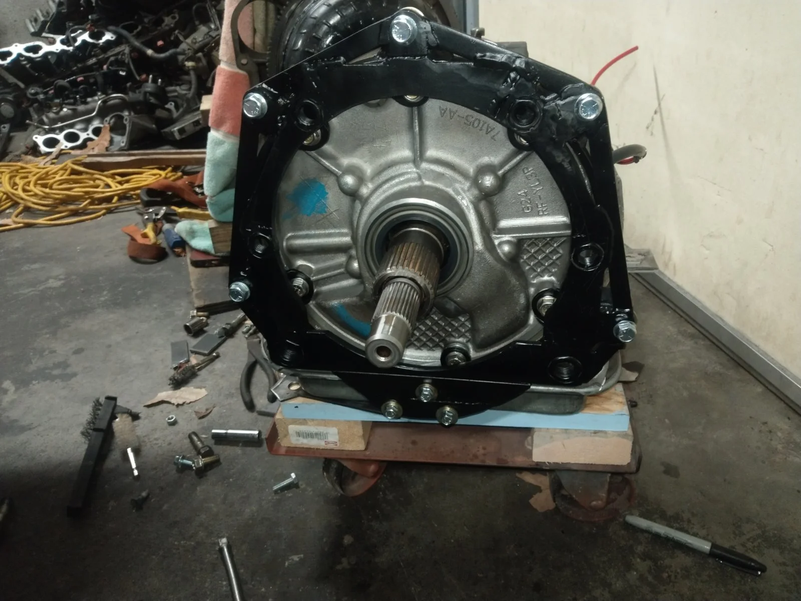

Really? So now I have to backtrack because you can’t be bothered to pay attention simply because you’re working a weanie assed 80 hour week?
Panty waist.

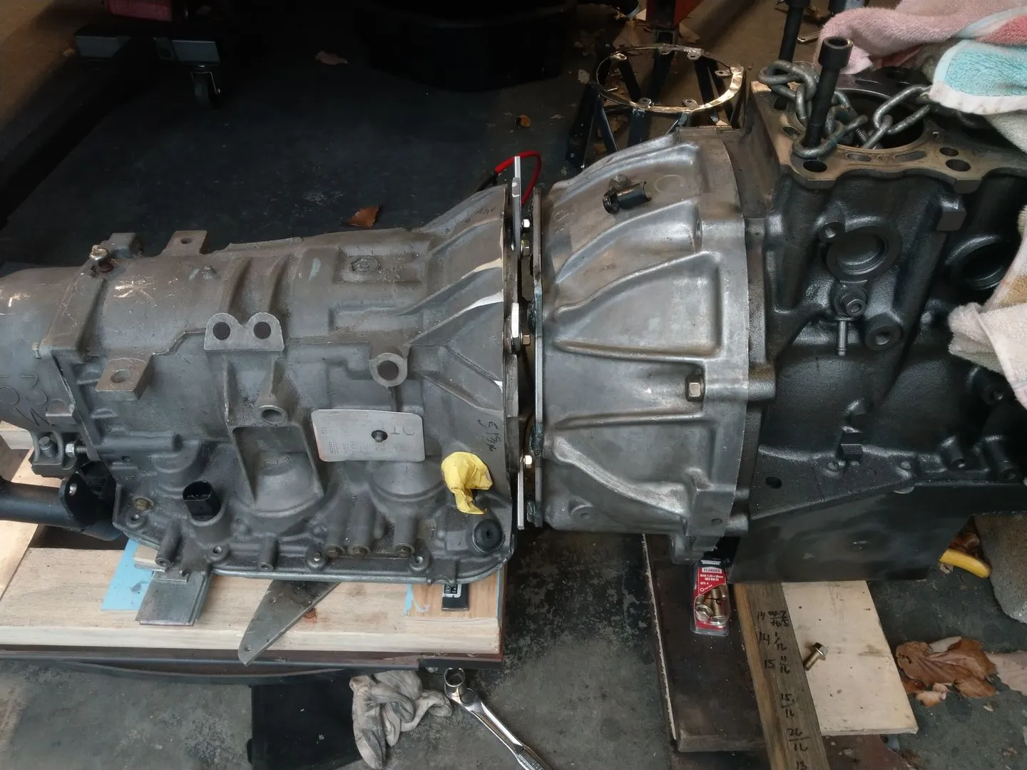

you must’ve missed all of this then ?
No jig, No fixture of any kind except the short block on the ground, leveled, and the trans on a rollie cart, leveled at a height “ guesstimate “ for the input shaft.
The thing could be cockeyed up/down, right/left. Off by thousandths just enough to prematurely wear the rear main, or the front pump bushing out. OR, ( if i’m shooting for cataclysmic failure) completely rattle the mains out of it from excessive harmonics in a very short time. Like my buddy @HotFox thinks.
Or..
Or by some weird fluke of luck, I got all of that sht right,....And it’ll run till I decide to change it all out for some more chevy sht.
Either way, If I have the adapter, the fully built 4l60e, the new shifter gate plate, and a converter sitting somewhere...it might not be 8 months before the thing runs again.

Yeah if you were in Michigan I would take that weldment and first beat you over the head with it and toss it in the trash. Then take the trans and bell to a buddy, he has access to a CMM after hours. He would measure every critical bolt hole, center point, dowel and put into CAD. I would then create a detailed solid model 3D adapter using Solid Works CAD. We would then either water jet or CNC or a combination out of aluminum. Tadah! The only 2JZ to 4r70w adapter!
Unfortunately there is the small problem of the 1000 or so miles between you and me. If/ when the adapter fails then you get to say I told you so...
( along with jeff)
If that thing lasts till i decide to upgrade,...Until that time comes..
I already have the only 2jz to 4r70 w adapter.
