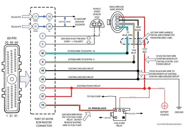

Wire side 60 pin computer wiring harness connector
a9x-series-computer-connector-wire-side-view-gif.71316
Computer side 60 pin computer wiring harness connector
eec-iv-computer-connector-for-5-0-mustang-gif.88243
If the idea of moving & soldering wires scares you, here's a list of compatible Mass Air wiring harnesses.
