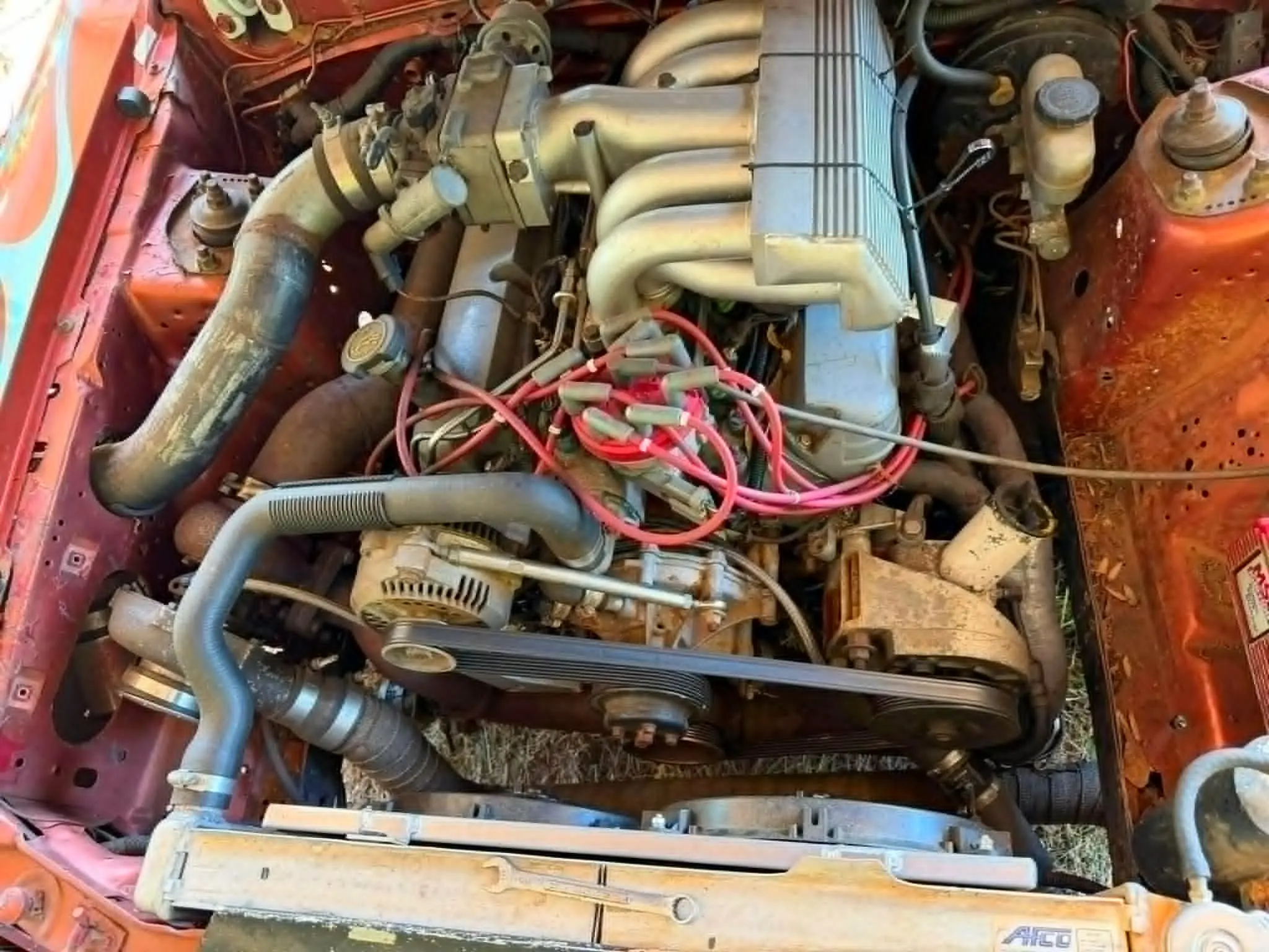

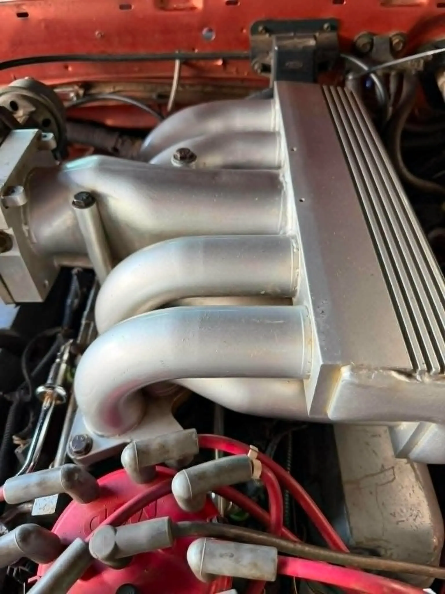

After the transmission debacle (I posted in my other thread. I'll update here soon), I have a guy wanting to trade me a tubular GT40 intake upper/lower and $200 cash. That's for a Tremec 3550 that needs a rebuild, bellhousing and Pro 5.0 shifter.

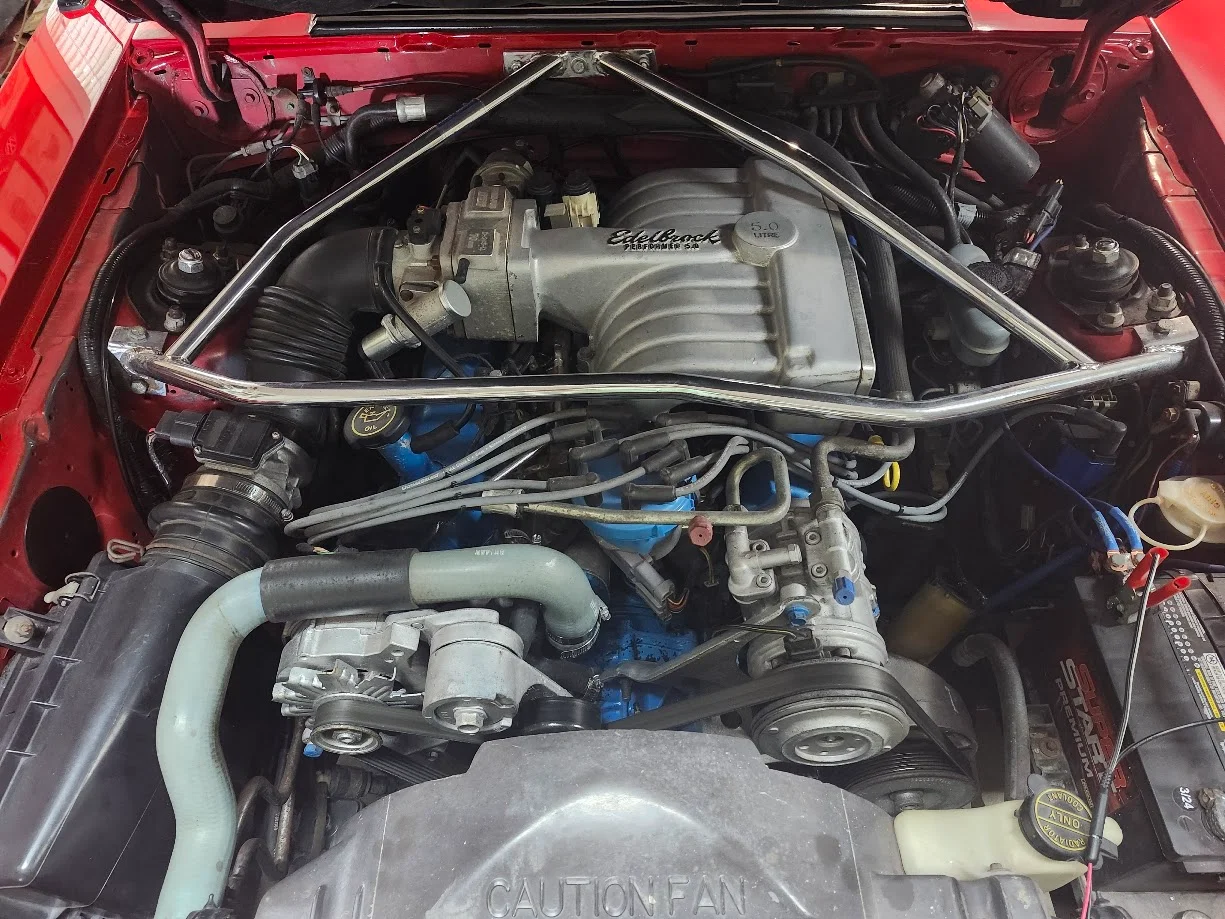

I already have an Edelbrock Performer RPM and I know it flows better and makes more power up top. I also LOVE the look of the tubular GT40, and I might gain a little torque.
Should I make the 3550 go away and grab it?

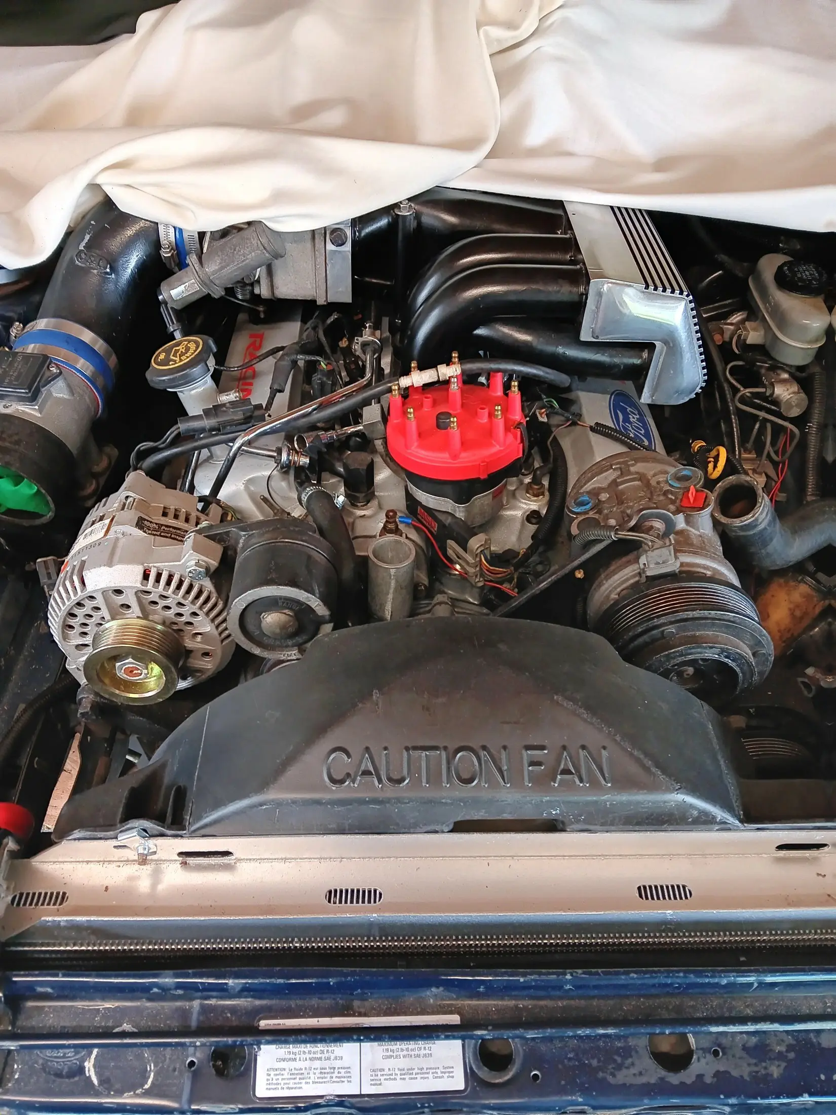

That's a tough one, but if you ain't using the trans and those tubular GT40s are flat sexy. I could dig up a pic, I've had several including the one under the hood now.

The Edelbrock one you have will outperform it. Unless you need an intake why swap a 3550 for it? The 3550 is worth more than the intake any day of the week. I’d hold on to the trans and find a buyer as you will get more money that way. Just my .02.

Are you going for that 1/100 of a second faster at the drags?? Or do you want the COOL looking intake ( with more lower end torque you said) that would make your car faster on the street?? Let me think

With the aluminum heads, cam and exhaust you need to stay with the Edelbrock intake as the GT40 will hold the combo back especially if you have decent rear gears.
I had two 306’s with the following builds:
Ported iron DOZZ heads, Porter Cobra upper and lower, and Comp Cams cam - 250ish rwhp & 240ish ft-lb of torque
Ported Edelbrock Performer RPM heads, ported Edelbrock Performer RPM II upper and lower, and Ed Curtis custom cam - 290 ish rwhp & 280ish ft-lb of torque
Both combos were dyno tuned with an SCT chip and had 24 lb/hr injectors, Pro-M 70mn Bullet MAF, 70mm BBK TB, full exhaust, T5, and 3.73 gears. Both had great idle characteristics, drove amazing on the street and would pull to the 6,000 rpm chip. The second combo made more power (310ish rwhp & 300ish ft-lb of torque) when I later switched to an 80mm MAF and 42 lb/hr injectors.
Just trying to give you and idea as to what you can do and still have really good driving characteristics if you are willing to get the car tuned which it sounds like you are.
