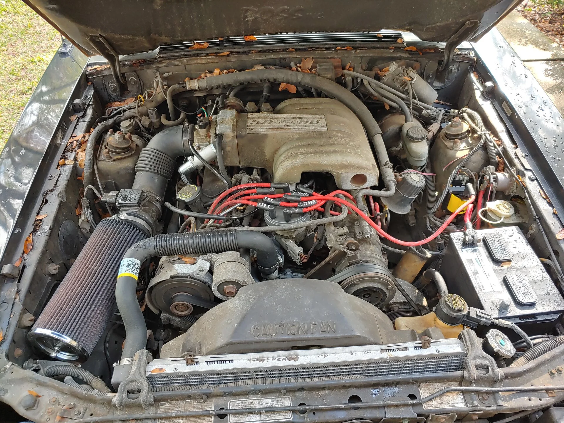

Get that doghouse cleaned up and lets go. Good car at least you dont have a sentimental piece of crap like some. Well worth fixing , not to mention its like a buy and hold mutual fund. Slowly going up in price
Reactions: Habu135
No, it's supposed to have the exposed fan blade that will rip your fingers off or catch your neck tie.
Who wears a tie now anyway? And I thought alternator and generator fans were Darwin Award devices. It would still be bad to get a finger or tie in between the belt and pulley. My 3G alternator does not look much like that, and I’m used to seeing them on the engine bay pics on here. It just looks foreign.

General karthief – I need to tackle the leaves in the yard this weekend, so I will get the engine bay first. I prefer to call the paint job "custom designed".
Kiddiccarus – are you jealous of my length? As for work, here’s what I can recall: 373 gears, underdrive pulleys, BBK throttle body, H-pipes, intake filter (obviously). I don’t think previous owner did much either. As noted below, ether was not the solution.
Potomus Pete – Got it. Leaves first…then dirt. Someone else replaced hose so I can’t speak to the protector. I can probably hook you up though! Wires are Ford Motorsport.
7991LXnSHO – I recall replacing the alt a loooong time ago. I would have purchased from Advanced or something like that. Not sure why it looks as it does, but I don’t wear ties either so I’m not concerned right now.

I see an alarm horn with a cut wire. Might that figure in?
