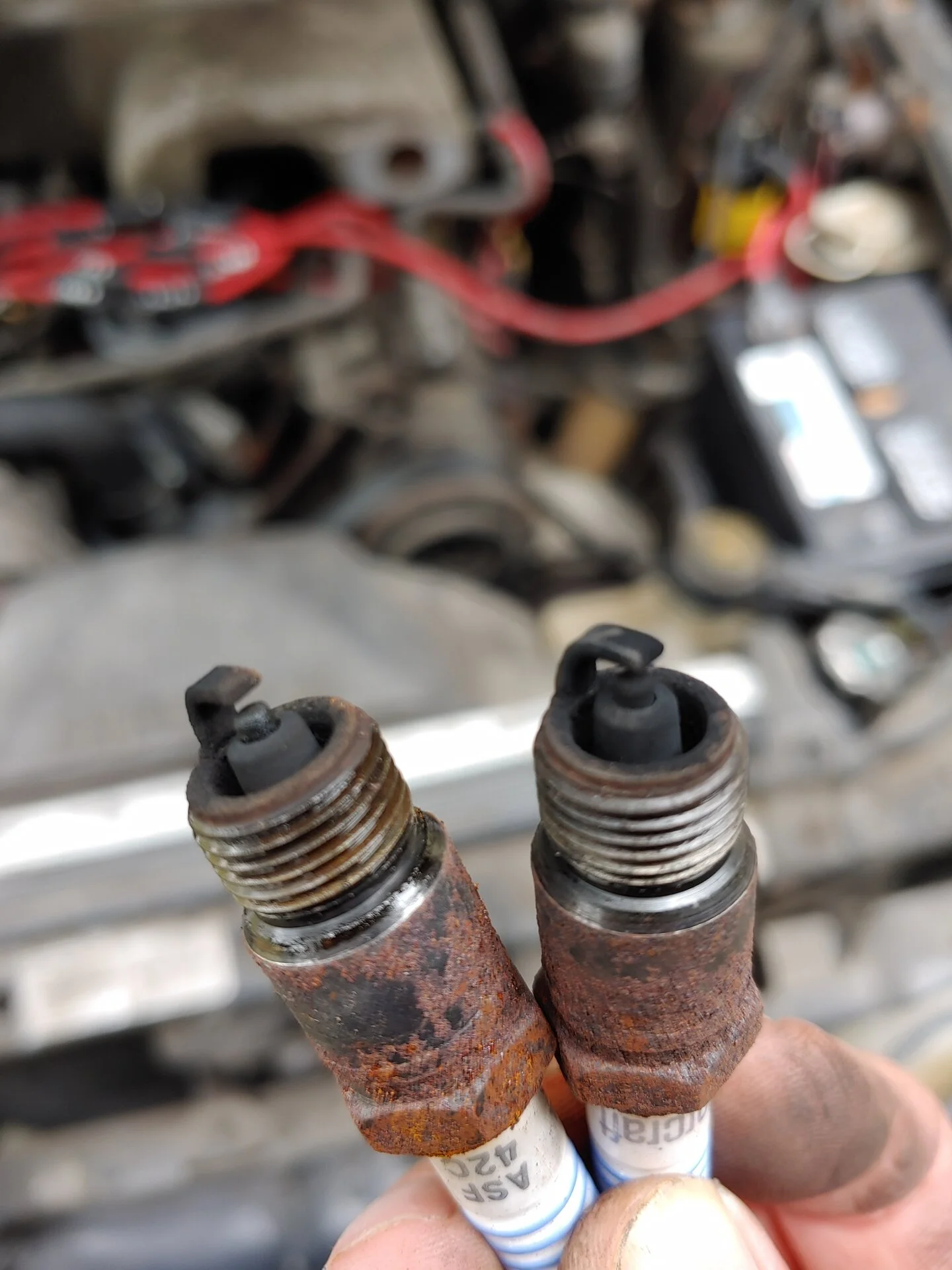

Floored it, cranked it, no good. Cranked again without peddle, no good. Removed two plugs and smelled fuel. Also noted heavy carbon. Are these worth cleaning or am I better off just replacing? Any recommendations on type or are the Motorcraft OEM plugs sufficient?

Standard Auto lite, Motorcraft, NGK/Delco are all good plugs. I would not spend the money for anything fancy at this point.

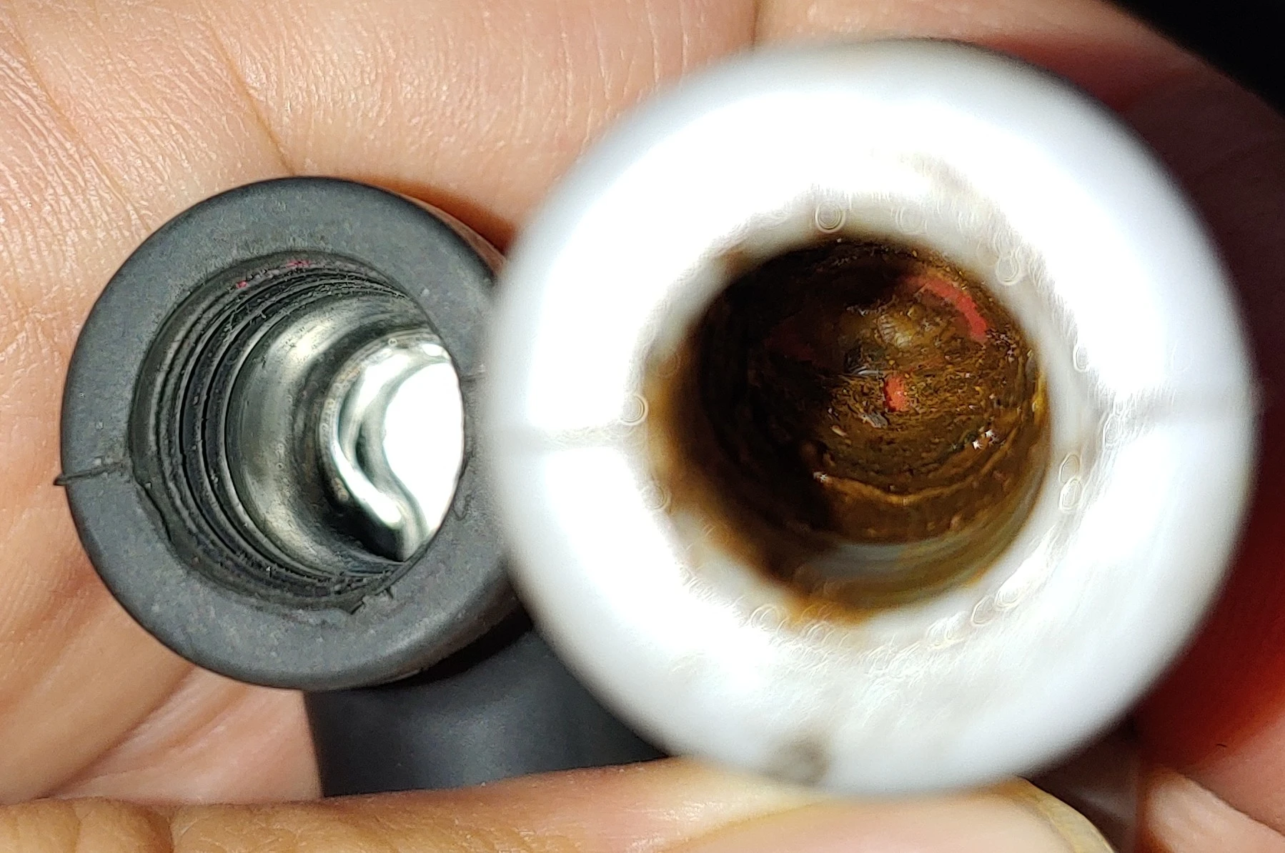

Got new plugs. All old ones had heavy carbon deposits. Noticed one of the wires at the plug was severely corroded. Tried to clean it but not much luck. Got everything installed and......fired right up! Sputtered a bit but I assume it is a bad connection at the corroded wire causing misfire. Got a new set of wires coming, then I can assess if there are other issues.
