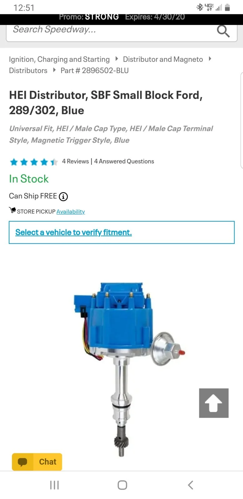

This distributor is from Speedwaymotors.com. It needs a different gear to run in a newer HO engine. It's only 60 bucks. It comes with a coil on top. No more coil wire running from the fender apron over the front of the engine.
Reactions: revhead347
^^ good god I hate them things ^^^ but he is right, they are stupid easy, and forever reliable.
