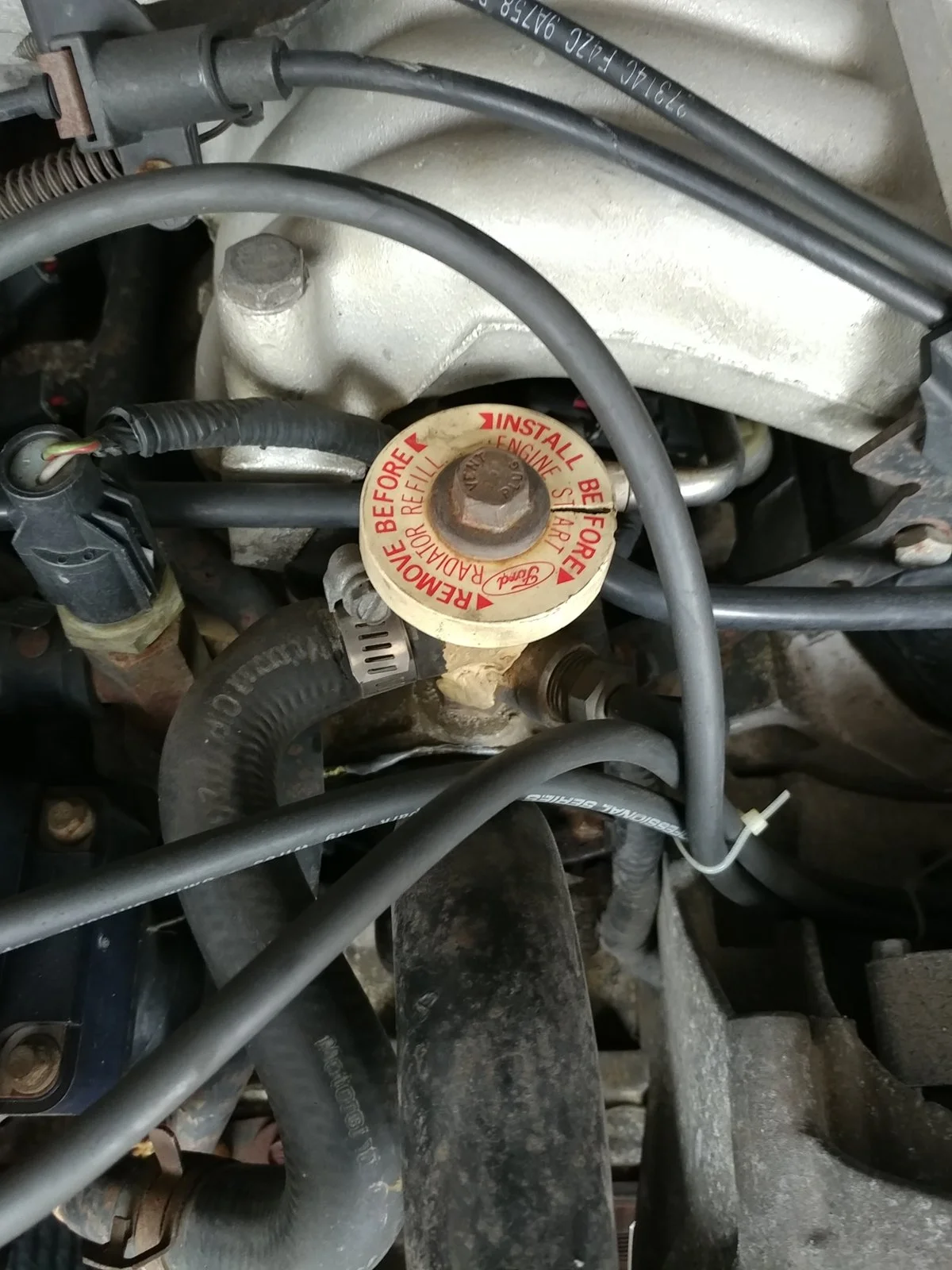

B U R P the V6.... (94-95 at least)
in the center of the engine is a white ceramic looking ring that has a bolt on top. That is where it has to be burped at.
1. remove the bolt
2. fill the coolant until it comes out the hole
3. replace bolt
on these you can not just add coolant like other cars, you will have to do this procedure each time or that temp gauge will peg.
