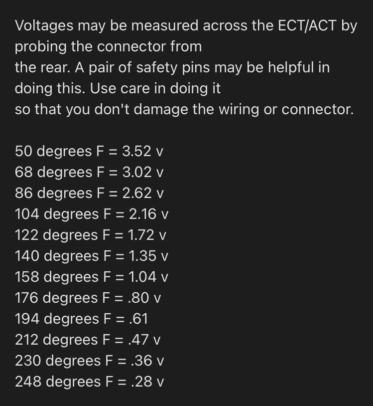

The previuous comment talks about testing the ECT sensor, well the sensor is fine and I started checking the wires in its plug. Upon disconnectin the sensor I opened the switch and checked the voltage in the plug. As far as I know one wire should read a 5 volts signal (pin # 7 at the ECU) which it reads correctly. the other wire as far as I know is ground (pin # 46 at the ECU), well just for the sake of it I measured voltage and it gave me 0.45 Volts. And then I measured voltage in between both wires placing the positive lead to the 5 Volts signal wire (7) and the negative on the supossed ground (46) and had a reading of 4.54 Volts. After this I connected pushed the connector onto the sensor and took a reading, it gave me 2.93 Volts on a stone cold engine @ ~ 74.5 degrees F ambient temperature which more or less correlates with the ECT Temp/Volts chart.
Is this correct? My biggest question is why do I have voltage on the wire that supossed to be ground? should I be worried about this specific reading, or should I just disregar it???

46 is Sig return, ties into all the sensors, usually burns the trace if it sees over 5 volts. What your seeing is pretty normal for a 5 volt sensor, I don't know if the temp - readings are correct off hand though but looks normal.

I just monitored the voltage at the ECT sensor during a warmup cycle and the readings are very close to the reference chart to within 0.05 volts. So I don’t think my temperature sensor or wiring is at fault as to induce that terribly low MPG. So now to another possibility and really not too many left IMG_1064.webp
