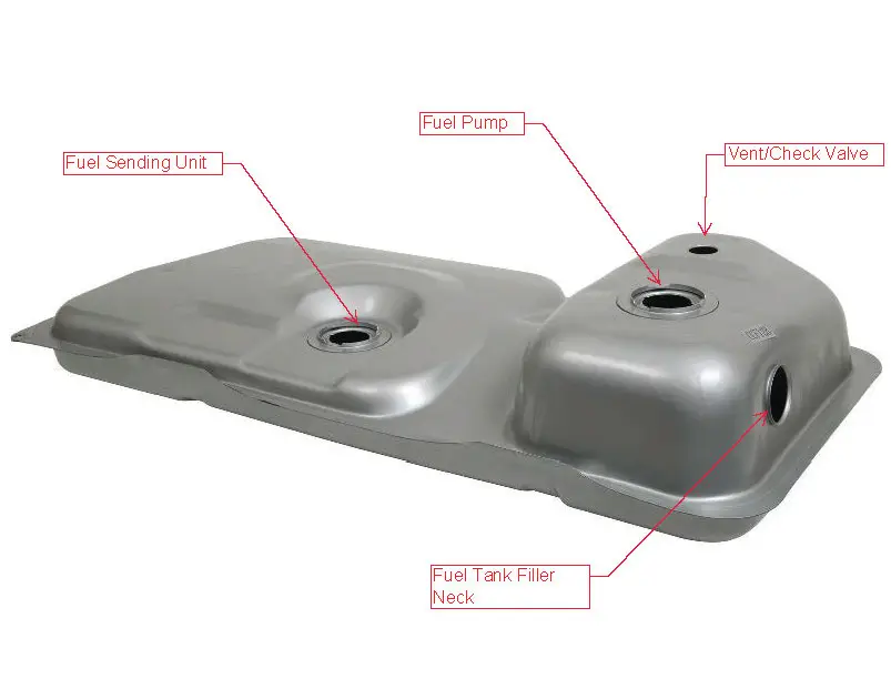

Check valve is on top of the tank, one way valve, lets vapor out through the charcoal canister when filling the tank and relieves pressure at high temps, and when the solenoid is activated pulls the vapors from the canister, all this stuff is at or below the level of the tank....'cept the filler neck, you don't want to fill all the way up the neck, pressure pushes vapor AND liquid into the vent line eventually soaking the canister.
This is all theory of coarse, I never got any farther than 'shade tree' mechanics.

Fuel tank layout:
Reactions: PonyGTrider

Ok I understand the concept, so that means my check valve is trashed? My understanding is that the valve is a one way (out) valve but I can blow inside the tank and the fumes go out too so I don’t think there’s a check valve and if it is there then it is broken. Is my assumption right?
No.if you're over filling the tank.
blow air into the tank, air comes out vent tube, all is good
blow air into vent tube, air enters tank, may not be so good.
Don't use compressed air, it will over power the hoses and the valve,
Now there's members here that are real mechanics that may have better advice.

I was just reading an article related to this concept and now I'm not sure what is a fact.
"I did a little research and found that the tank breathing valve allows first the relieve (Exhale) vapors caused by motion and heat but also it is a breathing valve (Inhale) air as the fuel tank gets empty to avoid implotion" So is it a one way or a bypass valve??? I'm confused

My understanding is the gas cap allows air into the tank and the vent on the top of the tank is in fact a one way valve.

Negative, that’s the whole purpose of the EPA (I think that’s what is called) regulation of a sealed gas cap so no raw gas pollutes the air. That is tested at the anti-smog verification stations.
