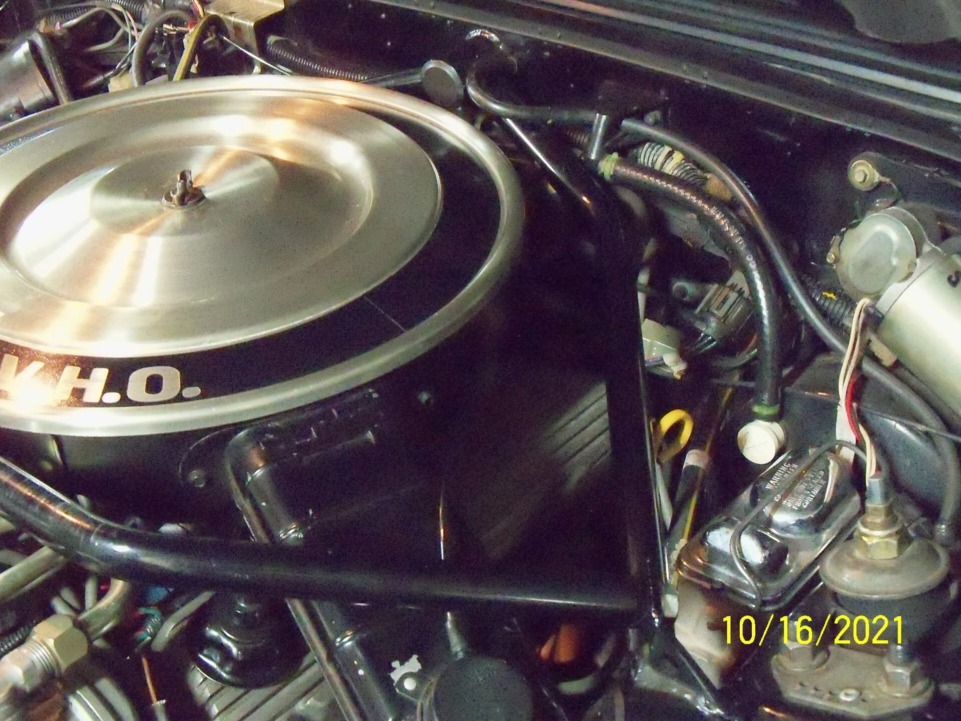

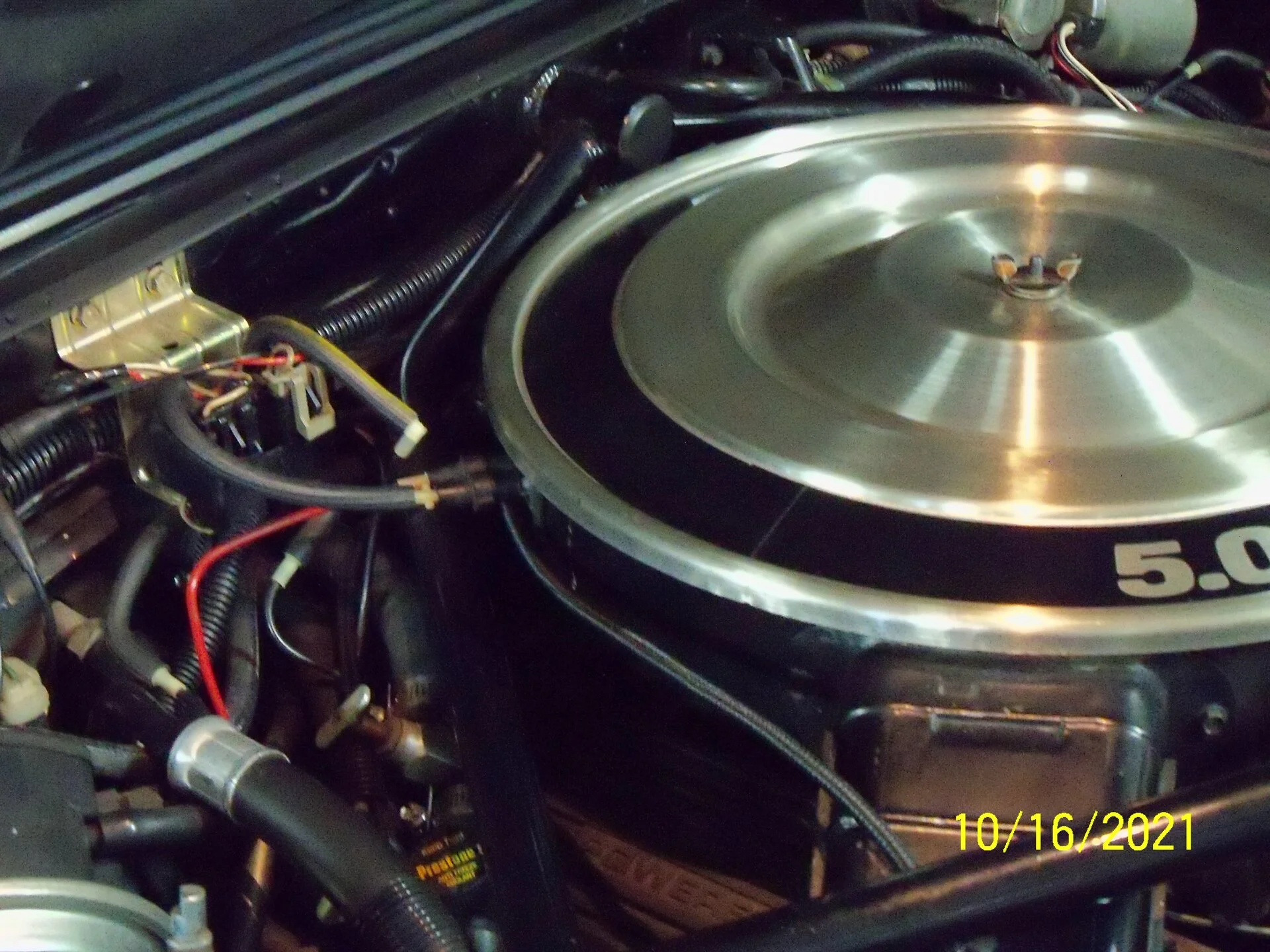

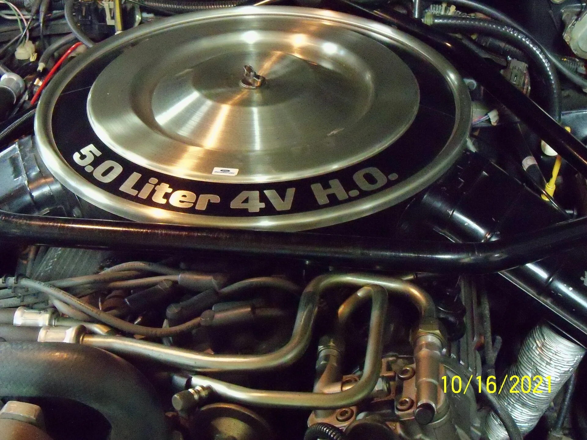

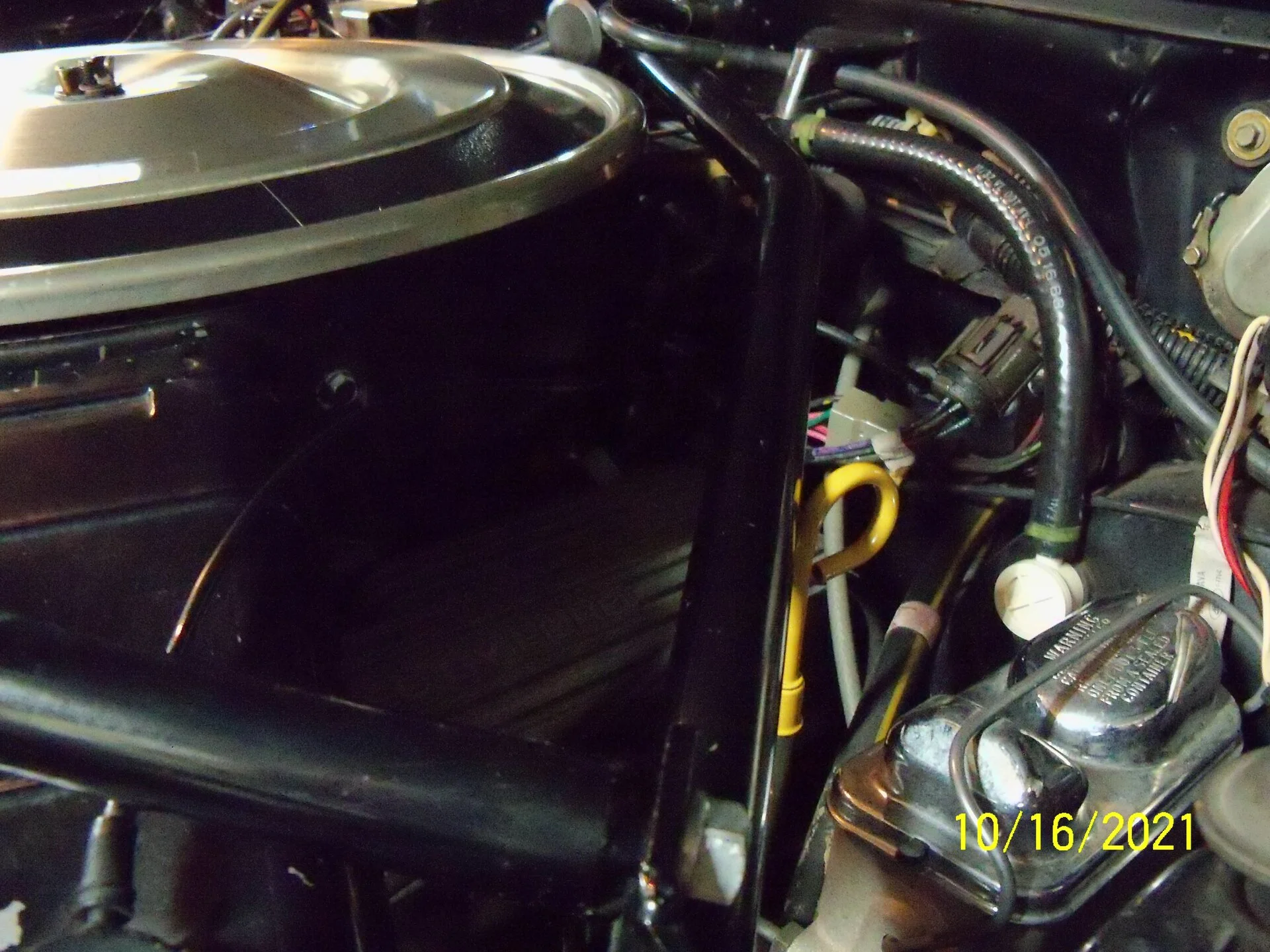

I made several pics. As you can see this is a 2 piece unit. The cross bar in front of the air 100_4794.webp 100_4795.webp 100_4796.webp 100_4797.webp 100_4798.webp 100_4799.webp cleaner is removable to get to the distributor

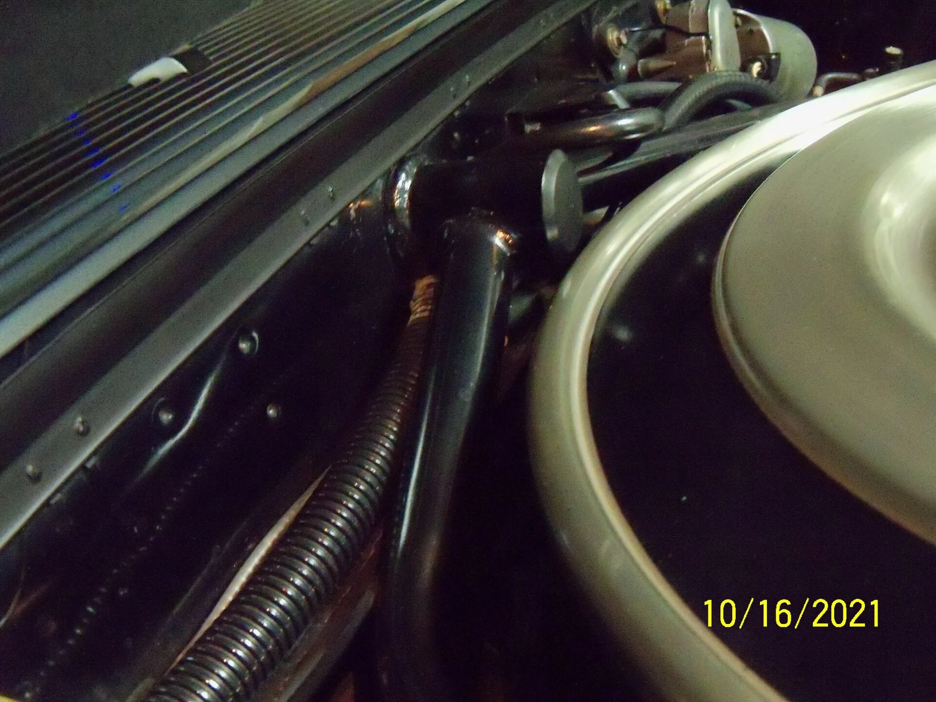

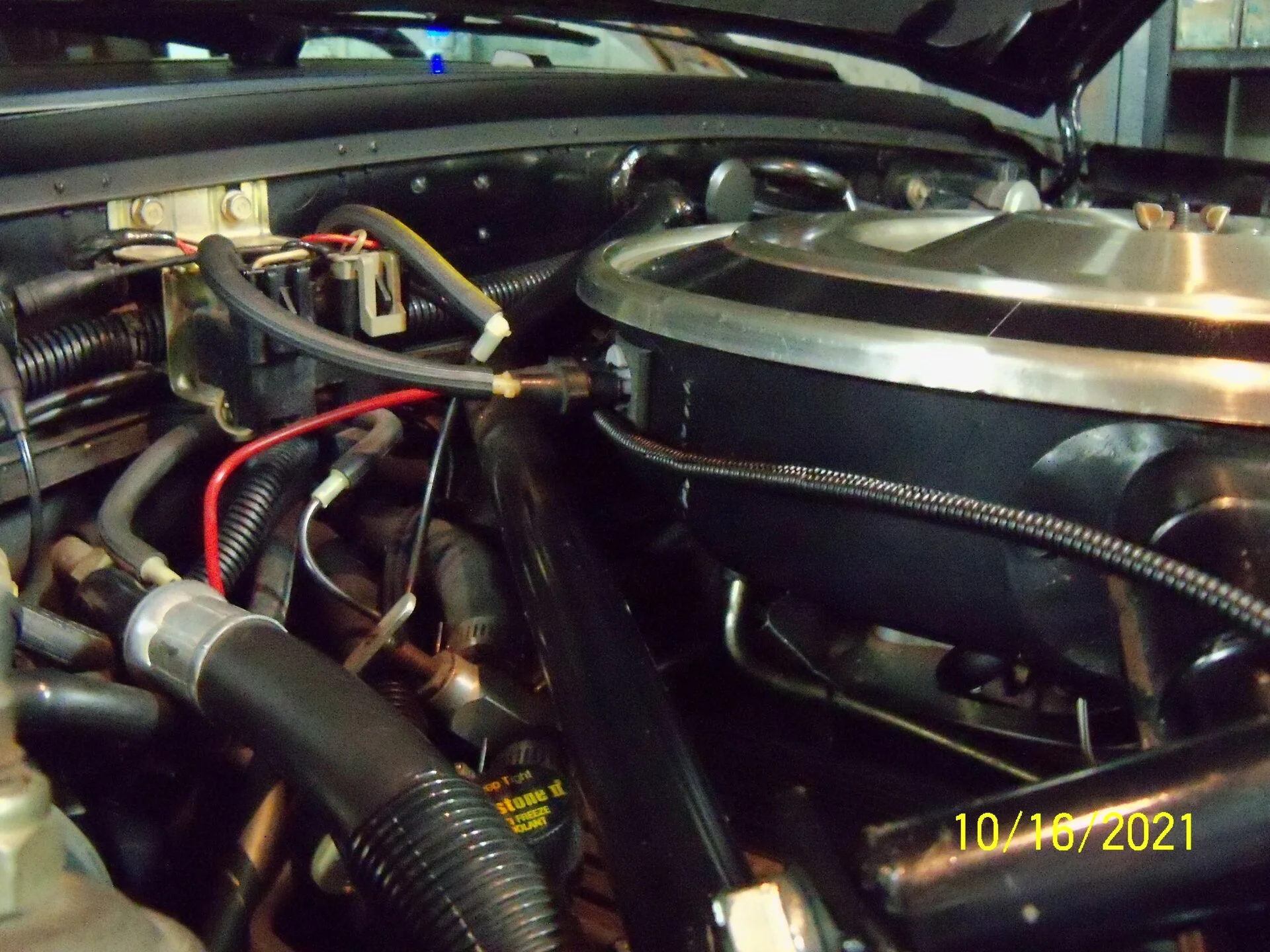

I noticed the Max.Motorsport shock tower brace is a 4 point attachment rather than the 3 point style I have. (The only problem I would have with the Max.Motorsport tower brace is they want you to move the a/c line over the air cleaner snorkel on the passenger side rather than its original routing under the snorkel). I don't think that would be a good idea after 38 years and the original a/c lines still in place. I'll try the 4pt k member support and see what happens in a few weeks. Does anyone think reattaching the rear portion of the x member and welding the modified attaching bracket to the subframe feasible, or just a waste of time? I'll attach some phot 100_4057.webp 100_4058.webp 100_4062.webp 100_4073.webp os of the car

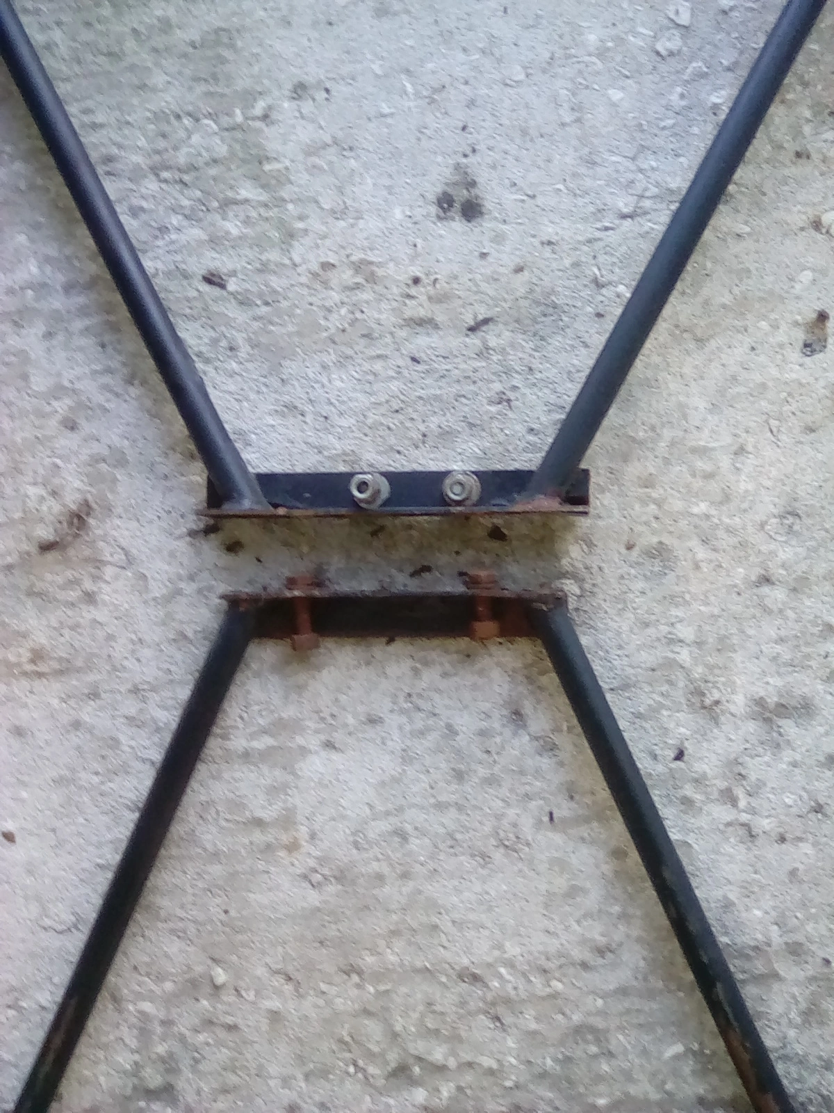

I installed the 4 point MM k member brace and it appears to have tightened up the cowl shudder a good bit with the top up. It was a little too chilly to put the top down. I will try that the next time the weather warms up enough so the original top isn't damaged. I ask again from some of you fox convertible owners, do you think reattaching the rear portion of the x brace and welding the rocker panel bracket to the sub frame connector will improve anything or is it a waste of time? You have to remember this is an early GT convertible, #489 of 1001 built in 1983 (documented by the old 83 GT Convertible Registry). It does not have any of the full length rocker panel supports the later fox verts had. It only had the small support plates screwed and riveted in front of the rear wheels(which we successfully welded to the rear portion of the subframe connector) and the small plate behind the front wheel that attaches to the rear portion of the x frame.

Look what they did to the newer fox verts, they did it for a reason. If you have subframe connectors already then those cast aluminium side braces I think would be unnecessary, I would but the X brace back underneath.

Thanks for the response. What I will have to do to replace the rear portion of the x brace, is cut the rocker plate and weld it to the subframe connector. When we installed the sub frame connector, it covered the area of the subframe itself where the plate was riveted in. The rocker panel side can be screwed back into it's original location without any issue. I just wanted to confirm this was not going to be a waste of time. I appreciate the info. In my case old age is clouding my judgement with second guessing what I need to do.

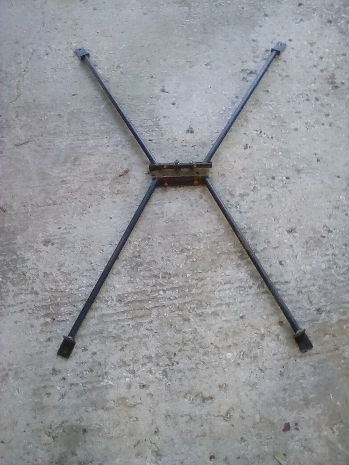

If it is a 'cut and weld' deal to install the rear portion of the X brace I would just install the front portion and call it done. I'm not convinced the rear part does much bracing. I have an aftermarket X brace on my hatch, beefier than that weeny vert part from the factory.
The front half of the factory x frame is in place per Global West sub frame instructions. As far as the Stifflers system, that sounds similar to the supplemental Global West system. This supplemental system is square tubing welded to the rocker with several round tubes welded between it and the subframe connectors. The reason we did not install the supp. kit was the fact it would be welded to the rocker...sheet metal. I'll take a look at the Stifflers system and come to a conclusion. General Karthief Tell me about the aftermarket x brace you have on your coup.
