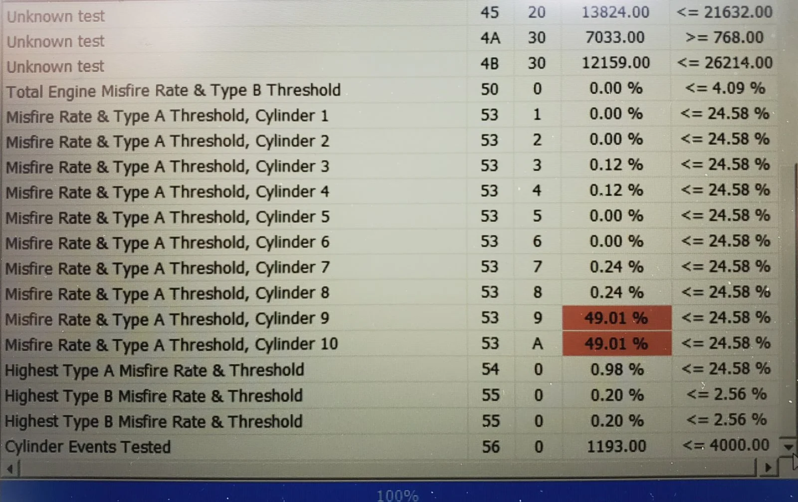

Your 100% right about that on top of the abs I always thought I had a miss but everyone thought I was crazy because she runs great. Well I have never felt so vindicated. Although I'm not sure why it says cylinder 9 and 10...
The reason it shows cylinder 9 and 10 is because Ford uses the same operating system across many of it's lines. The PCM and the ODB2 scan tool are not smart enough to know that the motor only has 8 cylinders.
Please IGNORE any reports about cylinders above the number that your motor actually has. It's OK.
But the ODB2 mode 6 data is a GREAT way to track low level misfires before they start flashing a check engine light.
