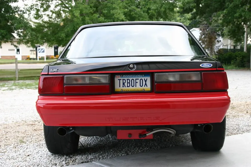

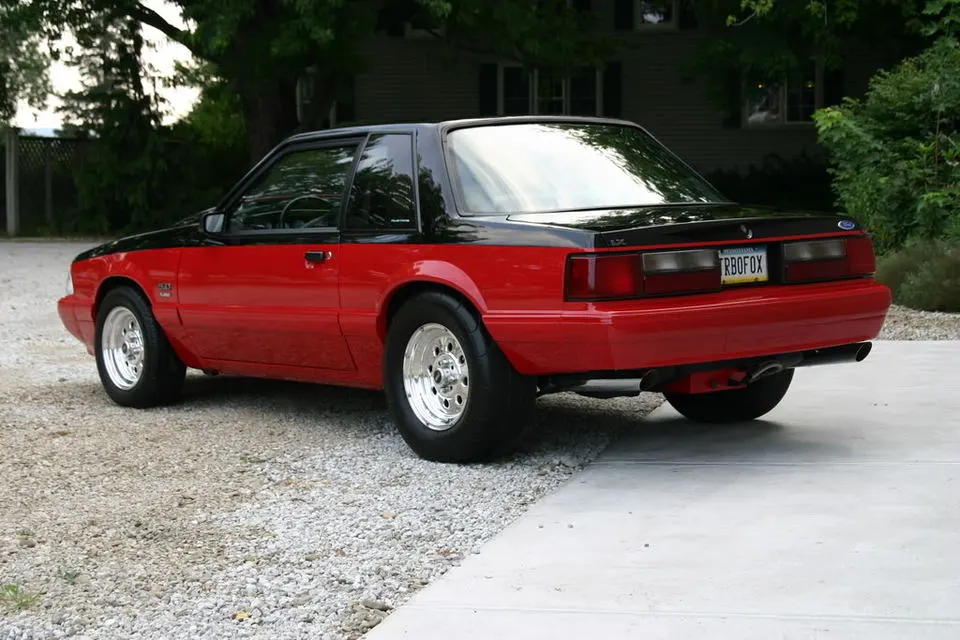

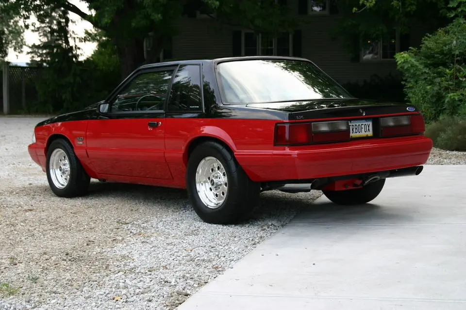

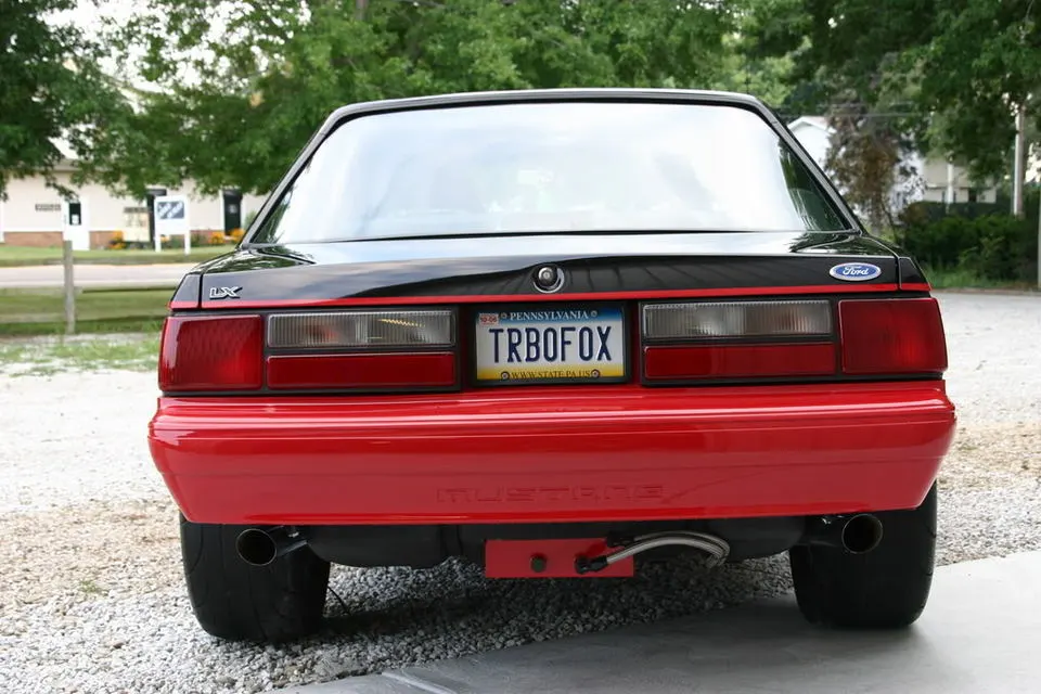

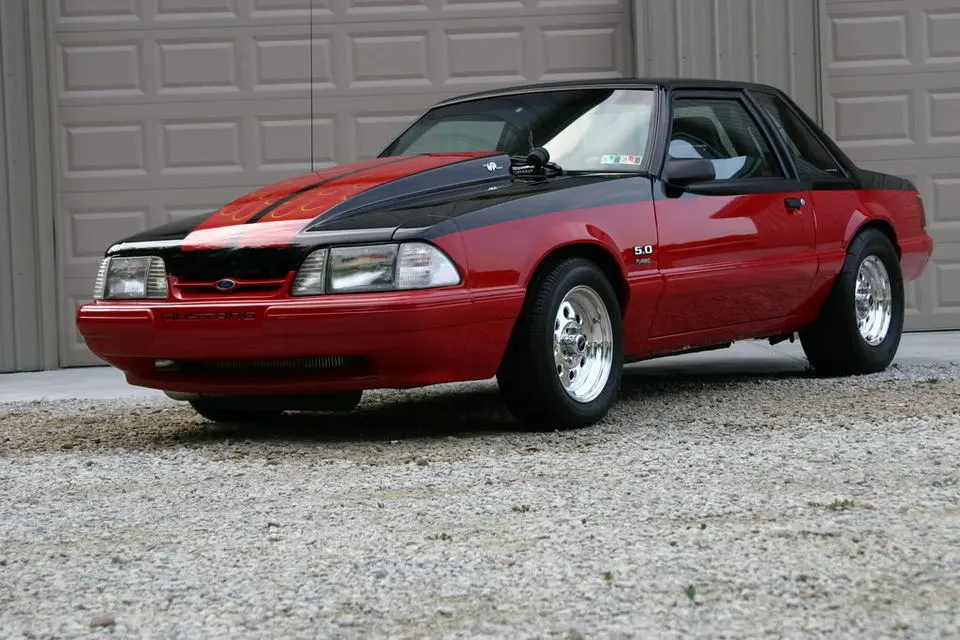

I've got 275/60's and thats what i'd reccoment for you. First off you cant beat the stance of a 28" tire in the rear... in my opinon a notchback was built to have a 28'' tire. And i dont know if your using a auto or stick but i see you have 4.10's, and with a 275/50 first gear is gonna be non exsistant(More so with a 5-speed). If you already have a rolled lip and the fenders are bashed in then thats half the battle, i think thats what scares people away from the 275/60's

The 275/50 s are 26'' tall and the 275/60 s are 28'' tall .I see your combo is very similar to mine ,let me ask you ,with the 4-10s and 28'' tire what rpm are you going thru the traps at in 4th gear?i am thinking of going with a 28'' tire.Thanks
Don't know yet I havnt beent to the track, but I do know cruising down the highway it feels more like 3.73's with the 28"!

i have a TKO in my car and First gear is jsut right for me with a 3.73 gear, i used to have a 26'' radial on the car way back in the day and first gear was a waste of time, thats why i went with the 28'' tire, there is a girl that has a notch that is identical to myne... same wheels and almost the same color, and i was parked next to her a a cruise night, and the only difference was she had the 50's and i had the 60's, and the stance difference was night and day, the big tire makes it look 10x meaner
go with the 60's you wont regret it, i have the same size draglies on my car so you can expect it to look pretty close to what ive got, also i have coilovers on the front now, so the car is a little more raked out then in the thread i showed you.

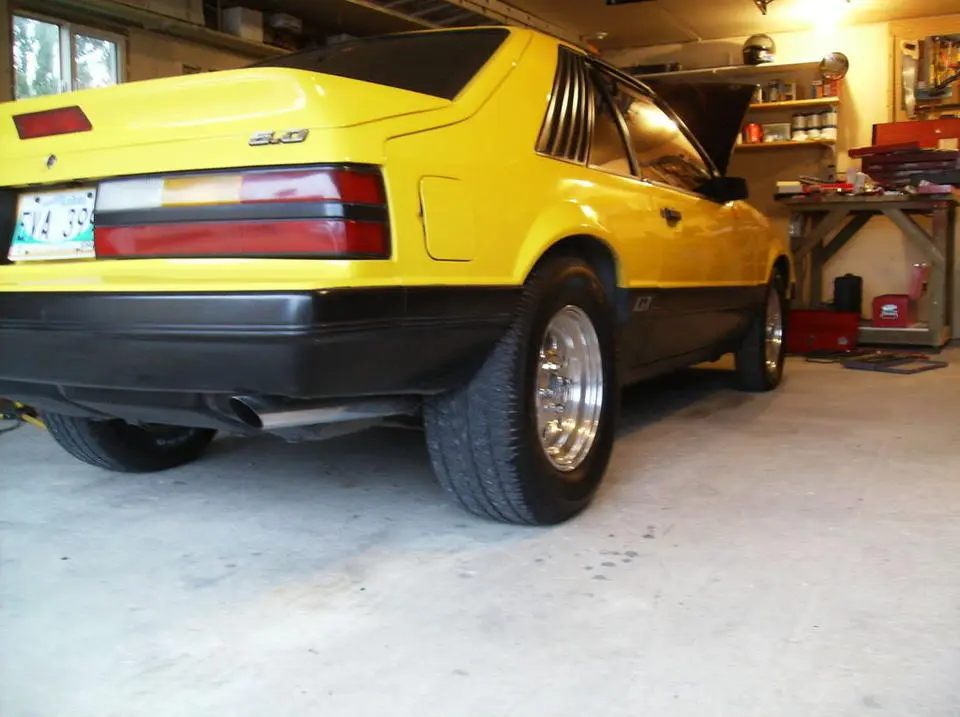

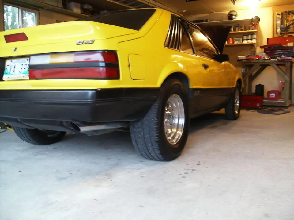

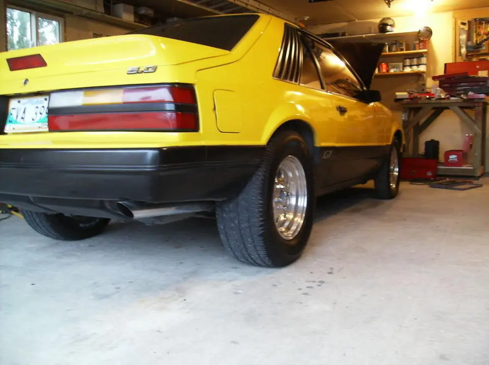

This is what I just bought, I think it is lowered. It has 275/50's I think it looks about right. I would like to try a set of 60's to see how it would look. It has 4.10 and the motor is all rpm so I dont know how it would handle the bigger tires in the 1/4 mile.
Honestly I dont know if the wheel wells could handle a bigger tire after just looking at it in the garage.
Looks good, is it a stick or auto? Curious as to what first gear is like?

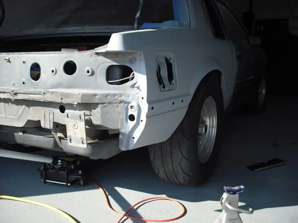

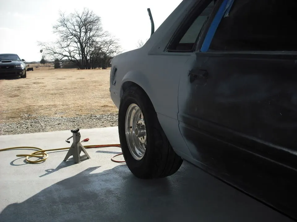

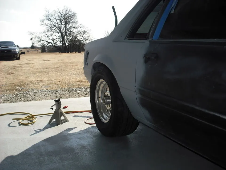

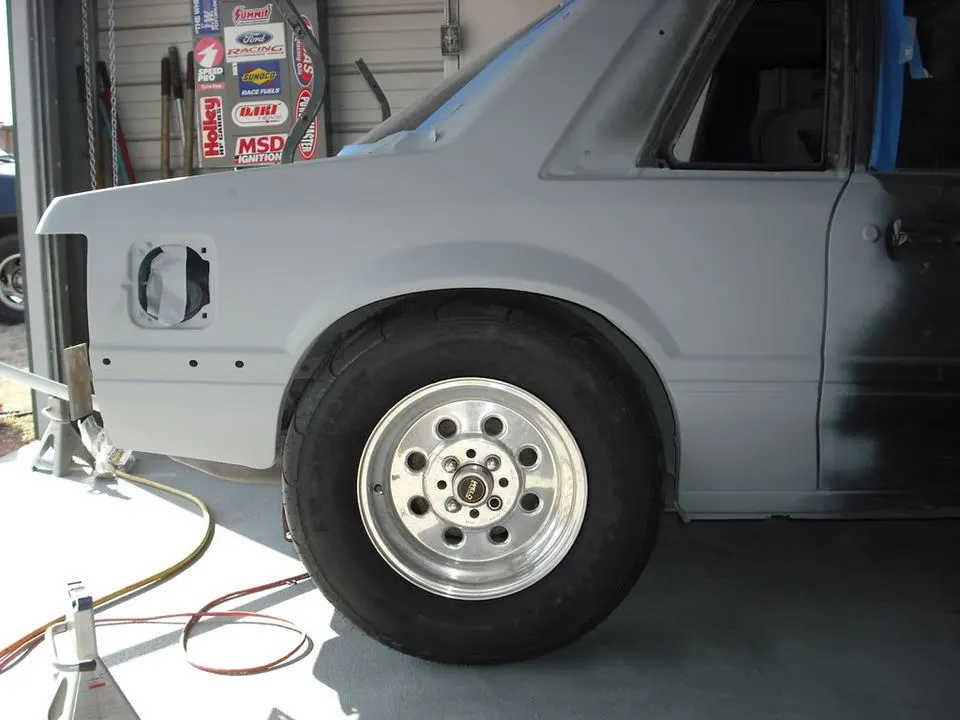

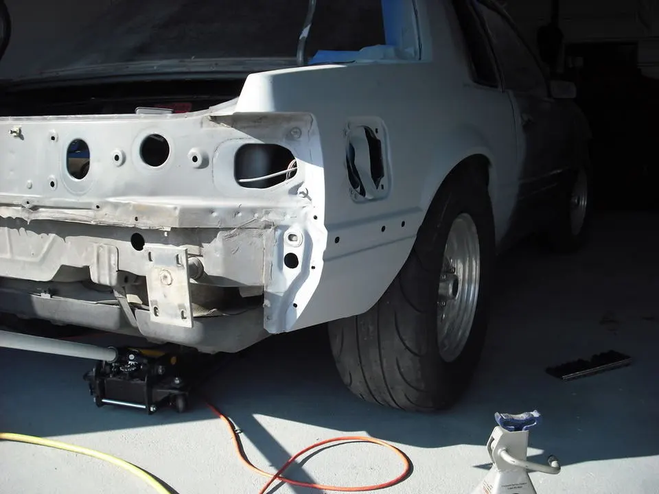

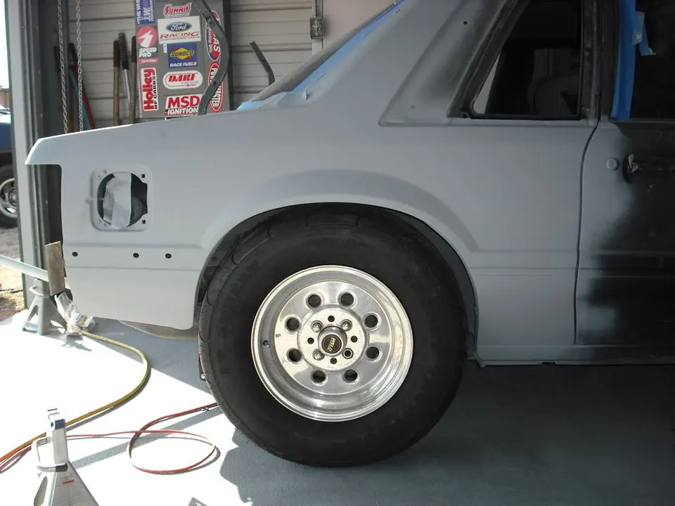

Got my tires mounted, 275/60 8" rim 5.5"bs, I have plenty of room inside and the lip clears them fine! Car is lowered about 1 1/2".
