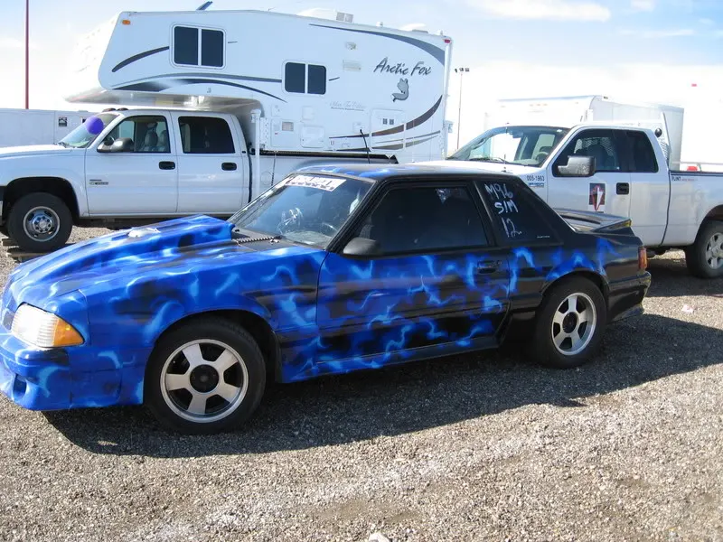

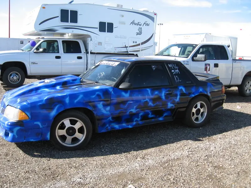

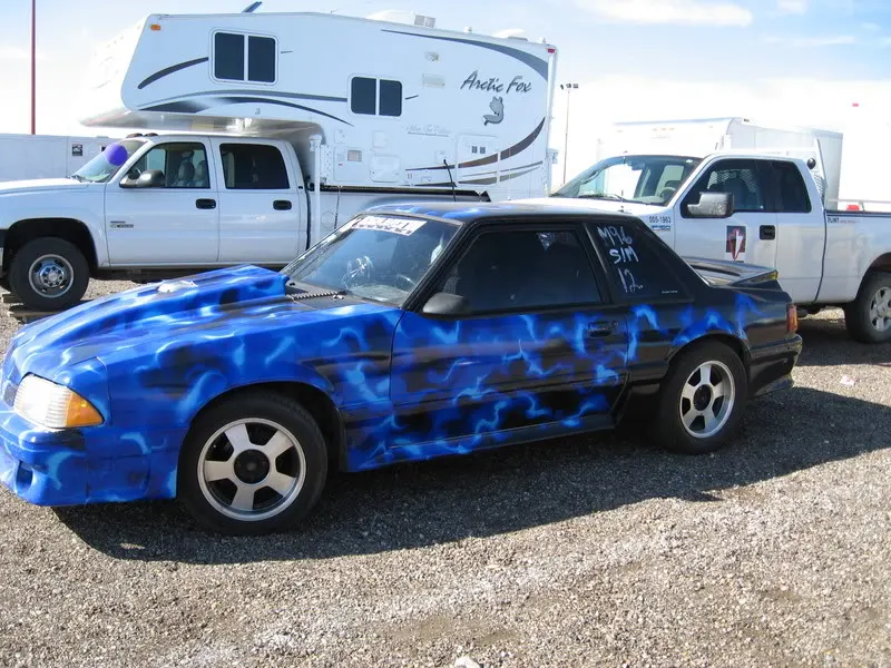

Long story short I now have 15x9 with a 5.5 BS Prostars. What would be a good slick to fit on them? Here's my car. I had 26" MT drag radials last year, 245/50/16's i believe. Can I fit a 28" slick under there with the body kit? The rear end is out right now so I can't test fit anything. Going with a spool and 35 splines with a 5 lug conversion.

Im pretty sure something like a MT 28x9.0 slick would work because their only about 27.5" tall, I think there might be some trimming of the ground effects involved it its a true 28".
