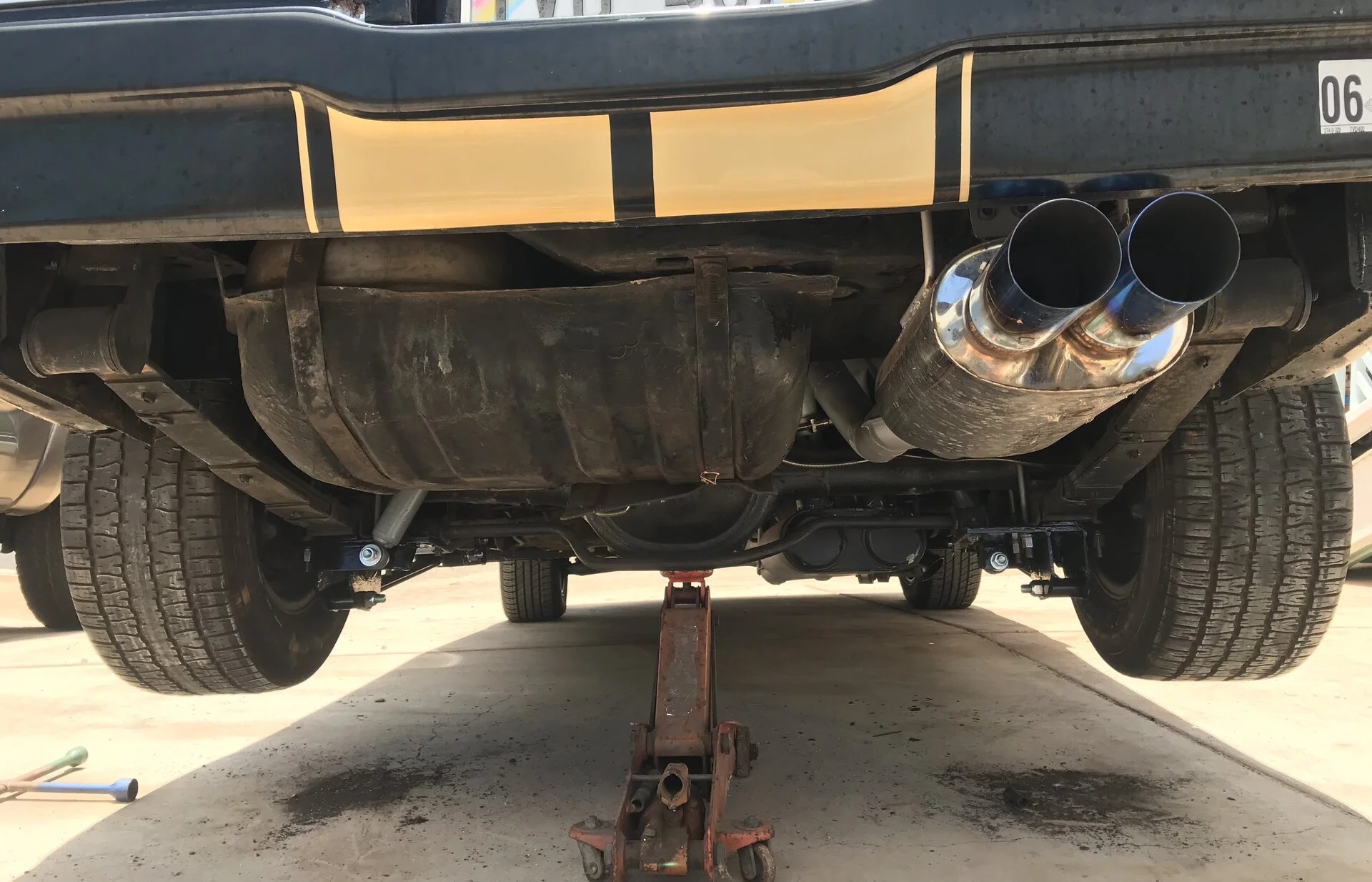

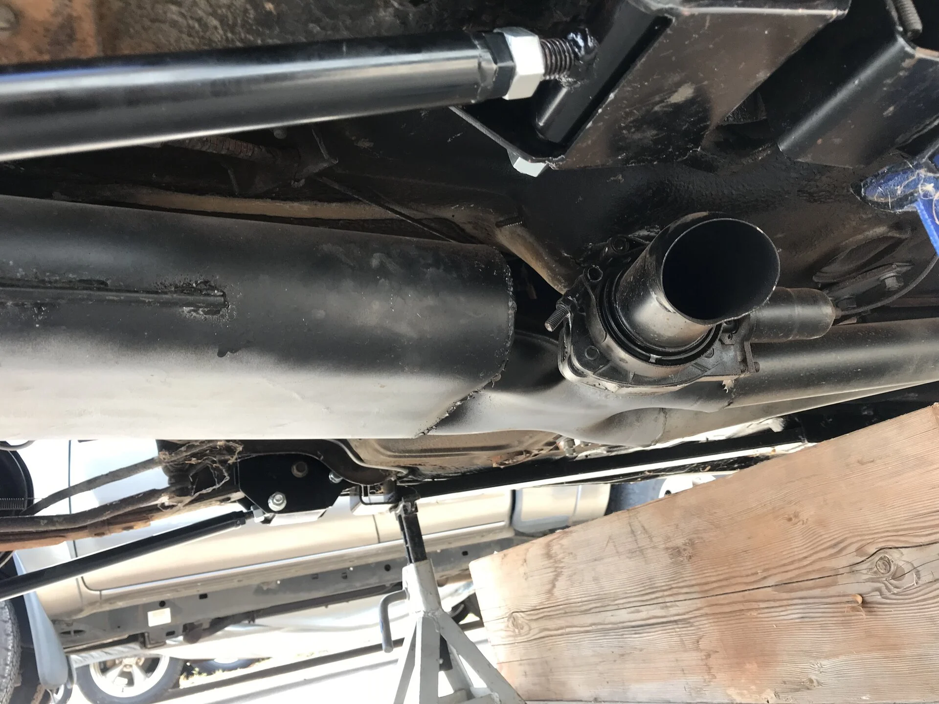

Gratuitous FlowMaster / Exhaust Cutout shot.
It got some stealth flat black spray paint along the line.
Cutout pipe has been dinged cuze lowest point on car bottom.
LOL

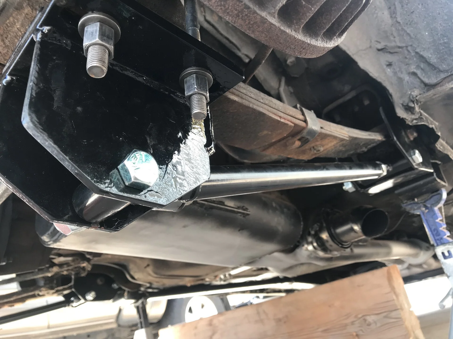

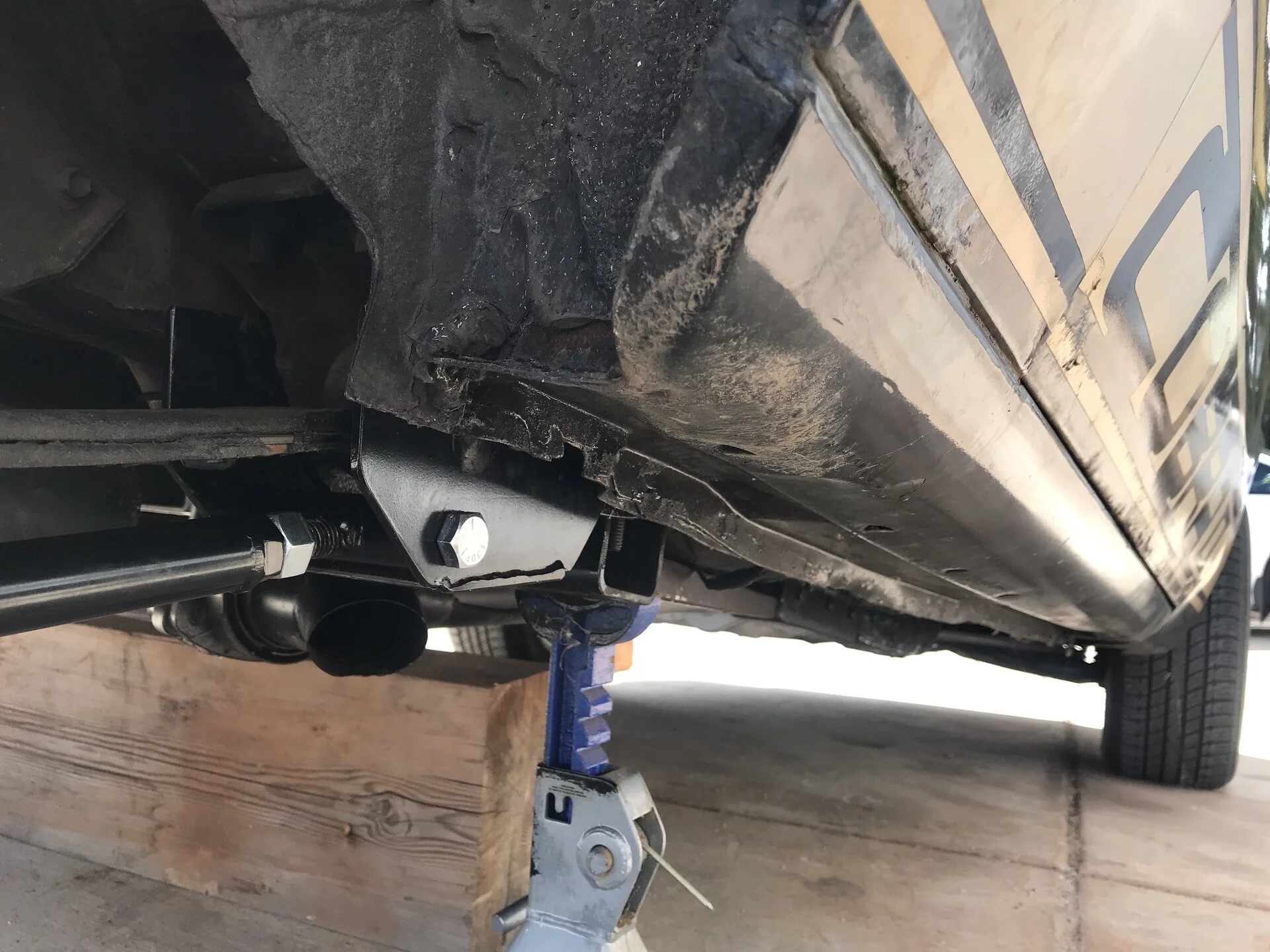

Front bracket encapsulates front leaf bracket after a tap from the hammer.
New Mexican U-bolts.
No Cal trac action.

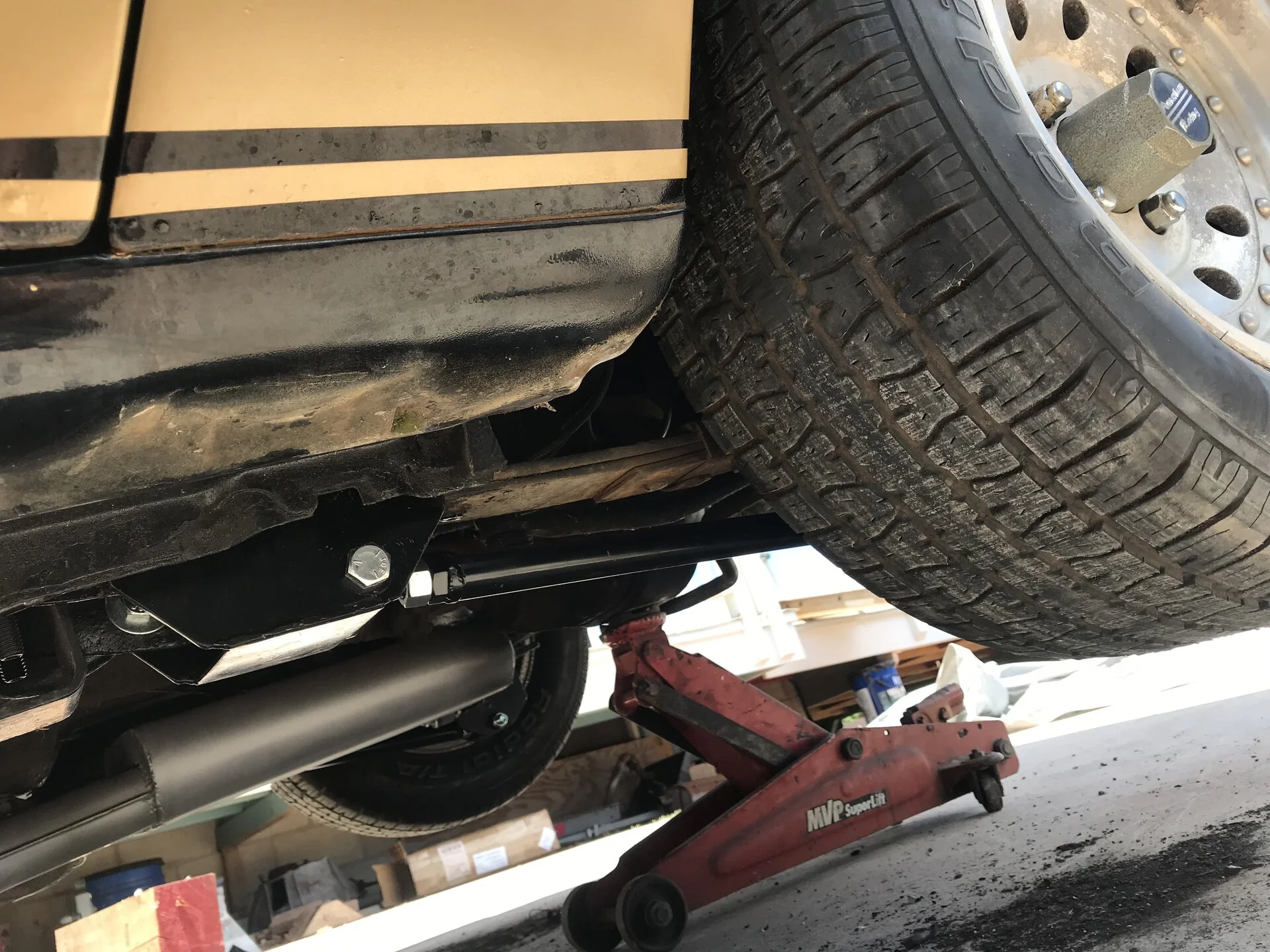

Is underider bar like on 66 Shelbys.
Dropped car back on ground and some bolts got tightened at ride height. Everything got blue lock tight even the poly locks to help keep threads nice for the long haul.

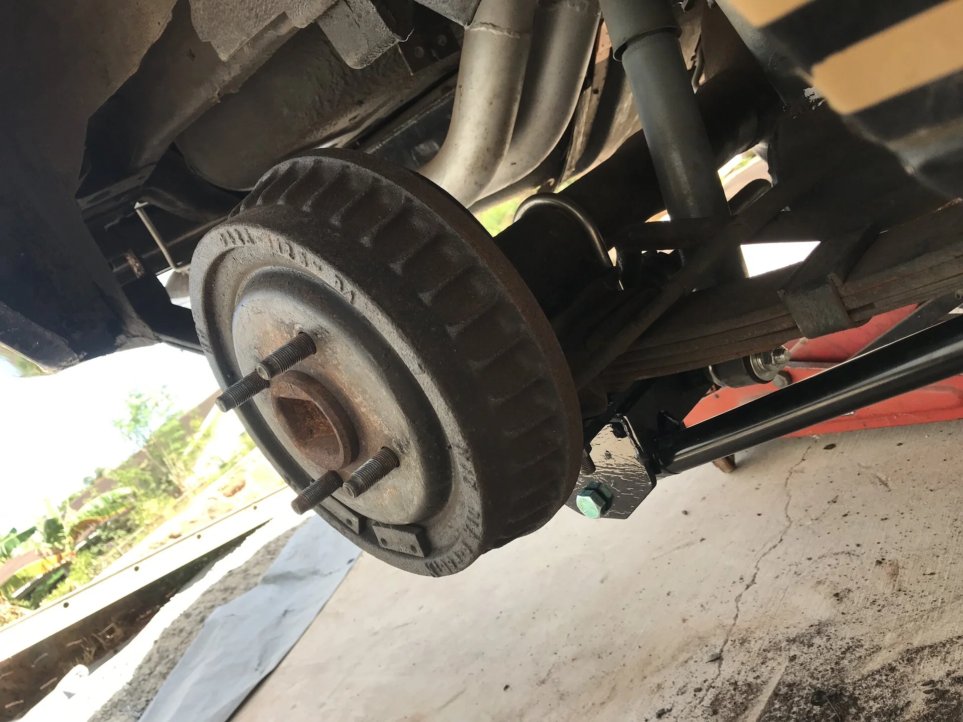

I'm not sure what hermetic seal I broke but the leaf eye bolts were really nice and clean.
I thought i would have to sawzall em out like every 60s Mustang leafspring bolts.
