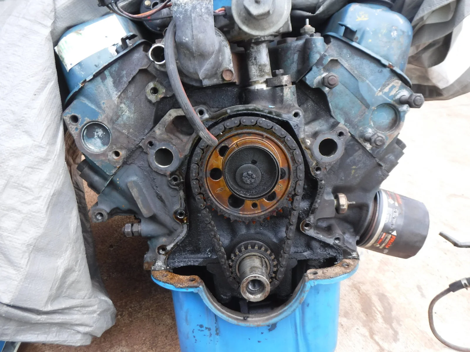

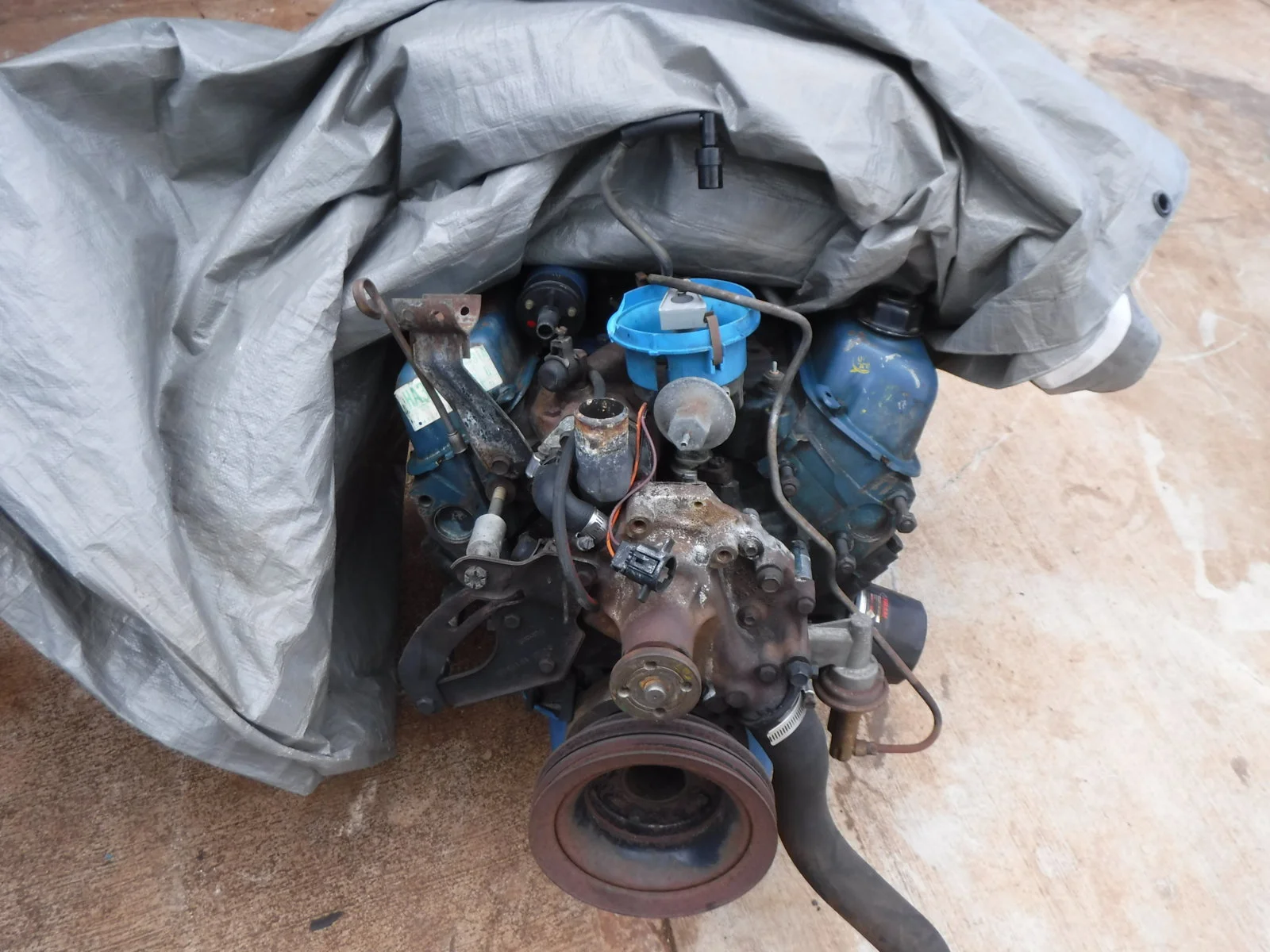

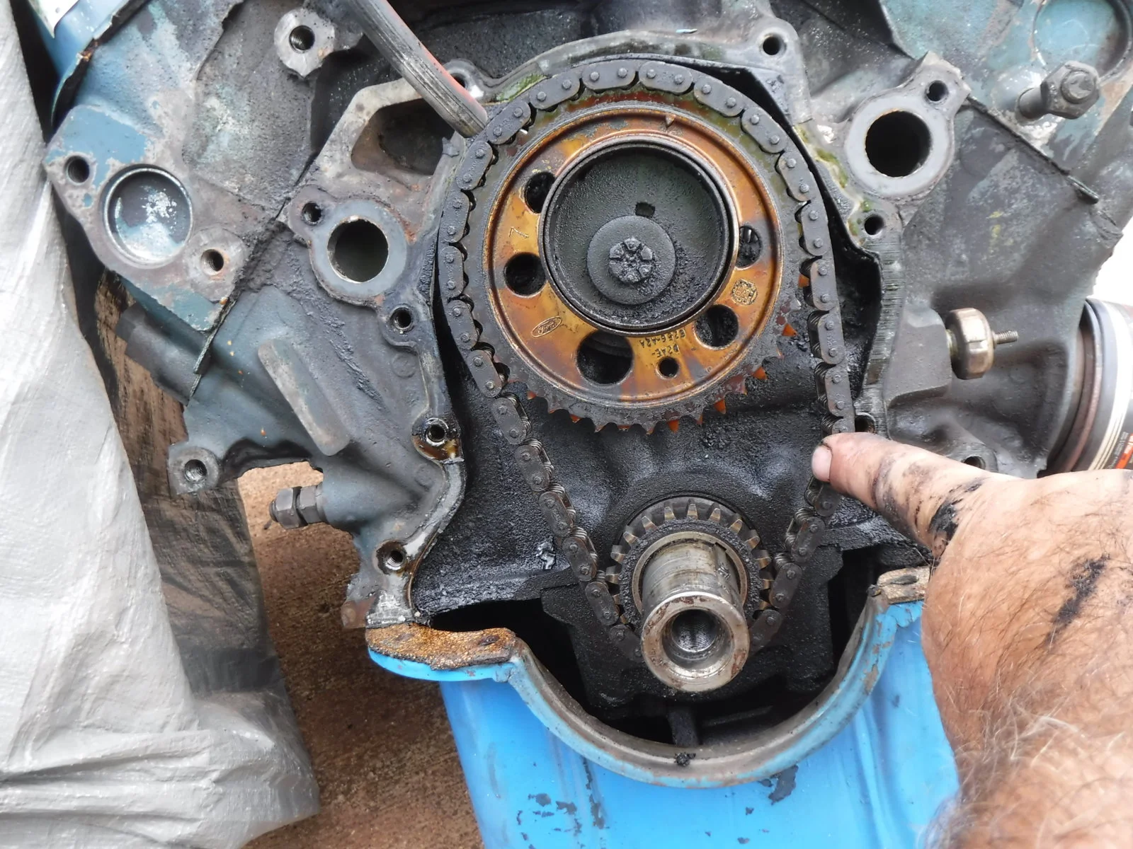

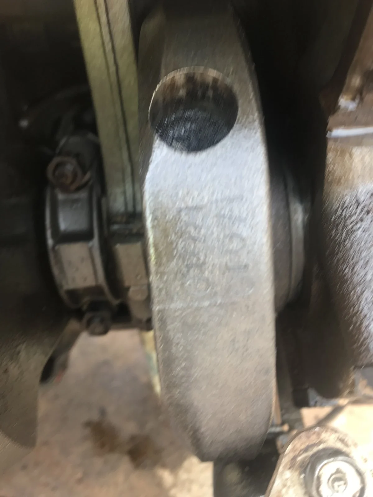

We drug the 289 block out to the driveway and slapped the C4 and starter on it.
Jumped it with jumper cables and wifeys car for compression test. Had the oil pan off.
Looks like crank was hand stamped and says
M10
R10
So this has had the crank turned 10/10
Was reasonable clean inside too.
