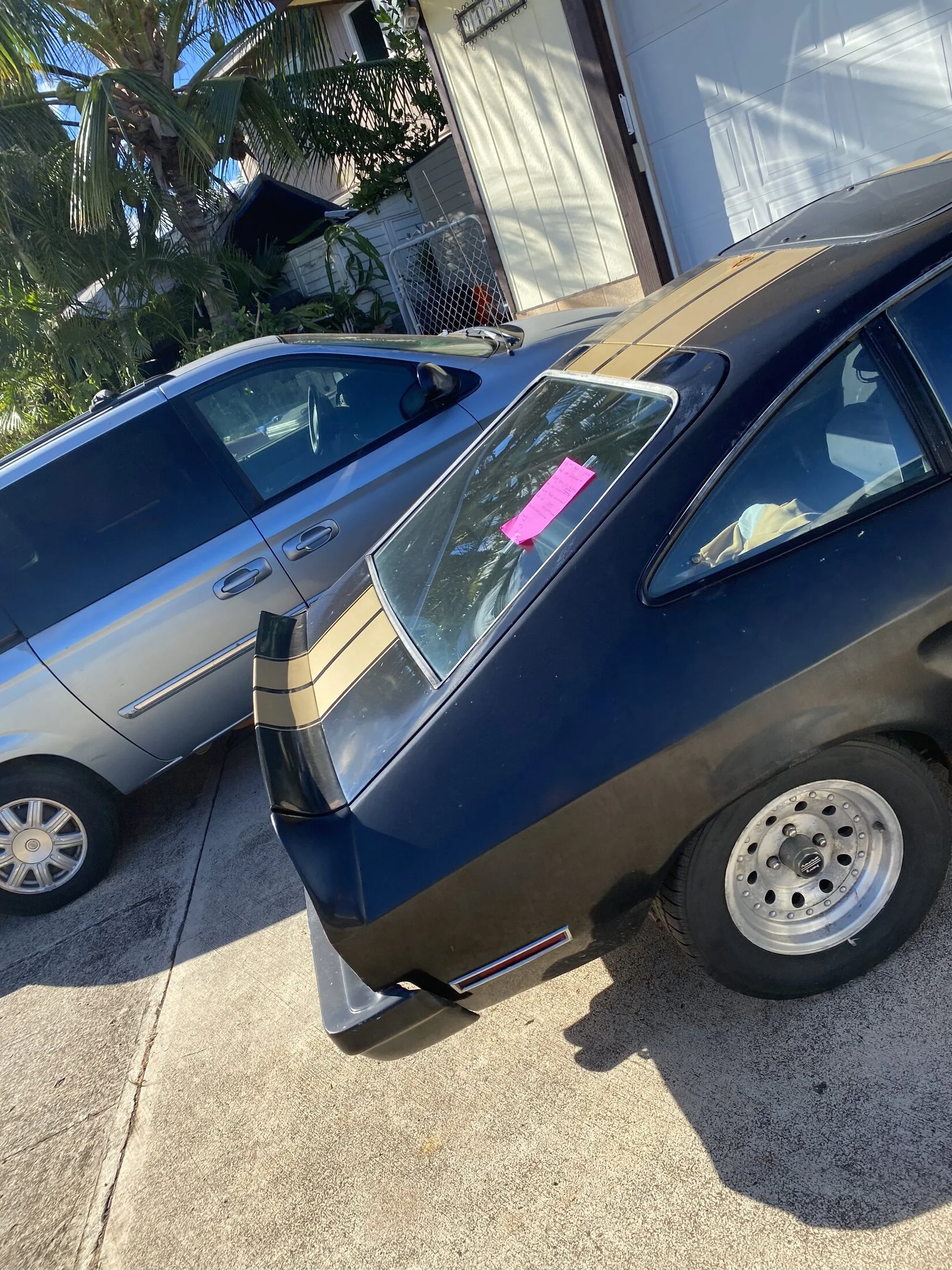

Don't wreck it. It's not like you can get another. I would assume the rear end likes to kick out like a real Mustang does. Even the best of us can get in trouble on slippery pavement. A couple times my heart has stopped as I was sideways.

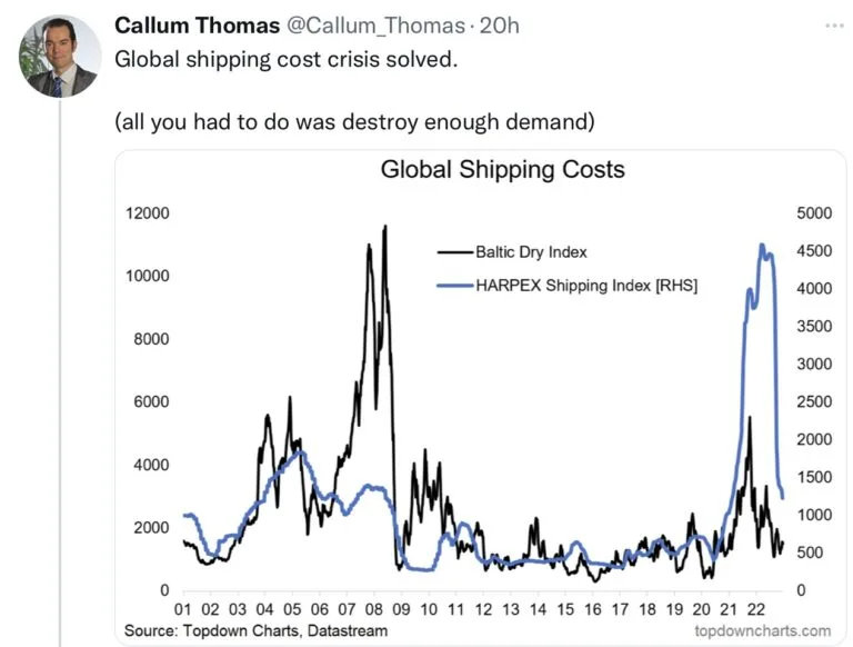

But good news on the shipping cost side. It seems prices will come back to a normal level for us customers in the next months (at least for diesel powered ships, don't know what captain burnout wants for shipping tires and locker diffs with his ghost sailing ship):
