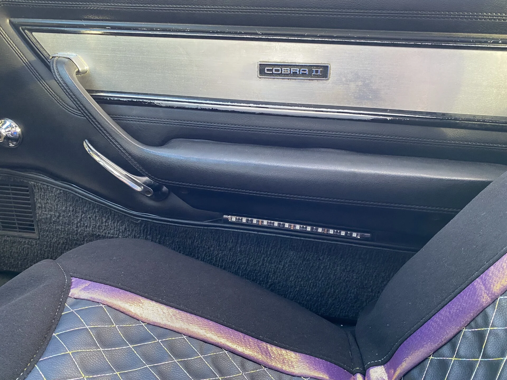

Kid did his first Mod on his own!
Without telling me. Yes!
That means after a couple thousand miles, him and the car are truly bonding!
Just a pair of LED strips by arm rests, changes color, etc.

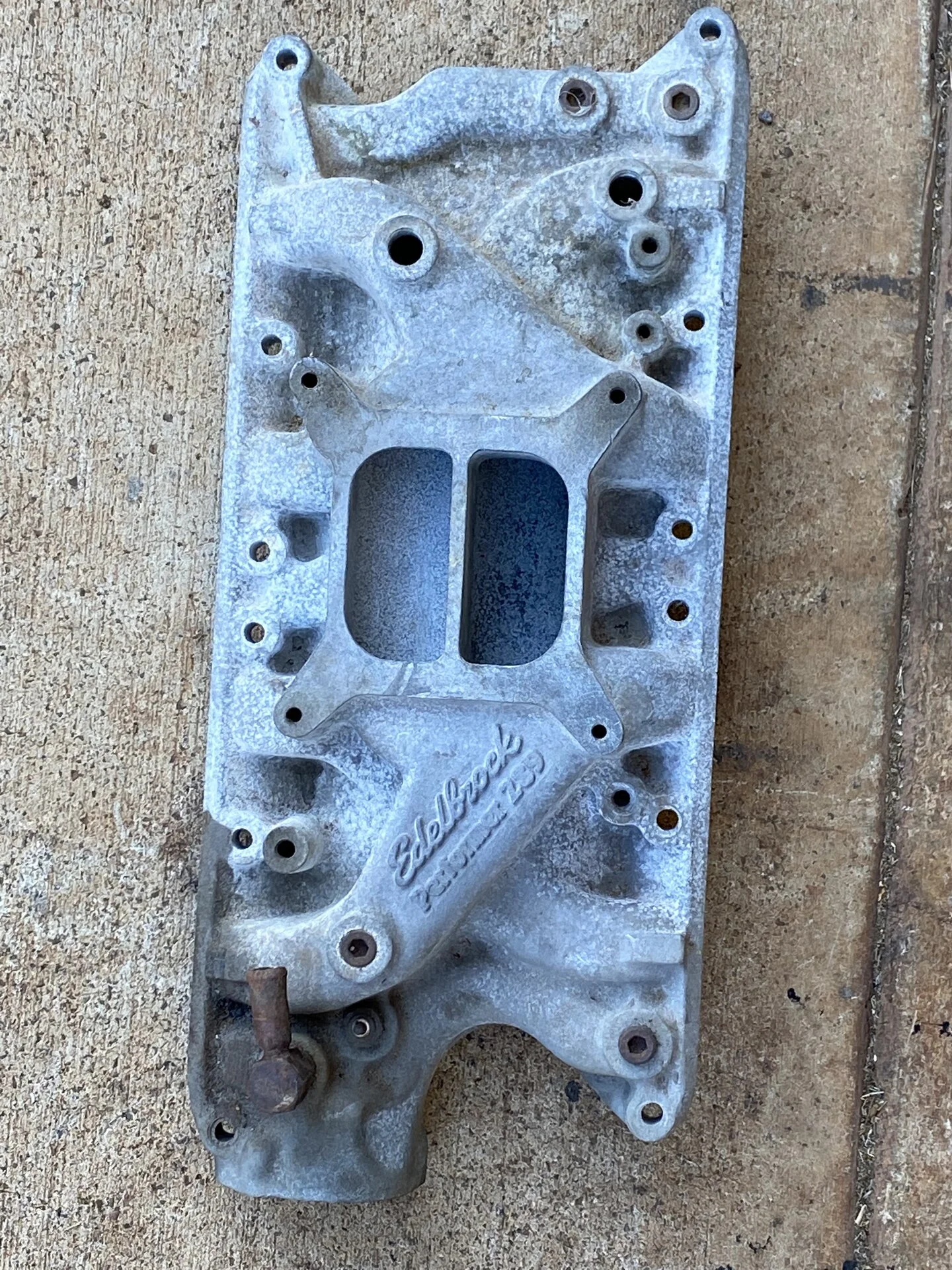

2Blue2 said:
Got to get him a rebuild kit for the 4 bbl carb and manifold we got for this CobraII.
What? Kind of left this to the end to see if we read all of your posts. What size and brand of carb? And what manifold? AND! Jeez. Do I need to ask?

Enzio said:
And what manifold?
Eldelbrock performer 289 and its so old school its got the rear water passage still.
The RPM one was too tall to fit under hood, don’t know if this one will.
Will have to dig thur the carb pile to see what we can make work.
Of course it runs great the way it is...

Hey! Thats my intake. Oh nevermind. It just looks as bad as mine did. I wire brushed it then hit it with wheel paint. I choose the wheel paint after carefull considera...... It's what I had on hand. Looks good. Have run the engine and test driven and paint held up so far. I used the same color as my wheels.

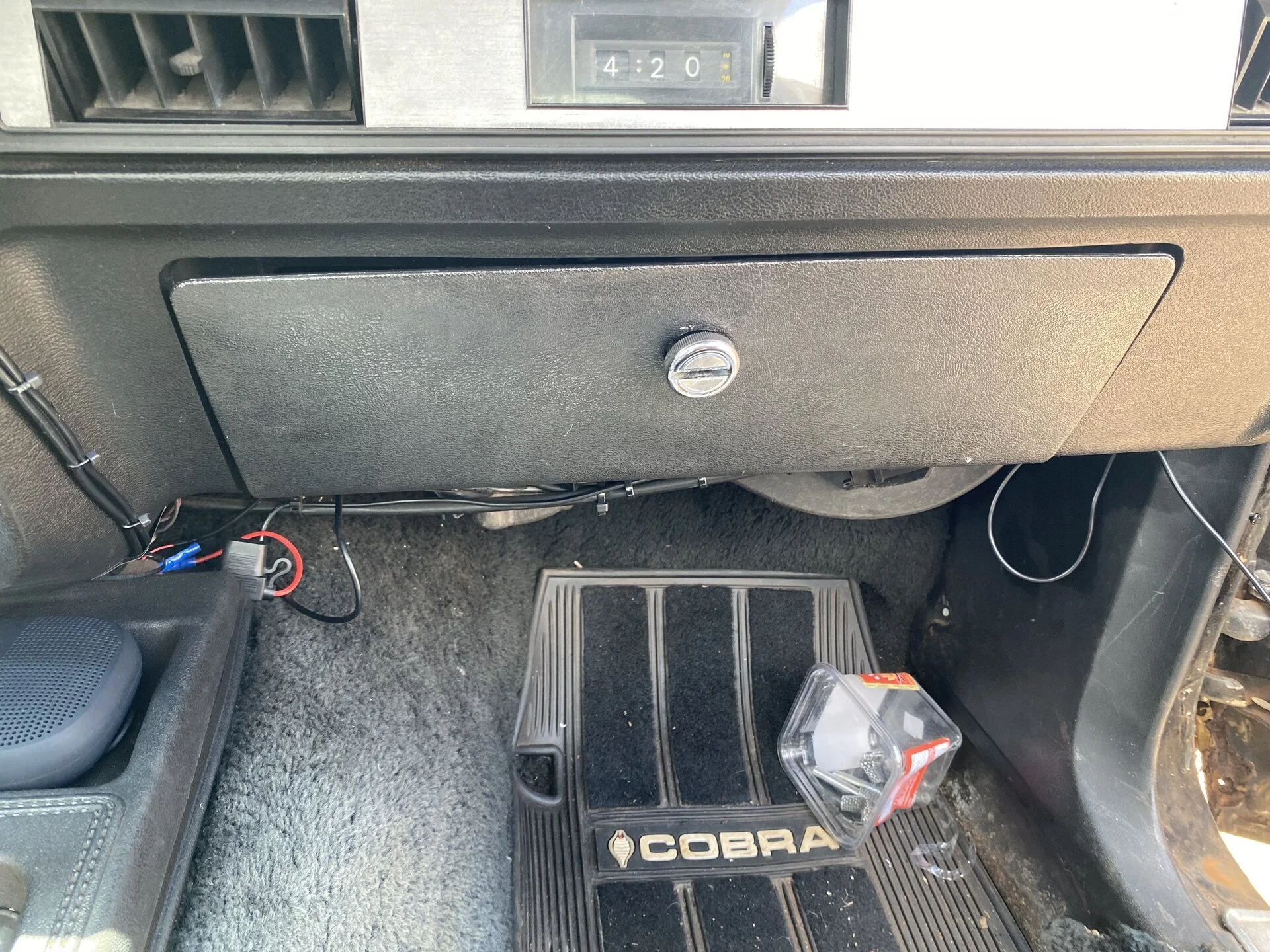

Tragedy ~ glove box door hinge failed finally,
just ripped down fold.
Bummer
Reactions: IICrew and LILCBRA

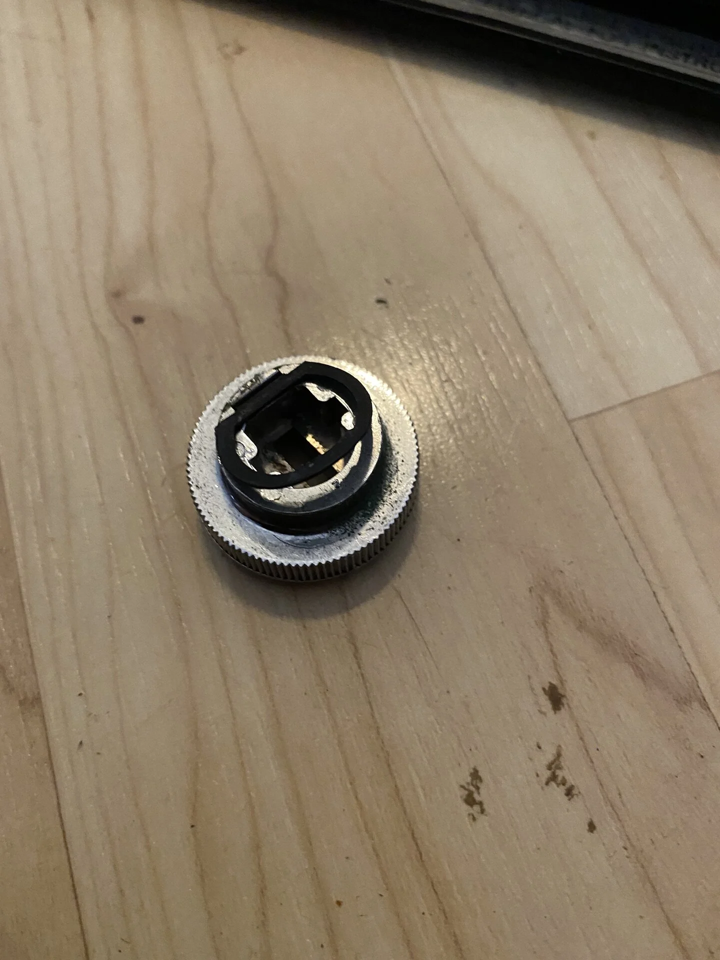

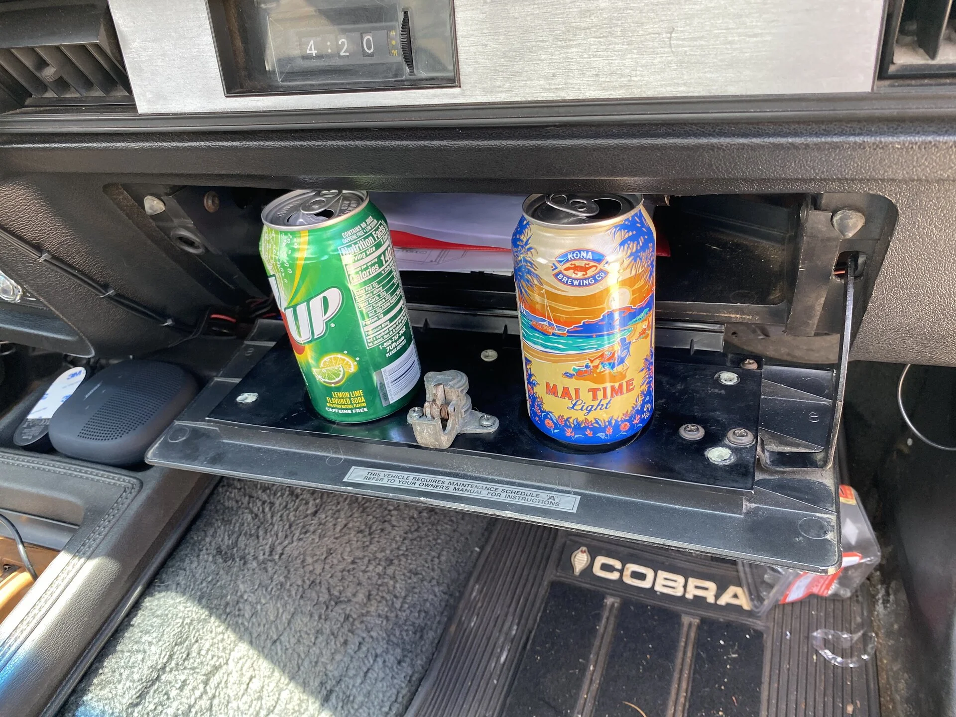

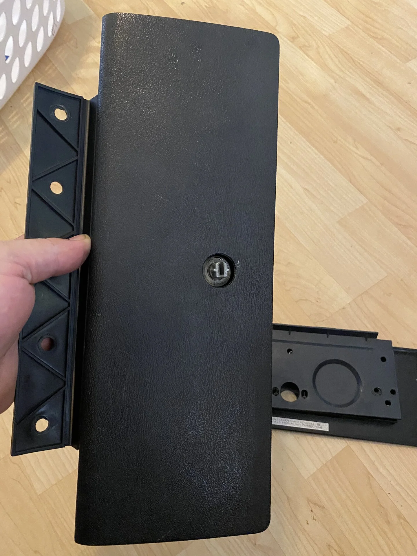

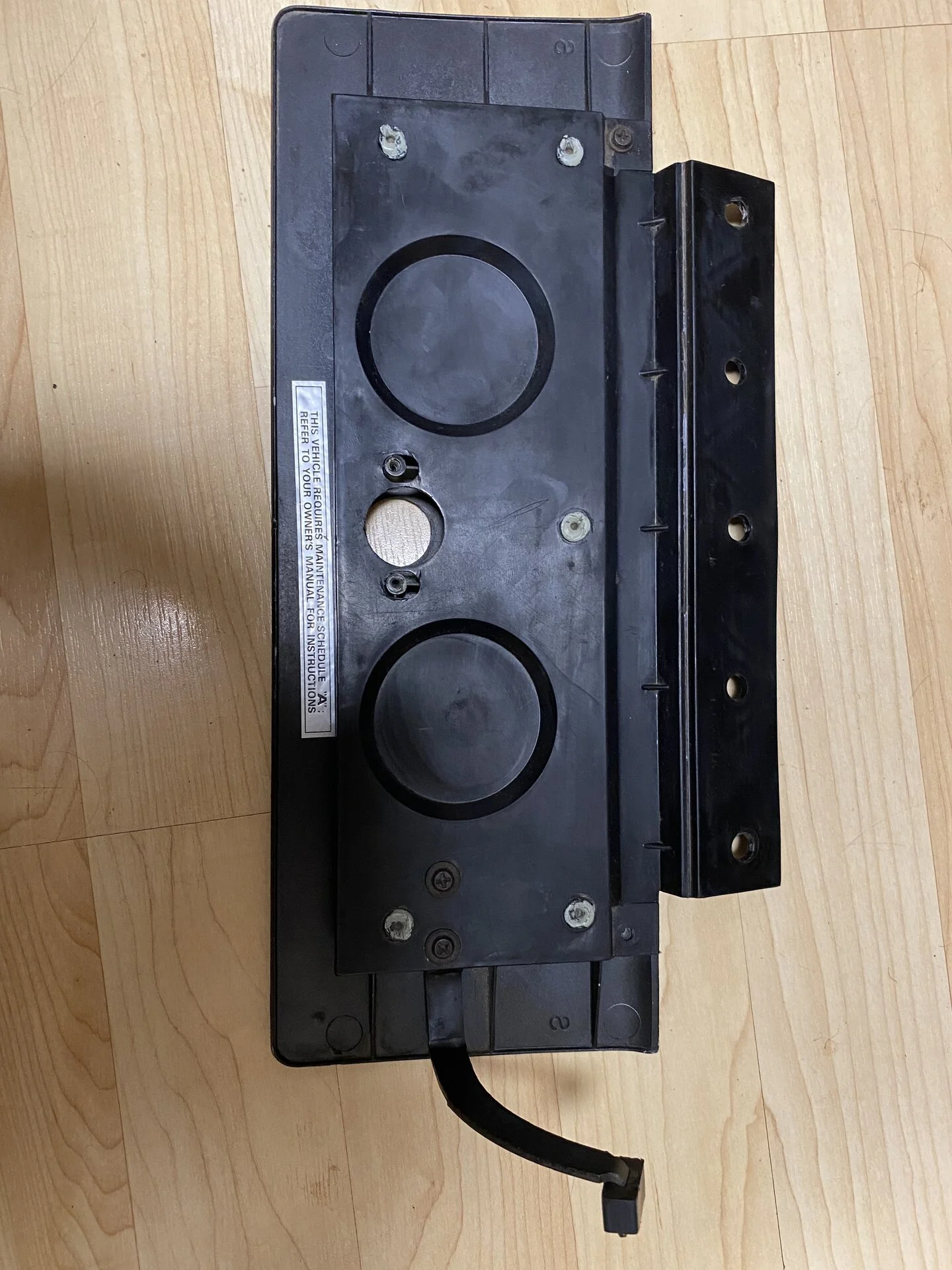

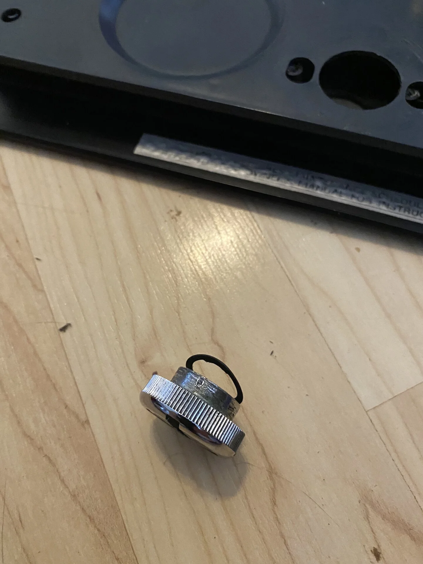

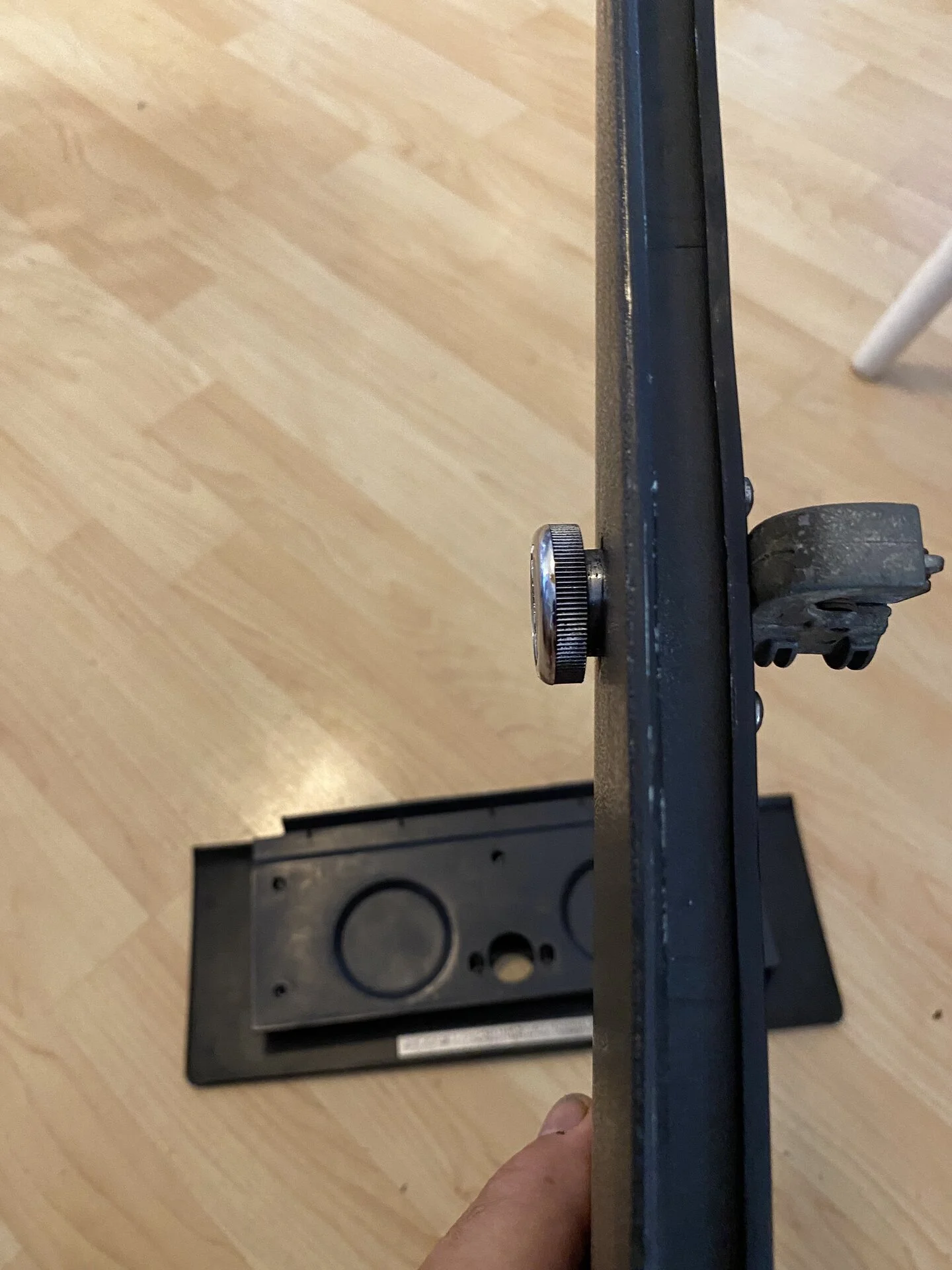

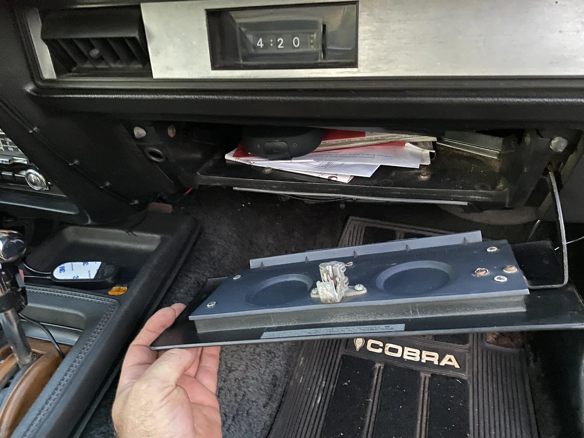

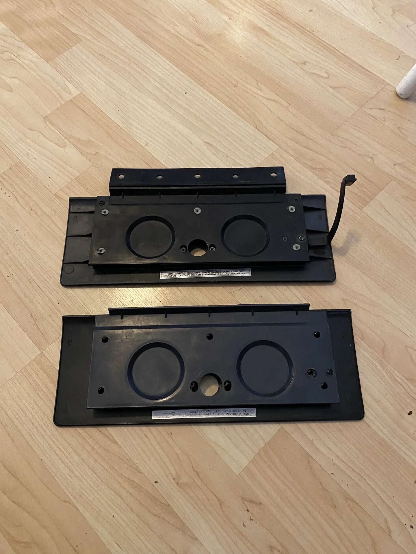

Glove Box Door and Lock Replacement
New 2me part showed up.
Kind of looks 45 yrs old but lucky to get it.
Taking lock apart required reaching between upper and lower halves of glove box door
and pushing angled locking ring with pocket knife and then chrome knob fell off.
I took support arm rubber bumper off and inserted arm into dash and replaced rubber baby bumper.
Then screwed hinge on.
if the armor all dont bring it back we might paint it black or swap door back and replace melted plastic ‘riveter with some screws.
At least it looks doable
Still a little crooked though replacement has extra ribs and a another pair of screws by hinge ends,
probably as a factory fix just for this problem.
Knob mounts a little crooked too because of angled ring spring.
First Generation drink holder back in action!
Can clips against opening to keep from spilling on speed bumps.
We had a beer while fixing not while driving!

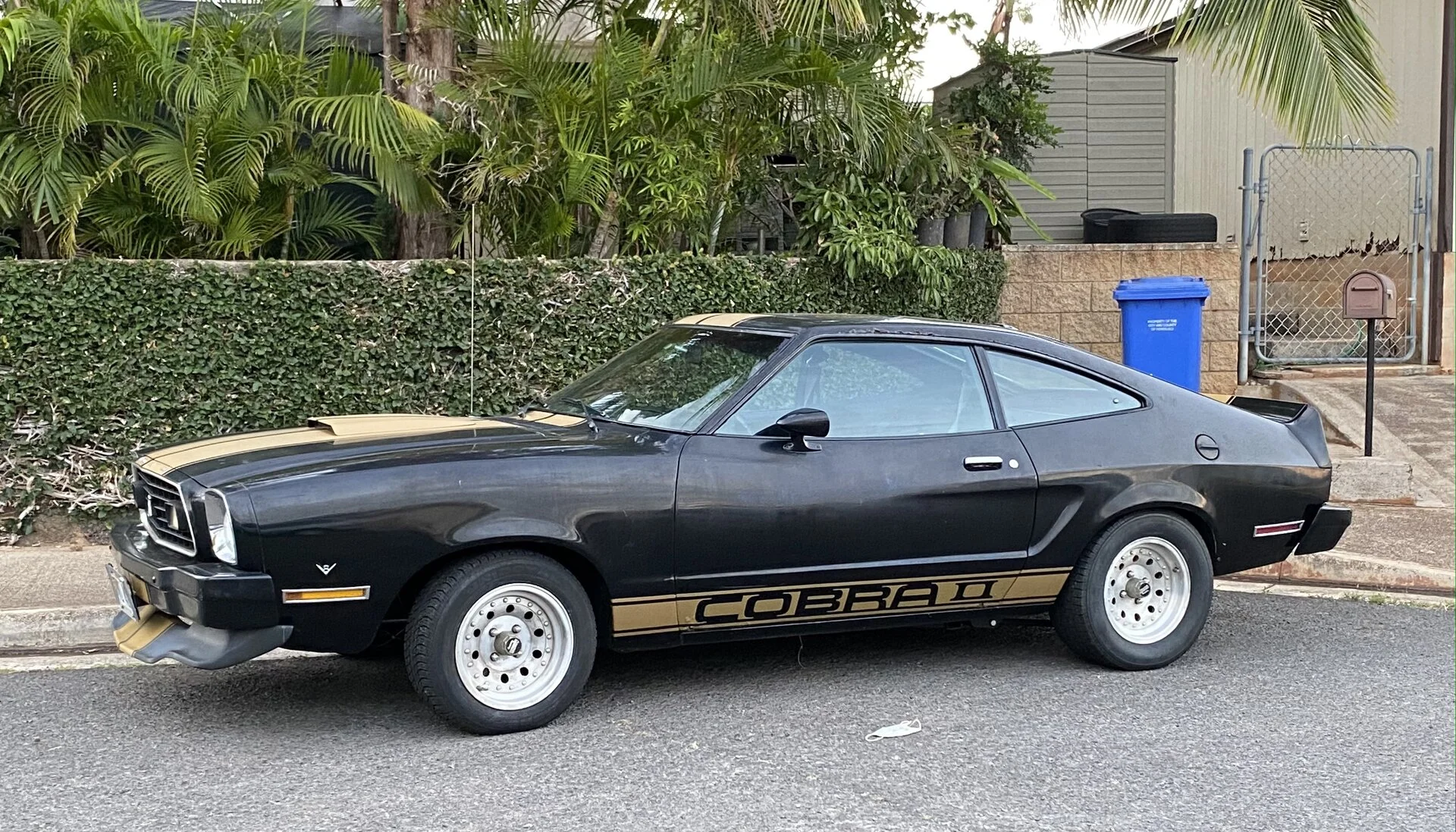

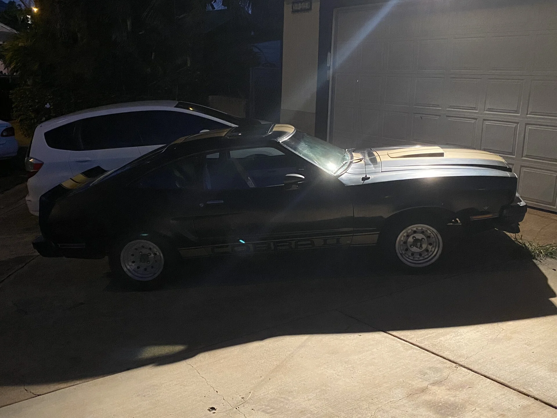

Early morning light is the only time I see this car now.
My goal of daily driver status is a reality.
Need to start thinking how I’m getting this car a paint job.

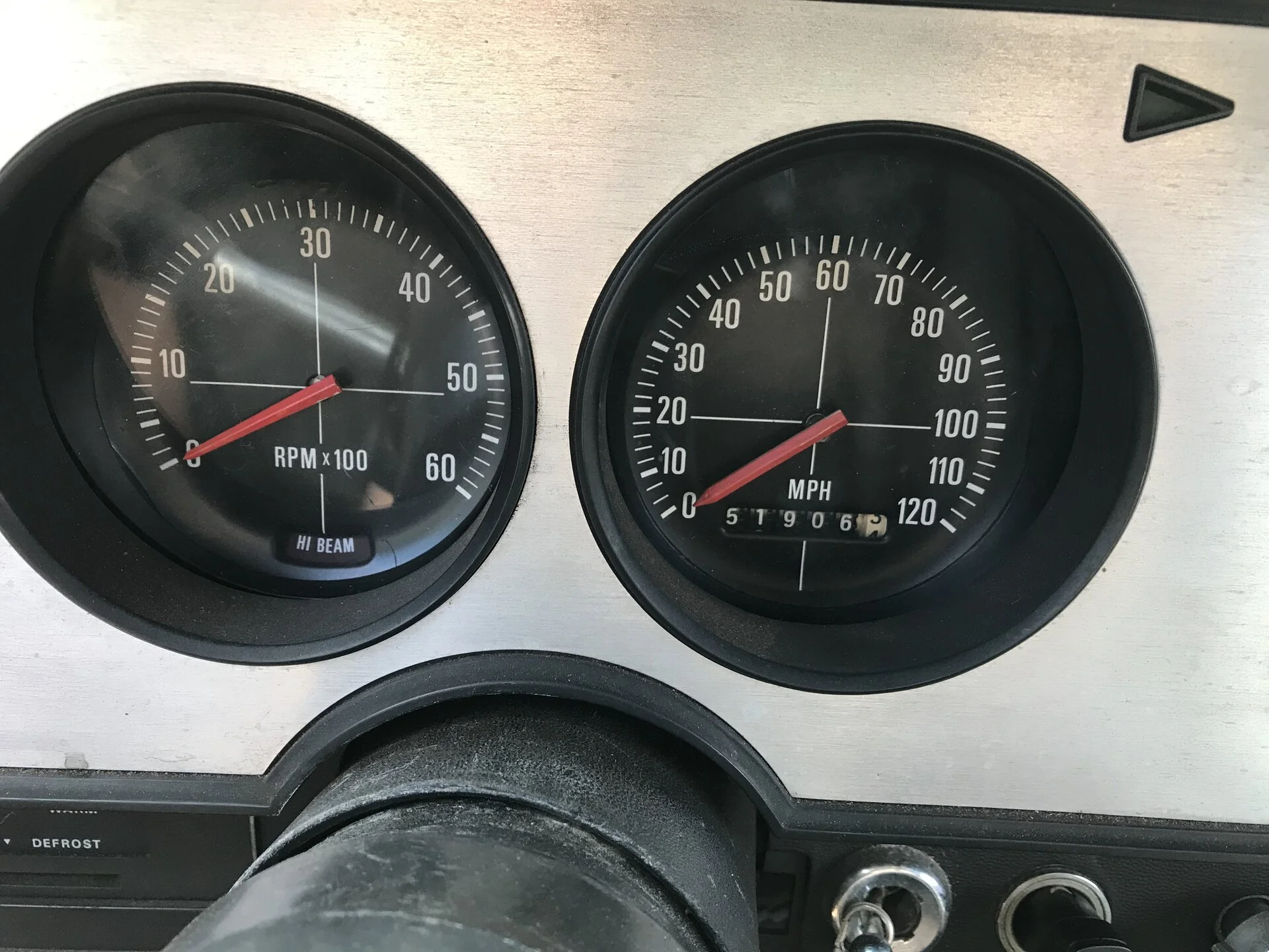

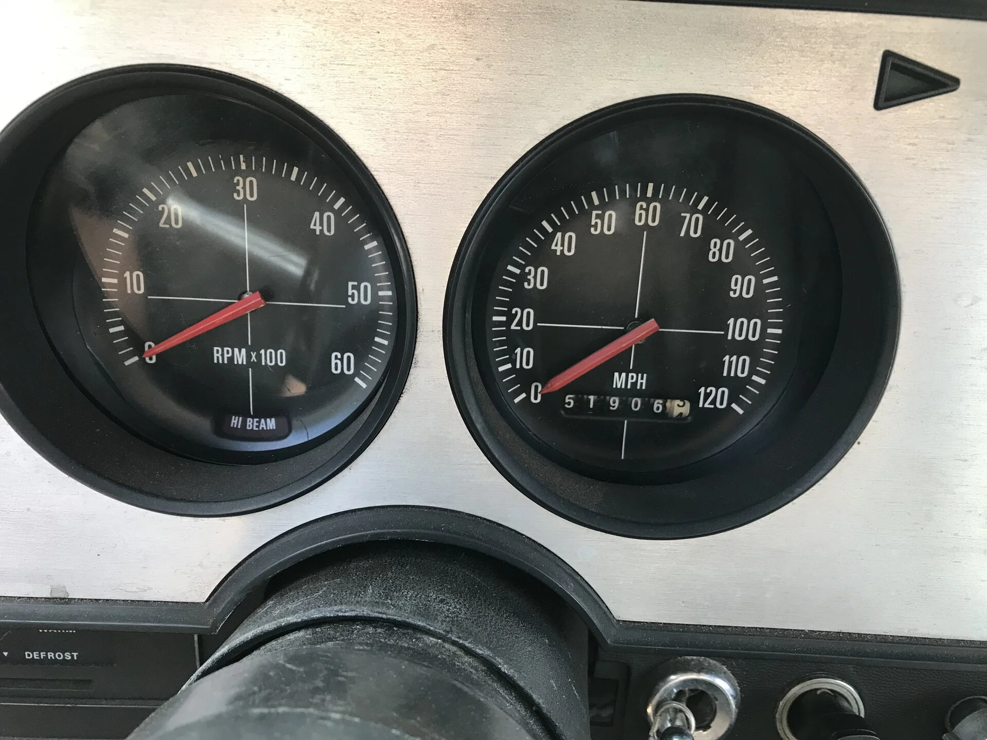

2023 New Years update.
Daily Driver status - Heck Yeah! Son drives it all the time everywhere!
His friends think its better than sliced bread.
So it meets peer pressure without being a 'tune-er’ car.
Happy New Year
May 12 2021 51906.3 - - - - - Jan 6 2023 54909.4 for a total of 3003.1 miles ( Hey the island is only about 40x30 ).

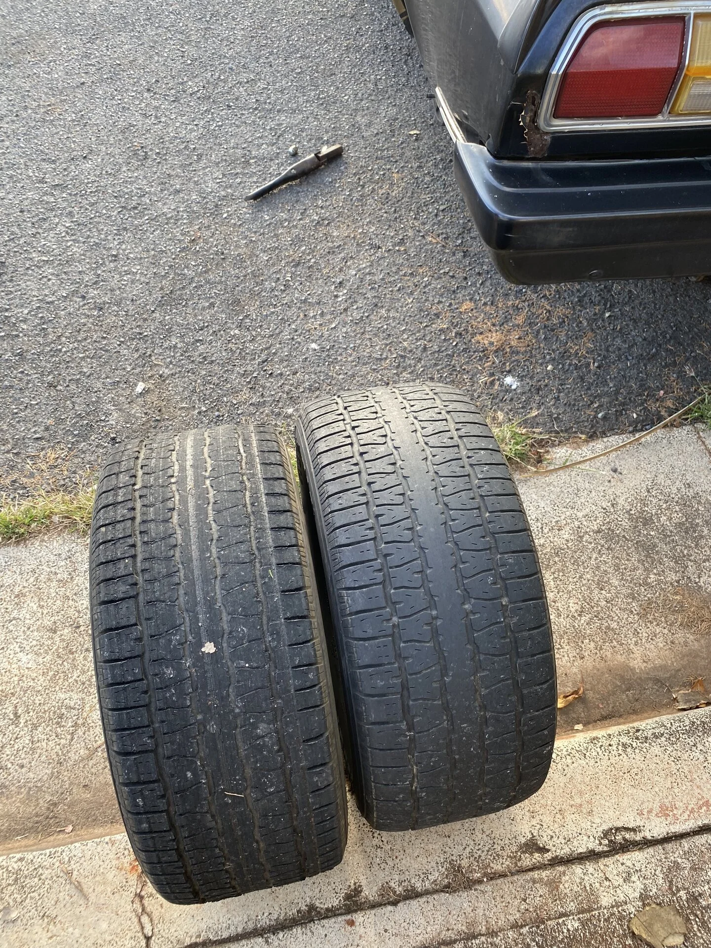

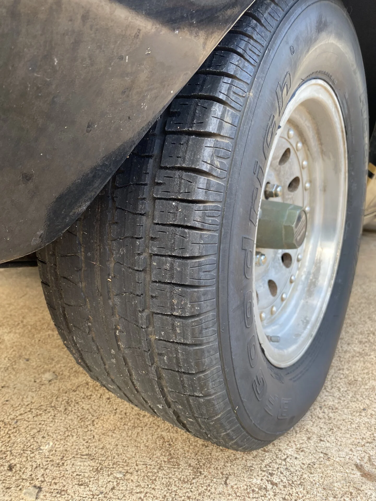

So Son says Do we have a extra tire for the Cobra?
I laugh and know were this going?
New Years Eve Burn outs with his friends ( Hey its a thing out here ) and His Cobra does the best.
Easily the clear winner thanks to the line loc or so the story goes.
No rubber on fender cues we washed the fire works burn marks off New Years Day ( they go a little nutty out hear for fireworks ).
But is that a cord showing?
We had a good look, and down to on the wear bars but OK so swapped em side to side.
Good for another month
Told him get 320$ together gonna have to buy new soon.
Smooth one was drivers side.

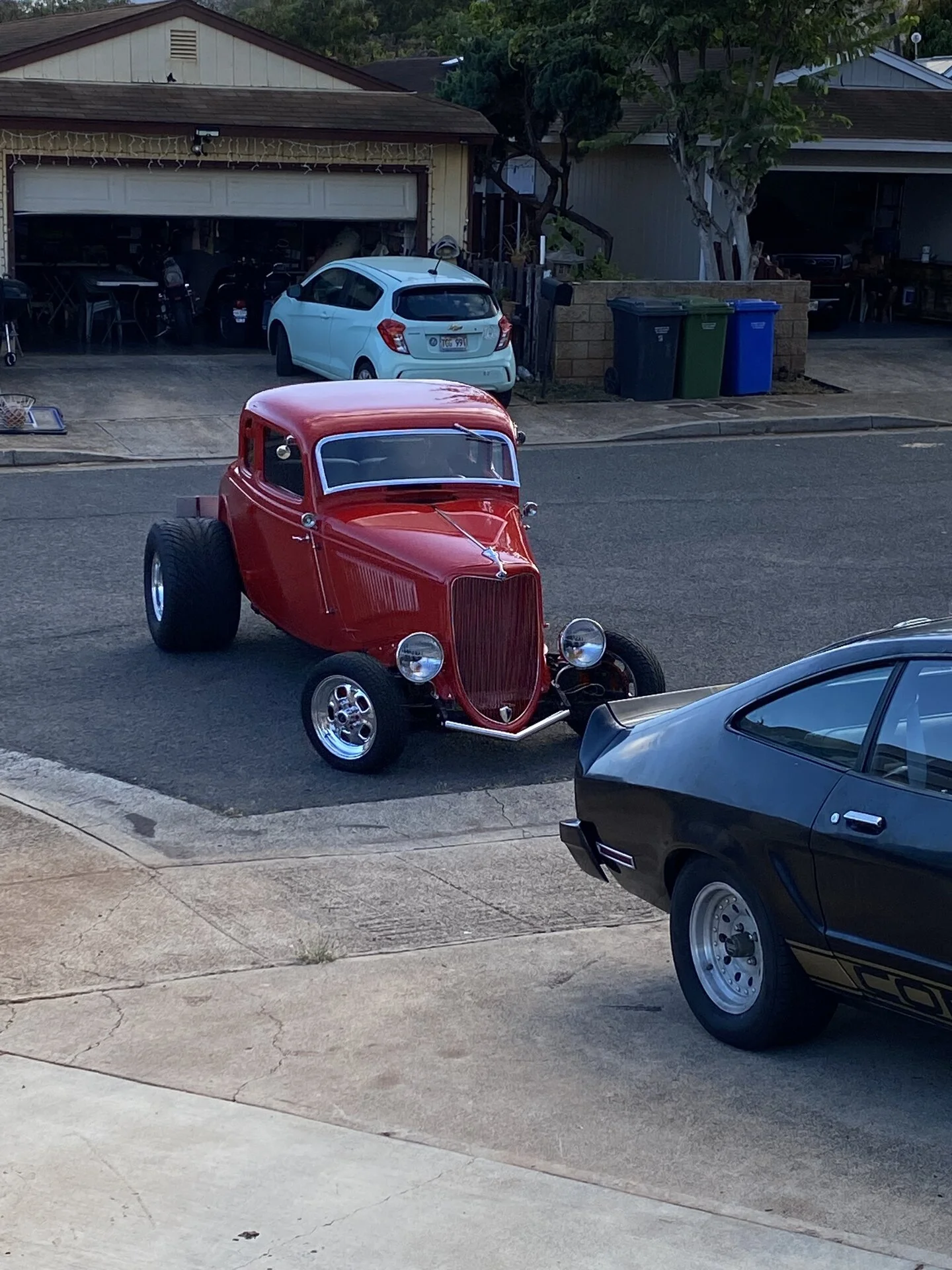

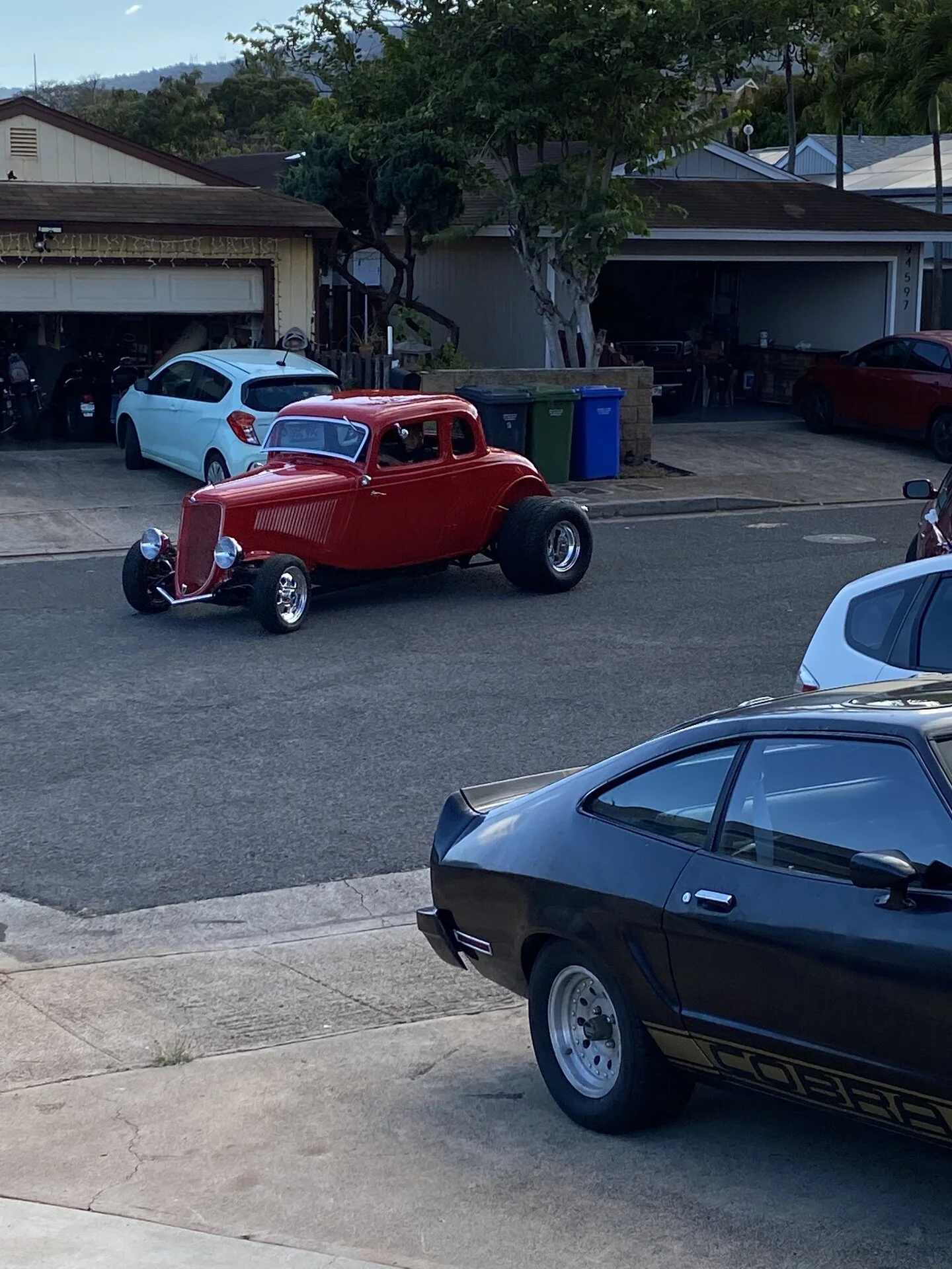

Hot Rod Buddy came by
I digs that ’34!
