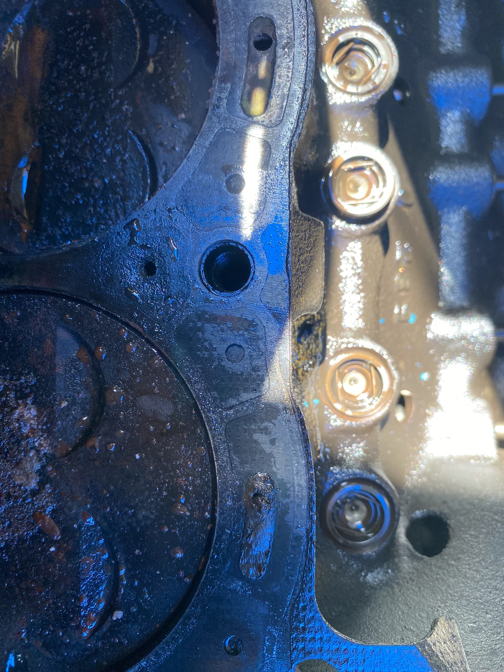

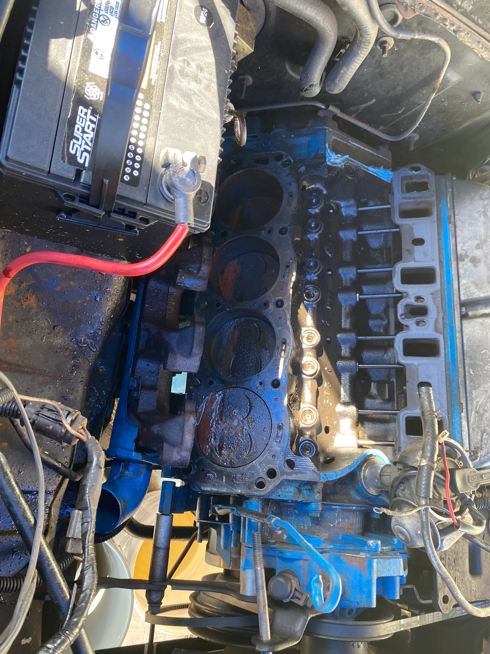

Well all the cylinders look like puddles were present.
Vally looked clean

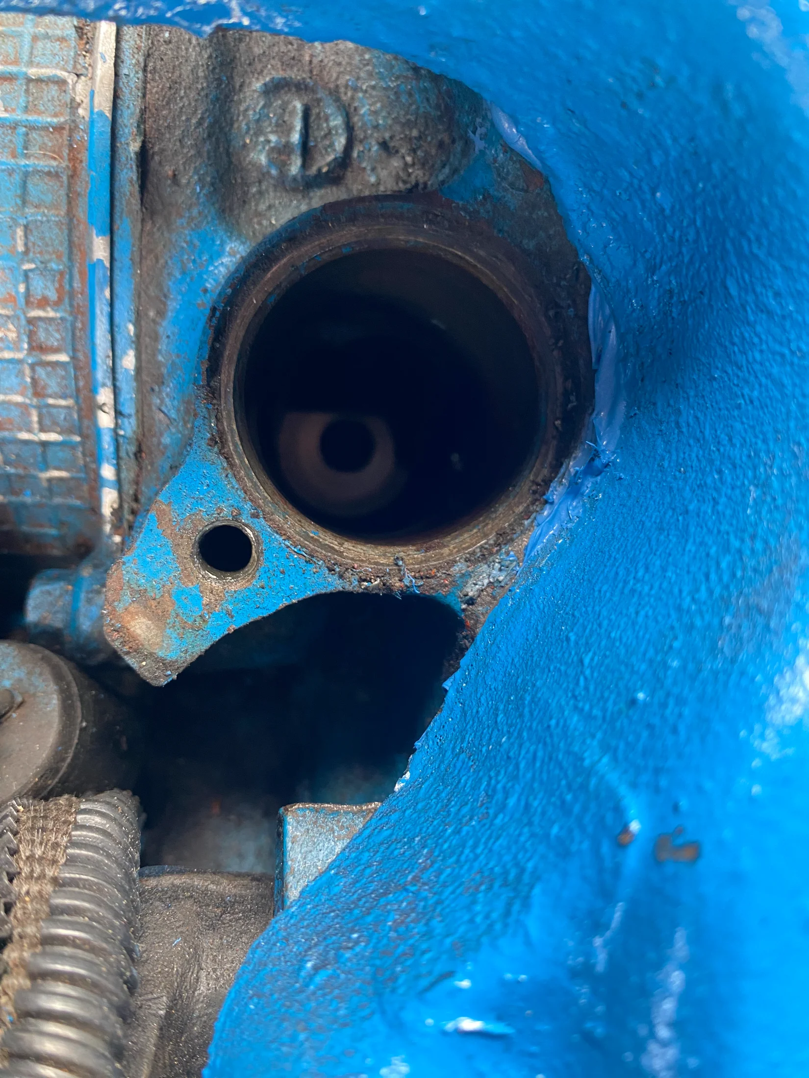

Upper steam hole #1 was plugged with a chunk of rust. By lifter at bottom.
Steam hole by top lifter is open.
Upper Cylinder head bolt between #1 and #2 seemed loose too feeling more like 30 ft lbs than 70.
Wonder if thats the culprit?
Cant find a crack in head or block.

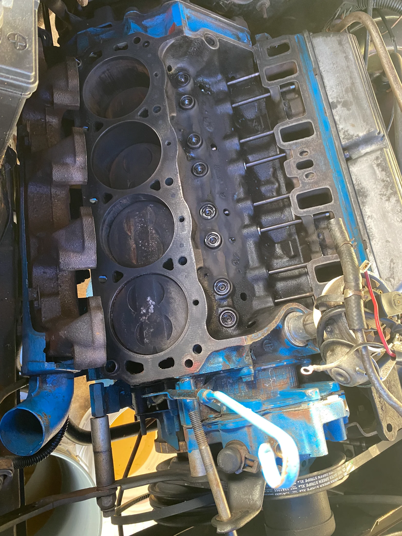

Gonna finish cleaning up this side now.
That 60 year old lifter valley looks pretty good though!
I imagine it got hot tanked at least once when the crank got 10/10
After trying to scrub rust from cylinder walls with oil and paper towels its almost back together.

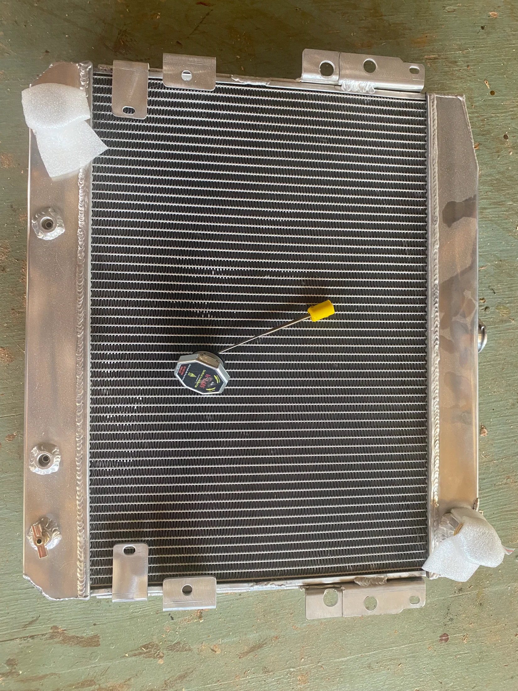

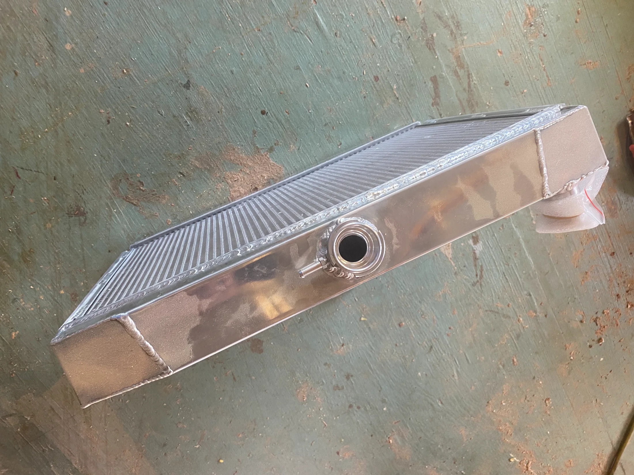

New radiator has arrived.
Got a welded tank. Don't really like that look.
Bought a can of black radiator paint and one of them sacrificial anode radiator caps.
You know it needs both.
Looks like the right brackets are on it. I'll get a better comparison on the swap.

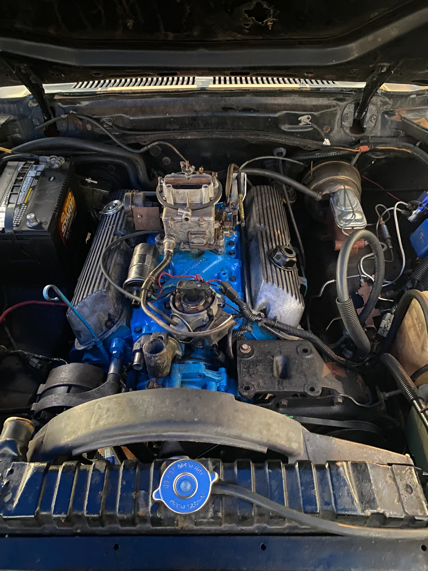

Onto the problem;
Filled old radiator up with water. Car runs good but blows white cloud and pushes fluid out of radiator before getting warm.
New head gasket didn't help. Still putting combustion pressure in cooling system.
Afraid head or block must be cracked/warped... Dang 60 yr old block, was supposed to last forever.
Not sure of next step.
take apart and do dye test?
craig list v8?
Fresh long block from parts store?
Rebuild original number matching block in garage?
Other ideas?
